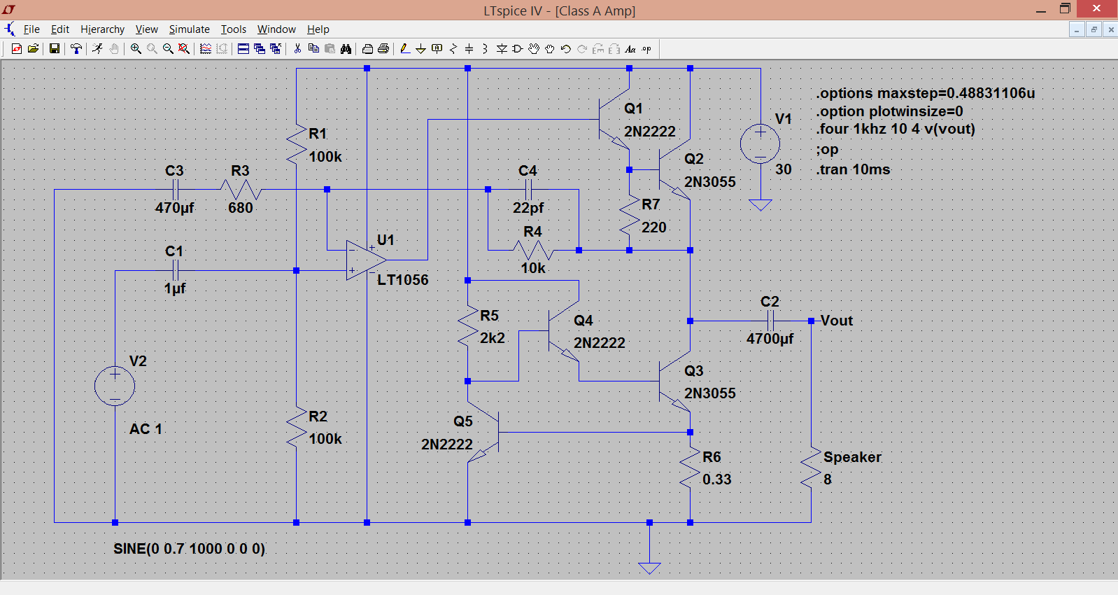

Hello, I am going to build a class a amplifier, and just wanted to know if the schematic I'm using is any good?
I don't want to design the PCB and have a bad schematic.

It needs a bit of work 🙂
How does T4 turn on ?
How does T6 turn on ?
The output stage phase looks wrong too, even if you sorted the above problem out.

No.
Although the schematic does not show the values and type of the components used I's still say this is not a good schematic.
They use an opamp to drive a common emitter power stage (let's suppose/hope that is stable) which should have plenty of gain on its own. But then they add a two transistor pre-amplifier?
And how does the loading of the output darlington work? Current source? Maybe wrongly drawn?
Do not built it, but that's my 2 cents...

Mooly is right too, the darlington lower stage also seems wrongly drawn!
EDIT 2:
The feedback of the preamplifier is a bit undefined as well. Rubbish schematic 🙂

This will simply not work period. Waste of time and money. Plenty of simple yet good designs on this forum.

Finally, if you are going to draw schematics, do try to follow the conventions about traces crossing components. For example, the output of the OpAmp crossing R₈ 'underneath'.
More problems (if you're still interested)
T₁ base connected via R₅ to T₂'s emitter? Seems pointless. R₇ sitting on top of the trace running from C₂ to OA '-' input? And OA '-' input connected directly to emitter of T₄? Others have comment that T₅ & T₄ are not in a darlington configuration. Same for T₇ and T₆.
Since you also have lines-crossing-lines, but without an indication as to whether they are connected or “just crossing don't you know?”, there's no way to tell (given all the other circuit inconsistencies and errors) whether they're intended to be connected, or just passing through.
Finally, there's the observation of others that there's a "preamplifier on an op-amp", which is kind of like putting a firehose onto a squirt-gun. Just doesn't make sense.
Good luck! Read up more!

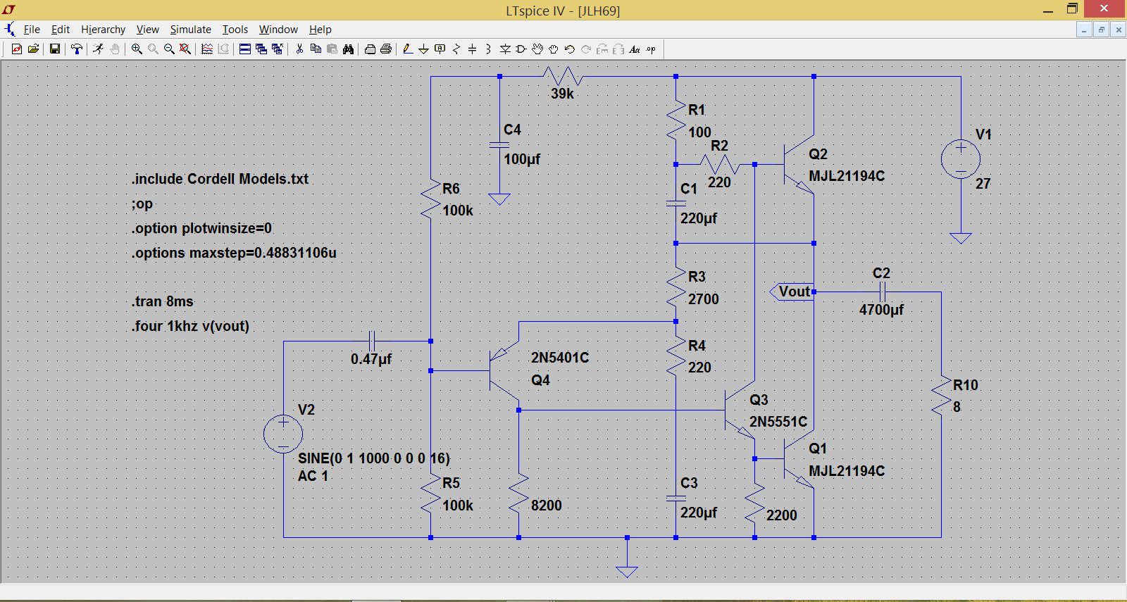

Is this a good jlh69 schematic?

About that JLH10 Amp that KLH2000 fund a schematic over. This circuit is quite original. Tr3 is some sort of phase splitter, but on valve designs the splitter works on voltage. This one works on current. One can say that r100 sets a bias current and Tr3 is some sort of subtraction device. When the upper half gets more current, the lower output half gets proportionally less. It's like an analog flip flop.
The interesting thing is that since the Tr1-Tr3 package really is current driven at high impedance and the ordinary Vbe exponential curve is replaced with the hfe curve.
That may be why many perceive this amp to be tube-like sounding. But some reported a dull midrange though. Perhaps this has to do with the fact that the hfe of the 2N3055 weakens rapidly when current rises.
So this design should be used with modern bipolars such as Sanken. Even Tr3 benefits from a linear hfe.
My old Rotel RB970 - clone had a couple of 2sc1047 I think it was. The had a rather linear hfe up to about 3A.
But I recommend a more up to dete design.
