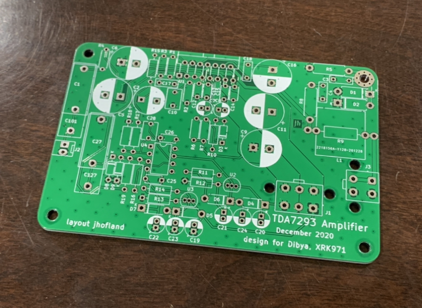

Photo of actual PCB:
911428d1610572719-dibya-tda7293-xmas-amp-jhofland-giveaway-15a22920-6784-4a09-b441-f931b070ca85-jpeg
The amp has been fully tested and verified by Vunce and myself. We have a few minor edits for Jhofland to include in the final layout. The full amp schematics, BOM, and Gerber files are freely available for anyone to make their own boards. But this thread is for those who signed up in the other thread to get a free board for the cost of shipping.

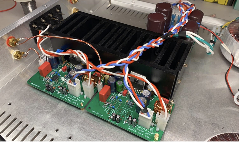

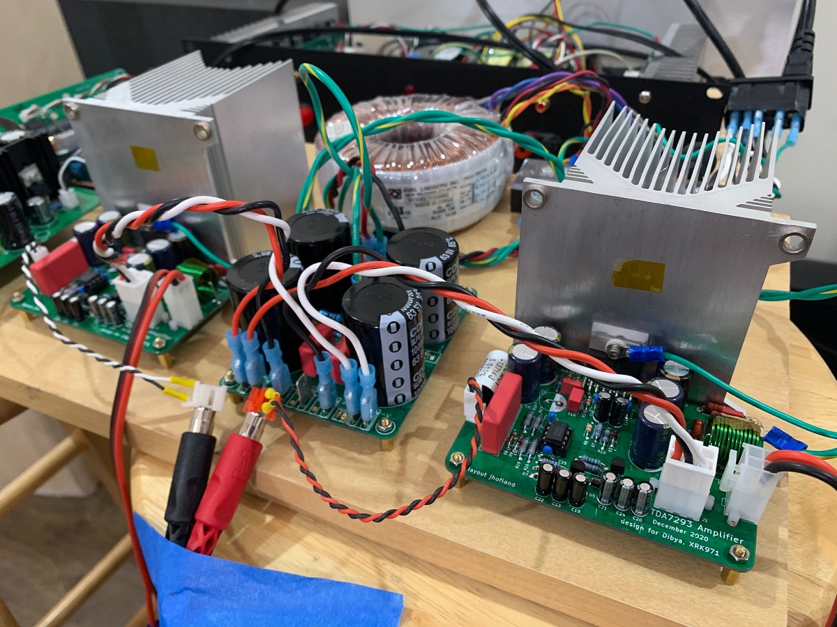

Vunce’s verification build:
908876d1609945042-xmas-amp-dibyas-tda7293-jhofland-274ff2be-939b-4c89-8cbf-a5aa0a4ef367-jpeg

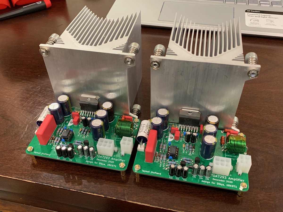

My verification build:
911191d1610526506-xmas-amp-dibyas-tda7293-jhofland-tda7293-nbuild-07-jpg

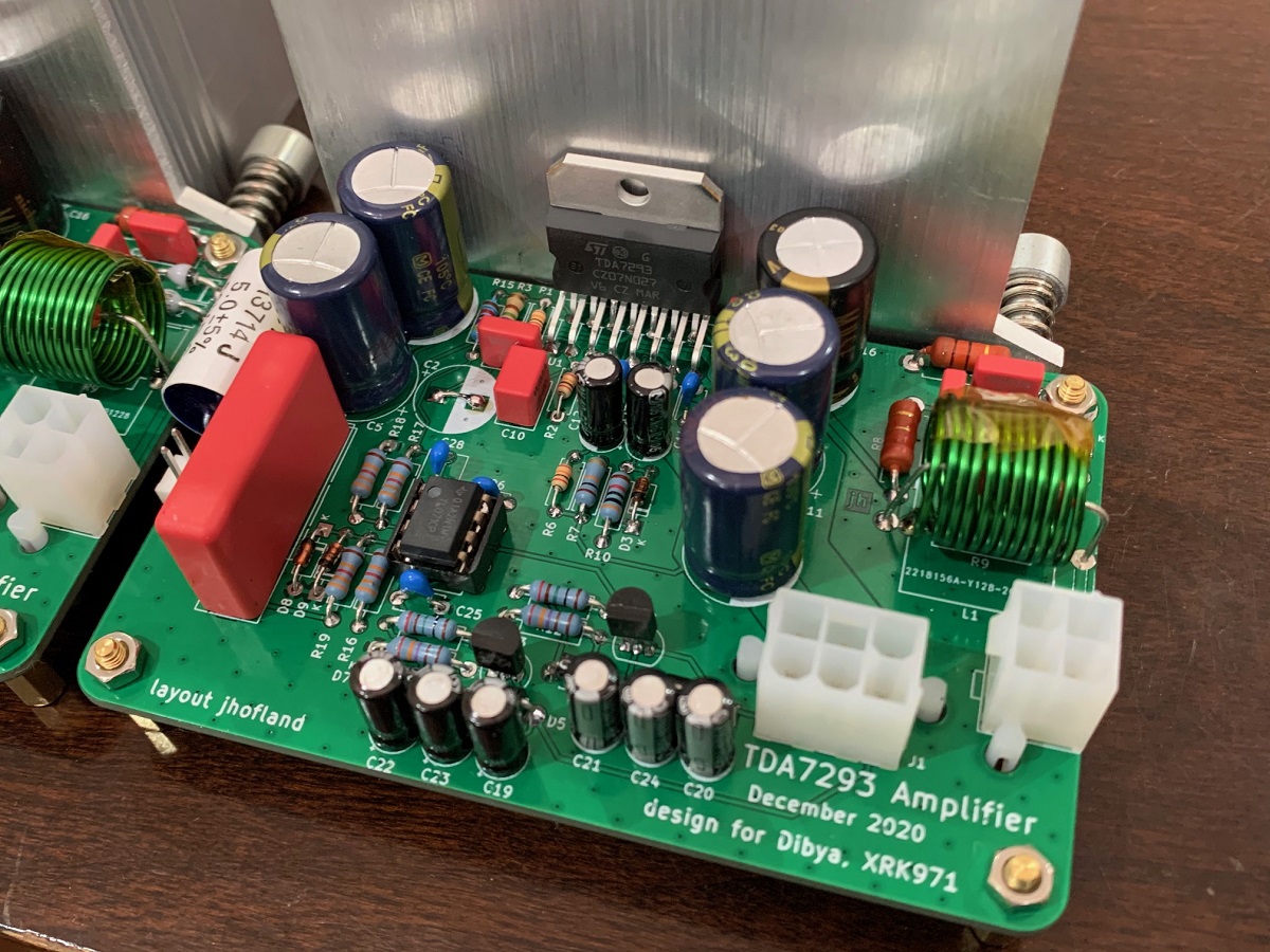

Closeup of the assembled boards:
910860d1610437340-xmas-amp-dibyas-tda7293-jhofland-tda7293-nbuild-01-jpg
910861d1610437340-xmas-amp-dibyas-tda7293-jhofland-tda7293-nbuild-02-jpg

The final layout Gerbers have just been completed and revised schematics abs BOM will be forthcoming. Just addition of 100k resistor to ground to keep the input connector from floating without anything connected. Mounting holes electrically isolated except top right one which has a GLB (ground loop breaker). Larger optional Wima 4.7uF 250v MKP for the input cap. So the board grew 7mm wider.
Here is the final layout with all corrections applied.
1. Isolate the mounting bolt pads from the ground plane, except the top right bolt is connected to the ground via a ground loop breaker (opposed diodes, 10R resistor, and 100nF film cap, all in parallel)
2. Add third set of optional pads for Wima 4.7uF 250v MKP film cap at C1
3. Add 100k resistor to input pin upstream of input coupling cap.
4. Update BOM to show 47k5 resistor for R15 to allow DC servo to work properly.
New and final board layout (107mm x 65mm):
