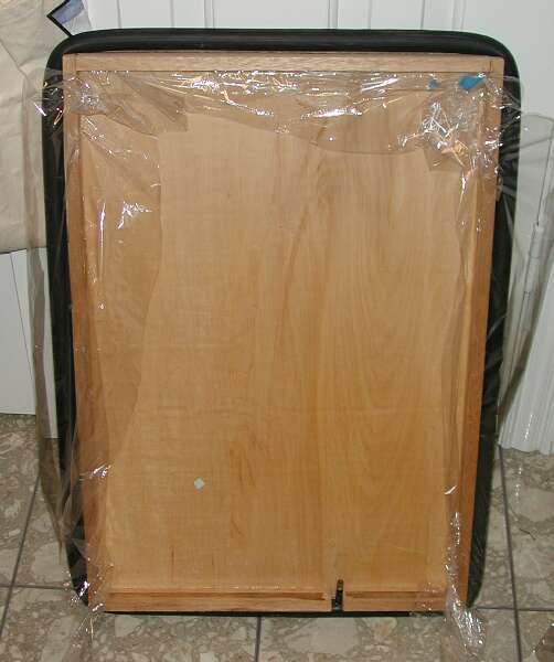

If you monitor the air pressure on the stretcher you get pretty close to the same tension from driver to driver. The best technique I have come up with for using the stretcher table is to lay the film on the surface, and fold one corner under and stick it to the tape. The go to the diagonally opposite corner and do the same, then do the other two corners. Then go to the middle of each side, pull the edge of the film under and attach it to the tape, and work out toward the corners. Just connect your air pump/compressor and pump up the tube. Go slowly- you can easily stretch the film to bursting.
Once the film is stretched, you can set a preglued stator down on top of it. When the glue/tape is set, relieve the pressure in the tube and use a fresh razor blade to cut the film around the edges of the stator.

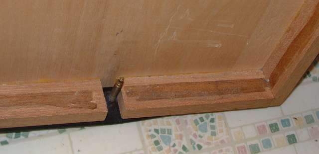

The picture shows the bottom side of the table (the top is pretty boring!). You can see the double stick tape that lines the inside of the rim of the table down near the air valve. The film is stuff I leave attached after mounting a diaphragm. It protects the tape until I need the table again.

The jpeg shows some film hangin off... is that the leftovers??
the idea is that you are taping the film on the bottom side/edge that is visible and *then* with it stretched *over* the outside of the air tube, you pump up the air tube?? How do you get to the tube's valve then??
signed,
slightly confused....
The stuff that's hanging there is left-overs that I leave there to cover the adhesive on the tape until the next time I use the table.
Yes, the film is placed over the tube. The air valve is inside the rim of the table- see the photo. Yes, there is a gap in the tape for the 1/4" slot where the valve fits. It doesn't matter.
The film is taped inside the rim so that it bends three times. The bending greatly increases the holding power of the tape - just like wrapping a rope around a tree and pulling on it. Even if you use weak tape, you'll be able to stretch the diaphragm to bursting. You could try taping the bottom edge of the rim instead of the inside of the rim. When I built the table I went for the inside first- it worked so I never tried the bottom edge.
Bicycle tire tubes can stretch a lot, so if you want to make a big table, it is no problem to use a table with a perimeter that is larger than the tire tube. I don't think it would be a problem to go 2x the tube size. It is also no problem to use a squre or round table. You can use whatever you have around.
You must drill a small hole through the table surface to allow air trapped under the diaphragm to escape. Otherwise when you stretch the film, you'll have a pillow!
Try it once and you'll never want to stretch a diaphragm any other way.
