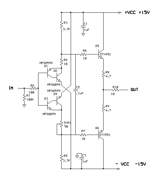

Some years ago I bought from eBay these two diamond buffer kits and now I was thinking in using one of them as a unity gain preamplifier. What I'd like to know is if any of them would suit as a high-quality unity gain preamp and if so, wich one is the best. I see one has a DC servo and the other is simpler. The one with the servo has polyester caps wich perhaps is not good. Maybe put some polypropylen? The one without the servo - is it dangerous to use it dc coupled with the amp?
Would a 100k pot fit any of them as volume control?

I've been experimenting with the DC servo one and seems to blur a little the music. Also, removing the OPA2132 (the servo) the sound seems more detailed and higher in volume. Is this normal?

Thanks, I was suspecting the same thing. I'll google it. Anyway, is the servo mandatory for this kind of circuit?No.

Servo or coupling caps are needed for almost any circuit. One puts caps directly in the signal path. The other puts caps indirectly in the signal path, by putting them in the feedback path. You choose.
Can't I avoid both with carefully matched transistors? I was hoping to go capless and servoless but I can't, right?
I can thermal couple the transistors with some thermal glue but I don't know if this is good enough. I think this is what is been done with the Mezmerize buffer, at least I think they don't use a servo.Can you ensure no thermal gradients too?
I just changed the 0.2uF polyester caps of the servo with one 0.1uF MKP1837. The RC constant was about 0.03 and now is 0.016 Hz. I don't know if is the polypropylen or the RC constant, but the sound improved. It's not as transparent as I hopped for but it's some improvement. Anyway, the volume goes down with the OPA in place. No servo, the volume is a lot higher. Could this be an opamp issue? - I'm using OPA2132 not the OPA2134 from the BOM I have. Could I ask someone with more knowledge than I to check the servo design for me, please?

The Servo and the Servo's Time Constant should not change the volume (output signal level).
If 0.2uF is 0.03Hz then 0.1uF is 0.06Hz, not 0.016Hz

I think 0.03 and 0.016 are time constants in seconds, not frequencies in Hz. If this is the dominant pole in the servo, then it is a bit close to the LF end of the audio band so you are likely to get a lumpy bass response. You might interpret this as an improvement, especially if you like reggae or organ pedal music.

That's what's bothering me. Somehow the servo is loading the buffer and lowering the output signal. I read the OPA2132 and 2134 datasheets to see if I'd spot some significant difference that justified the loading but they seem almost identical.The Servo and the Servo's Time Constant should not change the volume (output signal level).

I believe the time constant is R*C, that is 0.2 for 200nF and 0.1 for 100nF (C is in microfarad and R is 1 Mohm). I did R*C/2*PI and I got 0.0318 and 0.0159 Hz respectively. This was the way I calculated.I think 0.03 and 0.016 are time constants in seconds, not frequencies in Hz.
I would split R13 in two and put a servo there in the midle. I call that a bias servo. That is even more "indirect" in the signal path. It also avoids a cap at the input.

Some points for your understanding
- The buffer circuit with the servo will have low offset in the
millivolt range or less even with the IC disengaged. There
is no need for a servo here.
- It will have no DC gain because of the input coupling cap.
This cap can be taken away if the source is free of DC.
Most sources will have an output cap anyway.
- The servo does not load the buffer circuit. It loads the input
source with 4k7 ohms via R9. With the servo disconnected
you have over 100 kohms at the input. This is the reason for
the noticed volume difference and may be the reason for a
sound difference. The input source apparently has high
internal impedance.
- The volume difference you noticed is not an issue of the
type of opamp for the reason above. R9 may be increased
for a reduction of this effect.

Let me see if I fully understand: With the servo connected because the output of the opamp has very low resistance (idealy zero) the input sees only 4.7K (4.7k // 100k) to ground of input impedance. Without the servo, R7 defines the input impedance. Because I'm using a 100k input potenciometer, impedance is matched better by R7 alone. Is my reasoning good?
If I want to use the 100k pot at the input (for volume control) can I increase R9 to 200K so paralleled with R7 I get 100k matching the pot? What about the servo, it's functioning wouldn't be afected by doing this?
Another question: What's the purpose of R11 and C26? Is it a low pass filter for the opamp?
Yes.
I have got conflicting answers about this... Would thermal drift be an issue?
No.
R11, C26 is a low pass before the buffer.
This combination works only if the servo is engaged. C26 should be connected to ground as ususal.
Try to exchange R9 and R7 if you insist on a servo.
