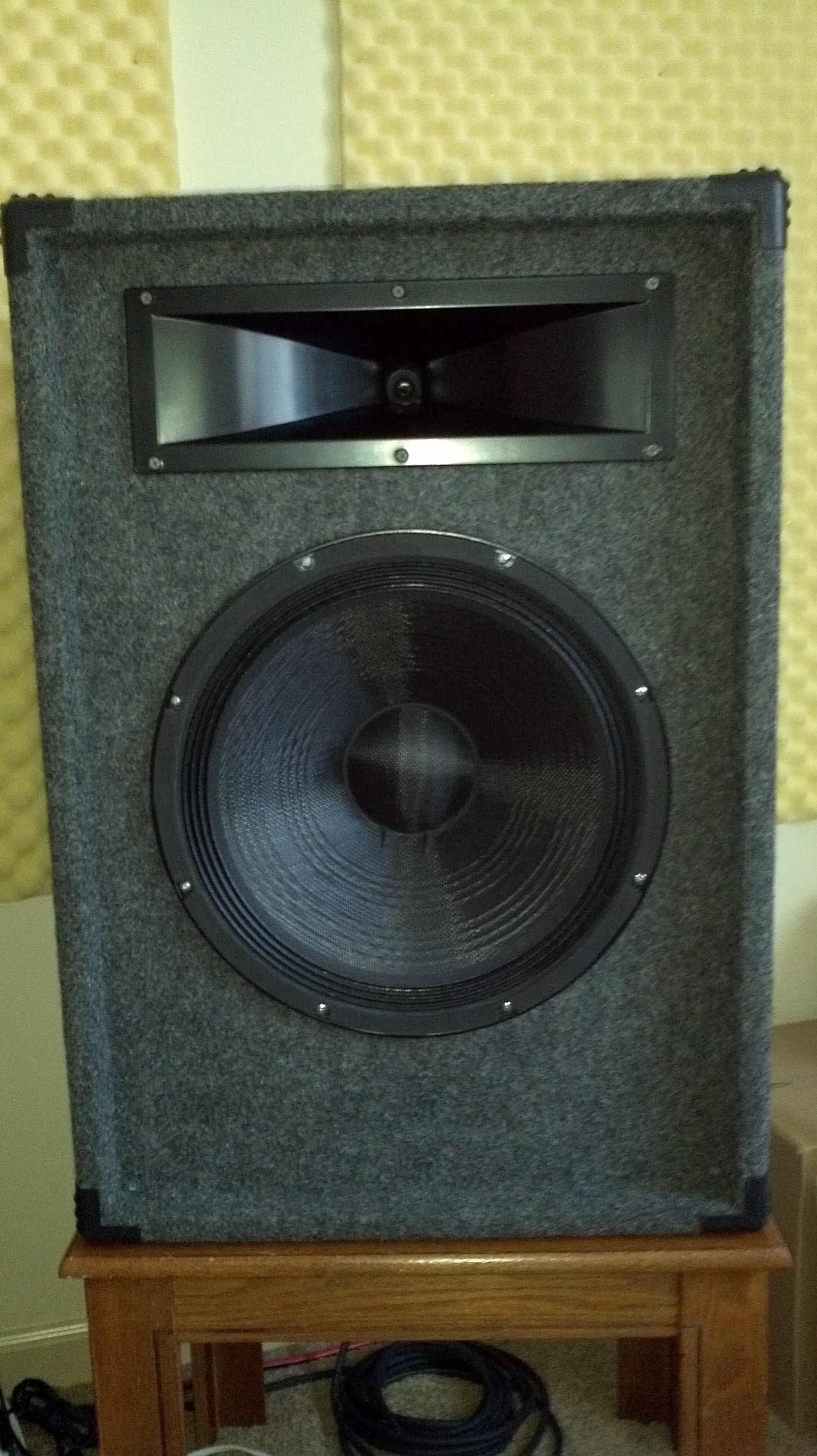

I'm having this very odd issue with some speakers I built. They are a high efficiency two way design consisting of a Selenium WPU1507 woofer and a Selenium DT220I horn driver on a rectangular wave guide in vented cabinets. The crossover point is set at roughly 2.5k with 2nd order LR filters. Tuning frequency of the enclosure is 40hz.
The issue I'm having is I'm getting a buzzing type of distortion from the woofer itself at frequencies near and in between the two resonance peaks. The level of distortion gets worse as you increase the input level and remains proportional to the overall output level of the audio signal I'm driving it with. It sort of sounds like the voice coil is rubbing, but the woofer itself is mechanically ok without any hint of mechanical coil rubbing when pushing on the cone by hand straight and even at any angle of the cone. I also tried pushing on all areas of the surround, spider and as well as checking the coil input leads for vibration. I did this at the back side of the woofer too by sticking my hand through one of the ports. I bypassed the crossover completely with no change. The cabinet has absolutely no air leaks anywhere (except through the ports). I tried different amplifiers and test signal sources as well as music. When I pull the woofer out and test it free air, it doesn't do this. The distortion is coming directly from the woofer cone. The other speaker (woofer) exhibits the exact same symptoms. I checked the impedance curve of the woofer in the cabinet and saw no sharp little peaks or resonances aside from the two basic resonances around the enclosure tuning. Outside of the box tuning resonance area it plays very clean. I just don't get it!
I'm starting to think this has something to do with the motor design of the woofer, specifically regarding some sort of electrical non linearity caused by fluctuating coil inductance. I don't have another lf driver to try and honestly I wanted to stick with these woofers because they sound so clean and open in the midrange with their fiberglass cone. They transition very well to the hf drivers, not to mention they play fairly low with nice lf detail. It's just this distortion that's annoying and for the life of me I can't figure out the cause.
Anyone have any suggestions?

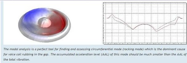

Wonder if your woofer is going into "Rocking Mode"?

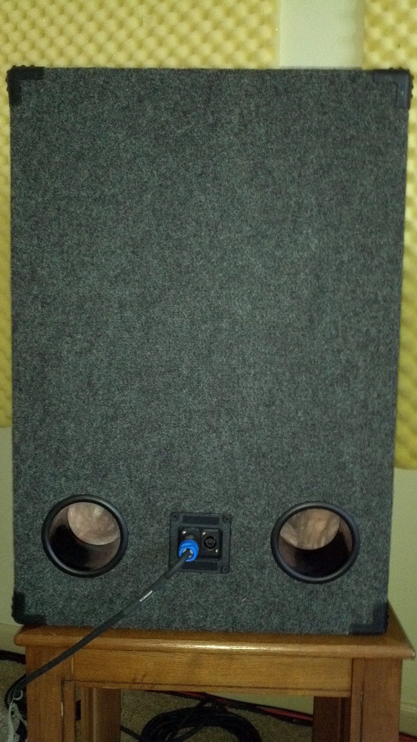

Might be aggravated by a very unsymettrical placement of ports and speaker:
Vibration analysis
A cabinet photo would help.

Thanks for all the replies. All very valid points. I'll try and address each...
system7 - The ports are in the lower rear of the cabinet. 2 x 4" diameter, 5" length (see photos).
pinkmouse - Surrounds and spider(s) are ok. The problem is identical with both speakers, even running the woofers directly with the crossovers bypassed and trying another amplifier.

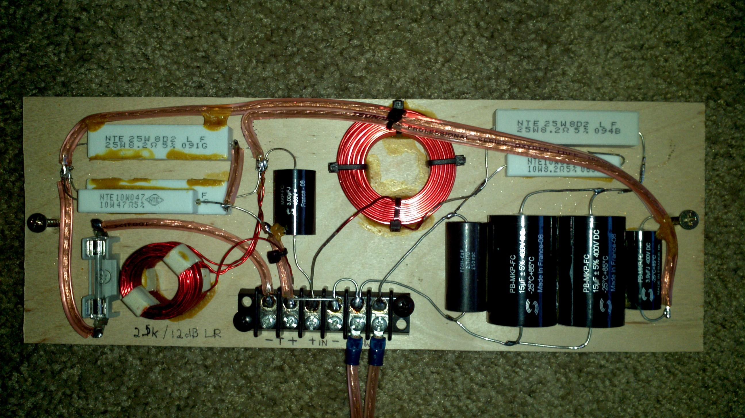

From what can be seen from the xover photo,there appears to be an 8.2 Ohm/10 W resistor in series with the bass driver. Also the value of the // capacitor appears incorrect.For a 12 dB/octave (L.R.) 8 Ohm, 2.5 kHz filter the value should be 4mFd and the inductor,1mH.

The smaller 8.2R resistor was for the previous woofer zobel, which I thought was a little too small and have since put in an equal value 25w resistor with the larger value caps (8.2R in series with 2x15uf as sort of a zobel) to linearize the acoustic lowpass slope response. This makes the impedance dip a tiny bit under 6 ohms, but really helps with baffle step compensation. I didn't bother pulling off the smaller 8.2R resistor - it's only connected on one end. The 2.7uf "tech cap" is the actual parallel cap (C1) of the lowpass with L1 being 1 mH. The smaller 3.9uf cap on the right is paralleled with R1 of the horn l-pad to help extend the top end response of the horn driver a bit.
