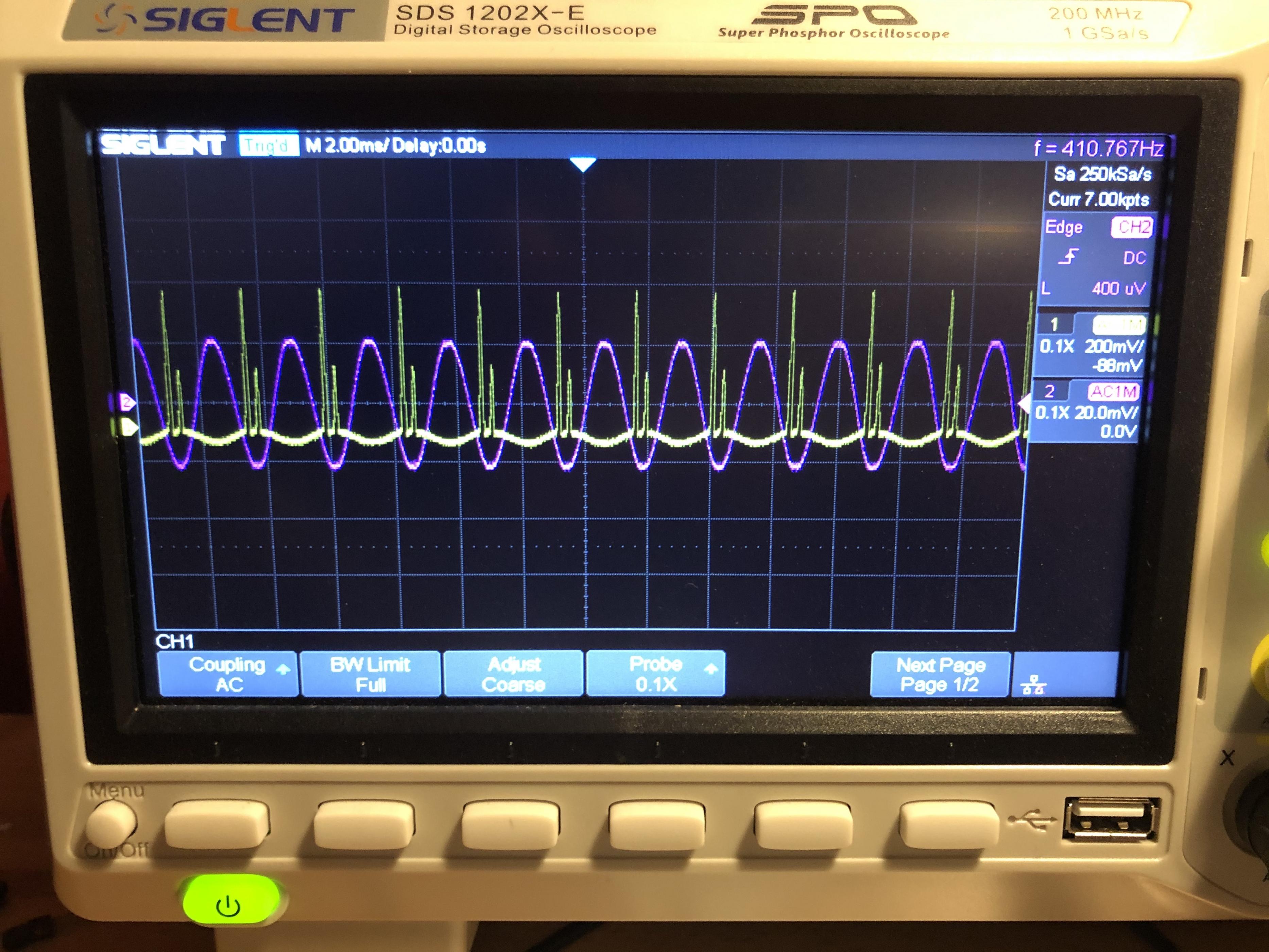

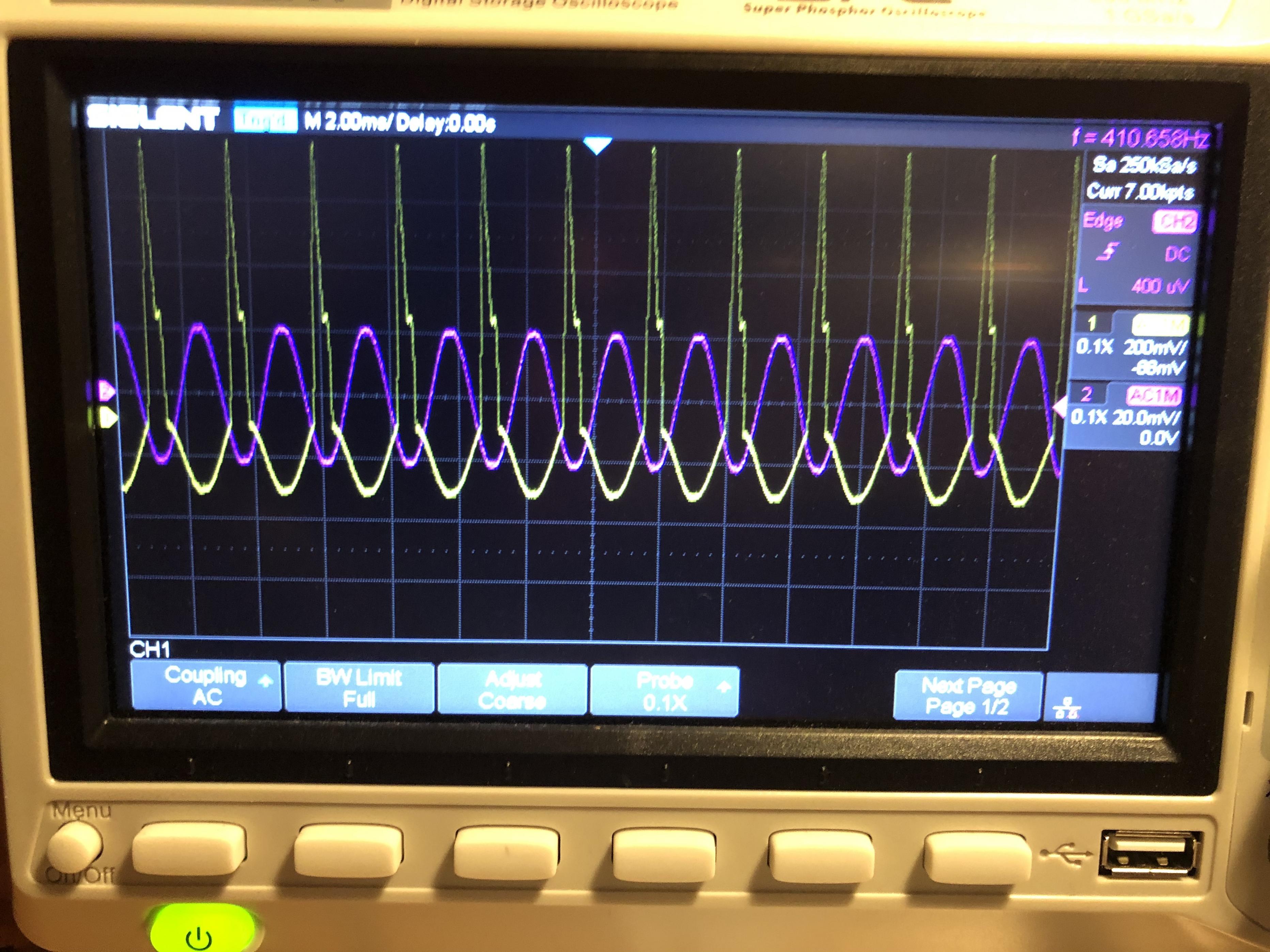

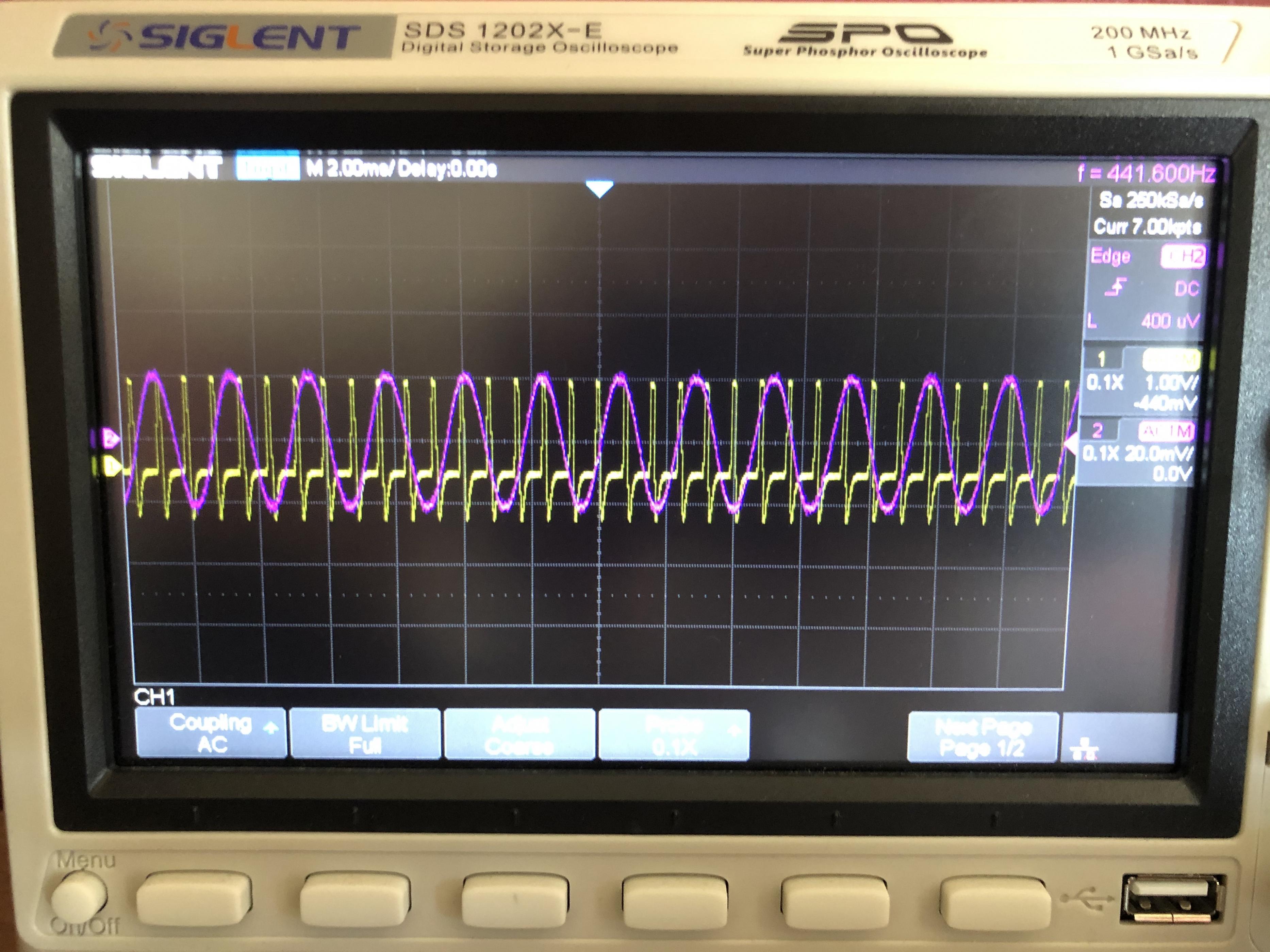

Okay, I added the Zobel and Q3 BE resistor. No major improvement in the sound. Reading about why they're used was educational, though.
Here's what I'm seeing on the scope. Purple probe is at the input, yellow is at the output side of C5. So you don't have to squint: input scale is 20mv/div, output is 200mv/div, frequency is (a little lower than I was aiming for) ~410hz.
First, with the volume low:
And with the volume near full:
Looking at it now, it seems clear the noise is on the upper part of the output waveform, which makes me wonder if something might be going wrong with/near Q4.

Ok, I suppose you are testing this without a load, as asked to.Okay, I added the Zobel and Q3 BE resistor. No major improvement in the sound. Reading about why they're used was educational, though.
Output waveform with good signal injected and volume up is *impossible* so there is some gross wiring error involved.
1) confirm signal injected at input jacks (any of them), is it shown as some 41mVpp so actual 410mVpp because of the 0.1X probe?

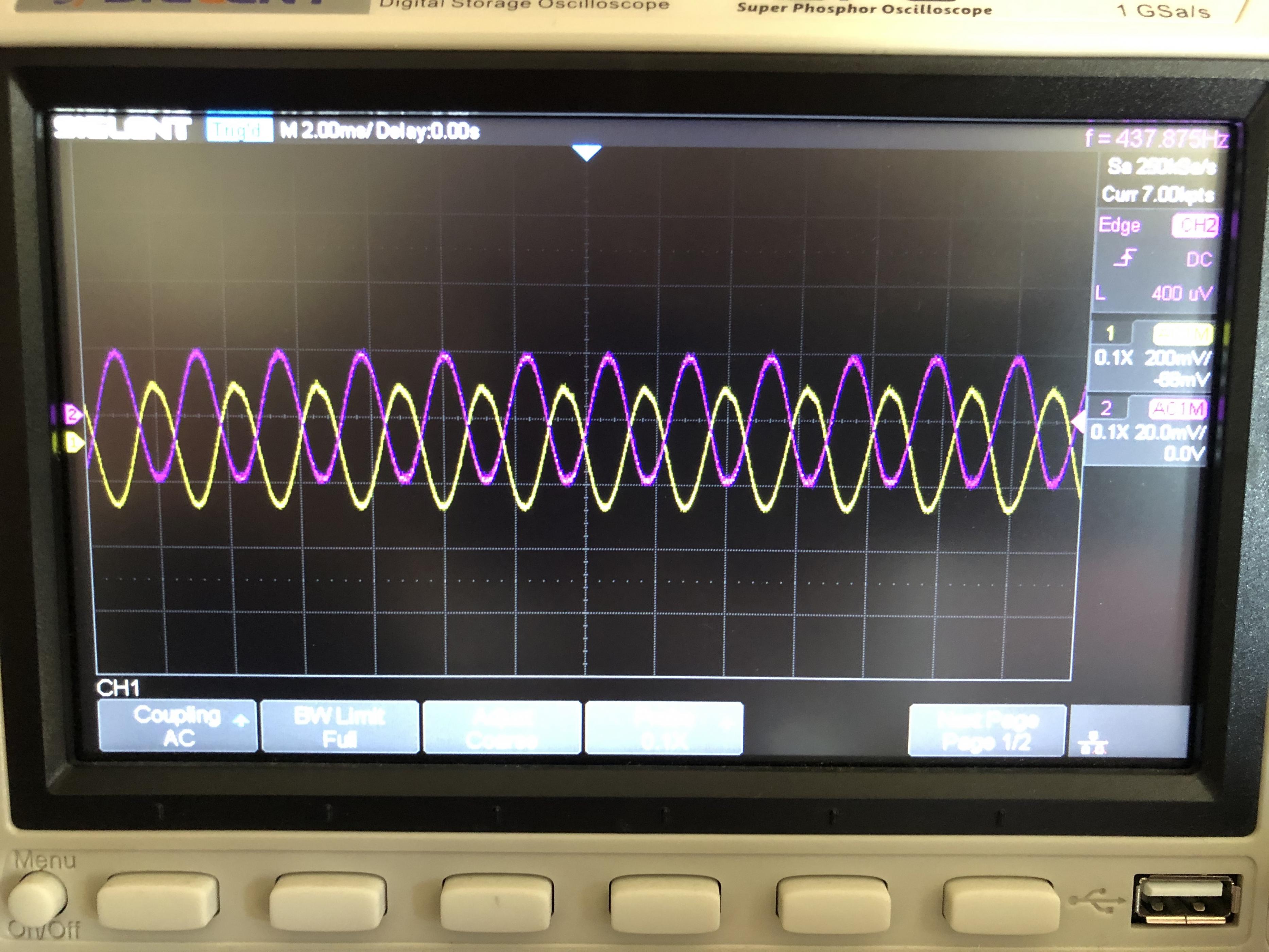

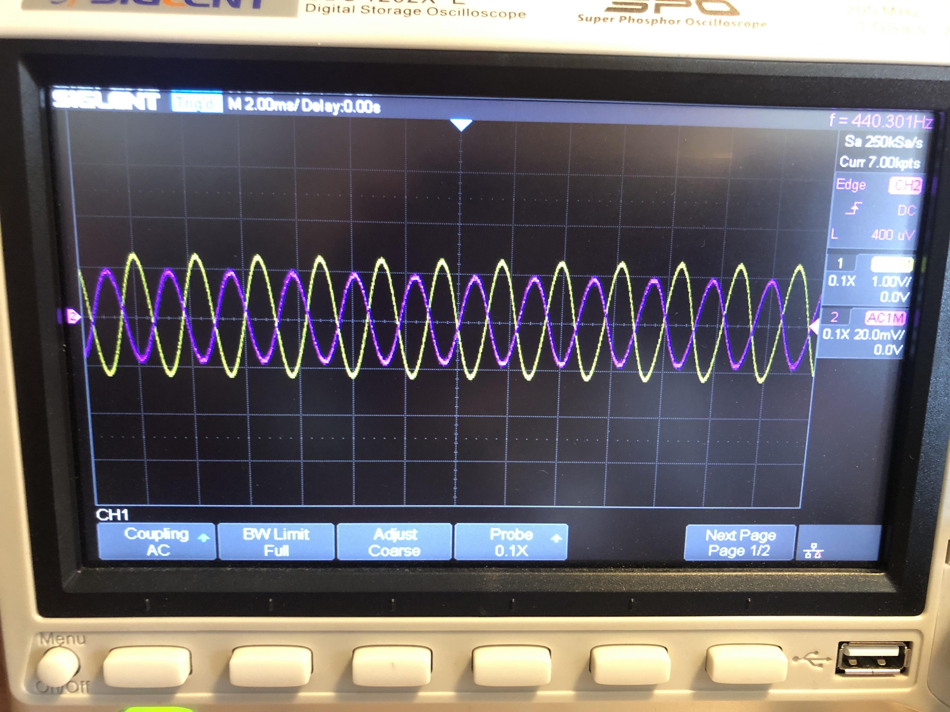

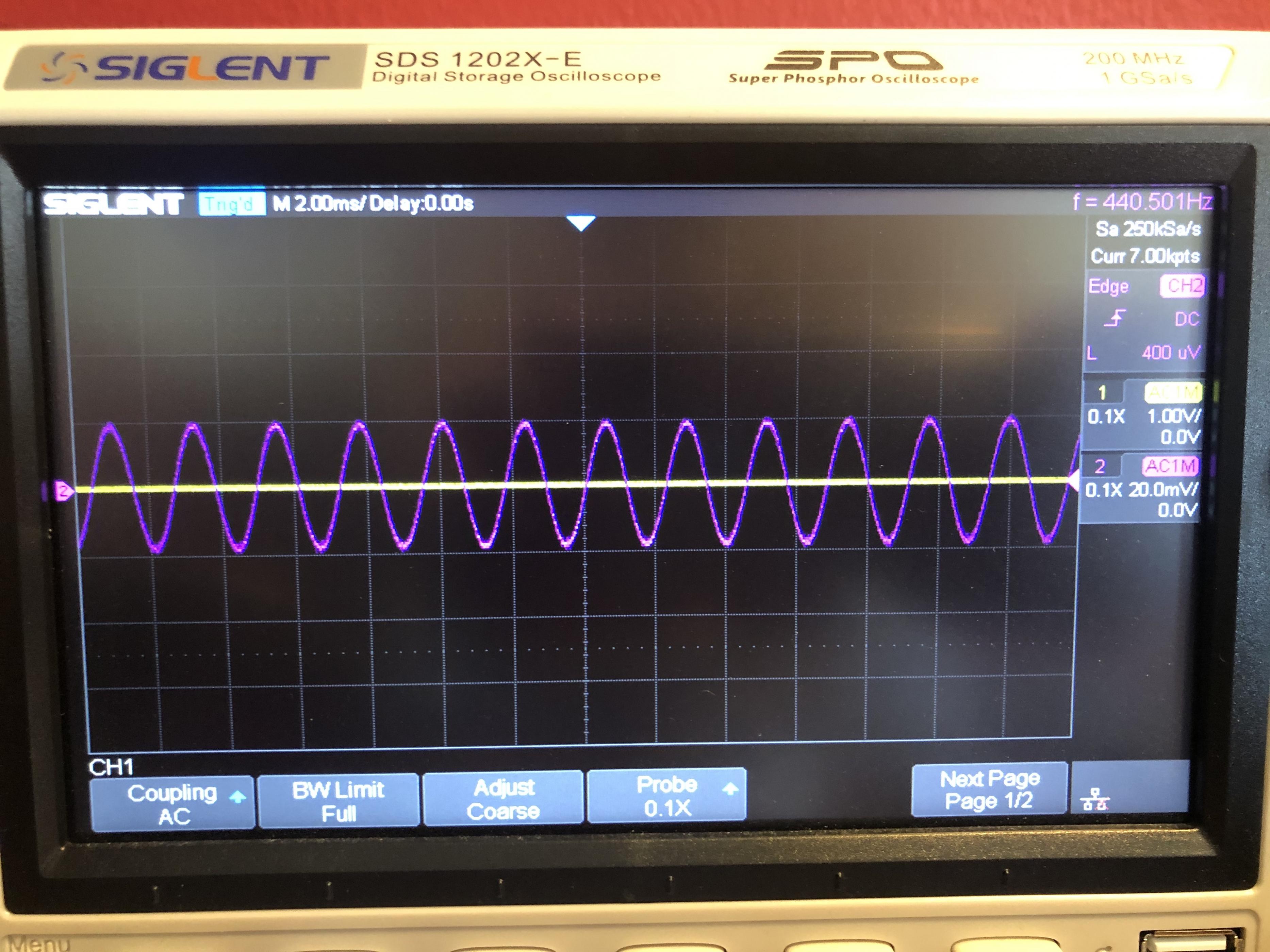

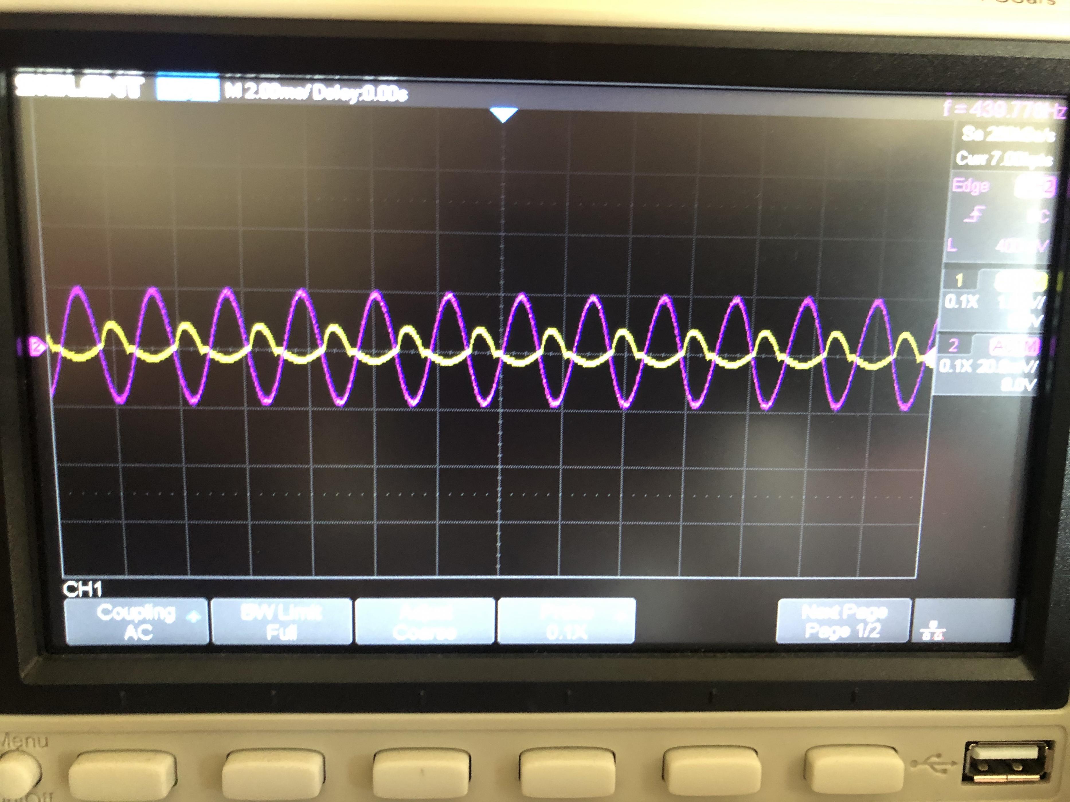

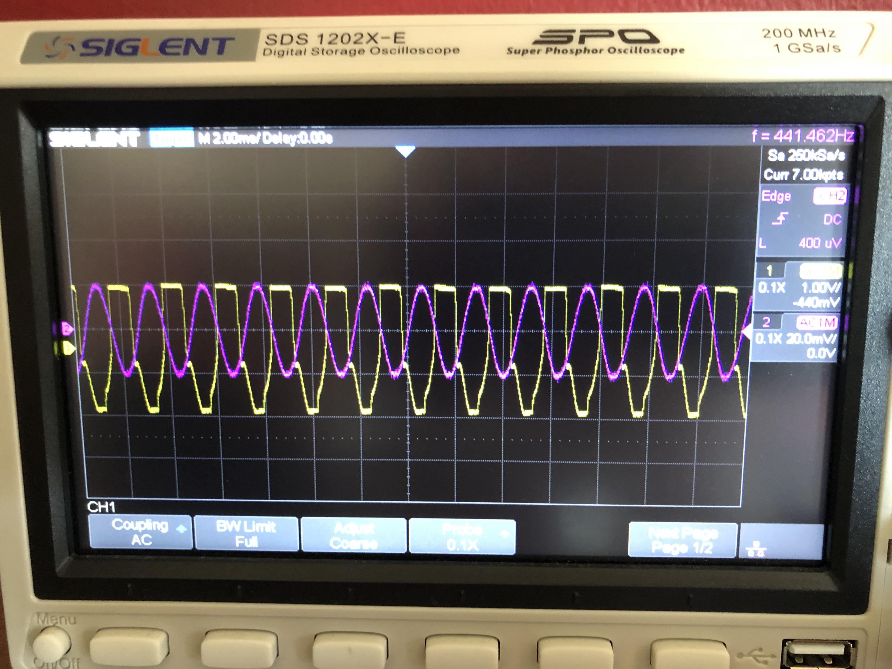

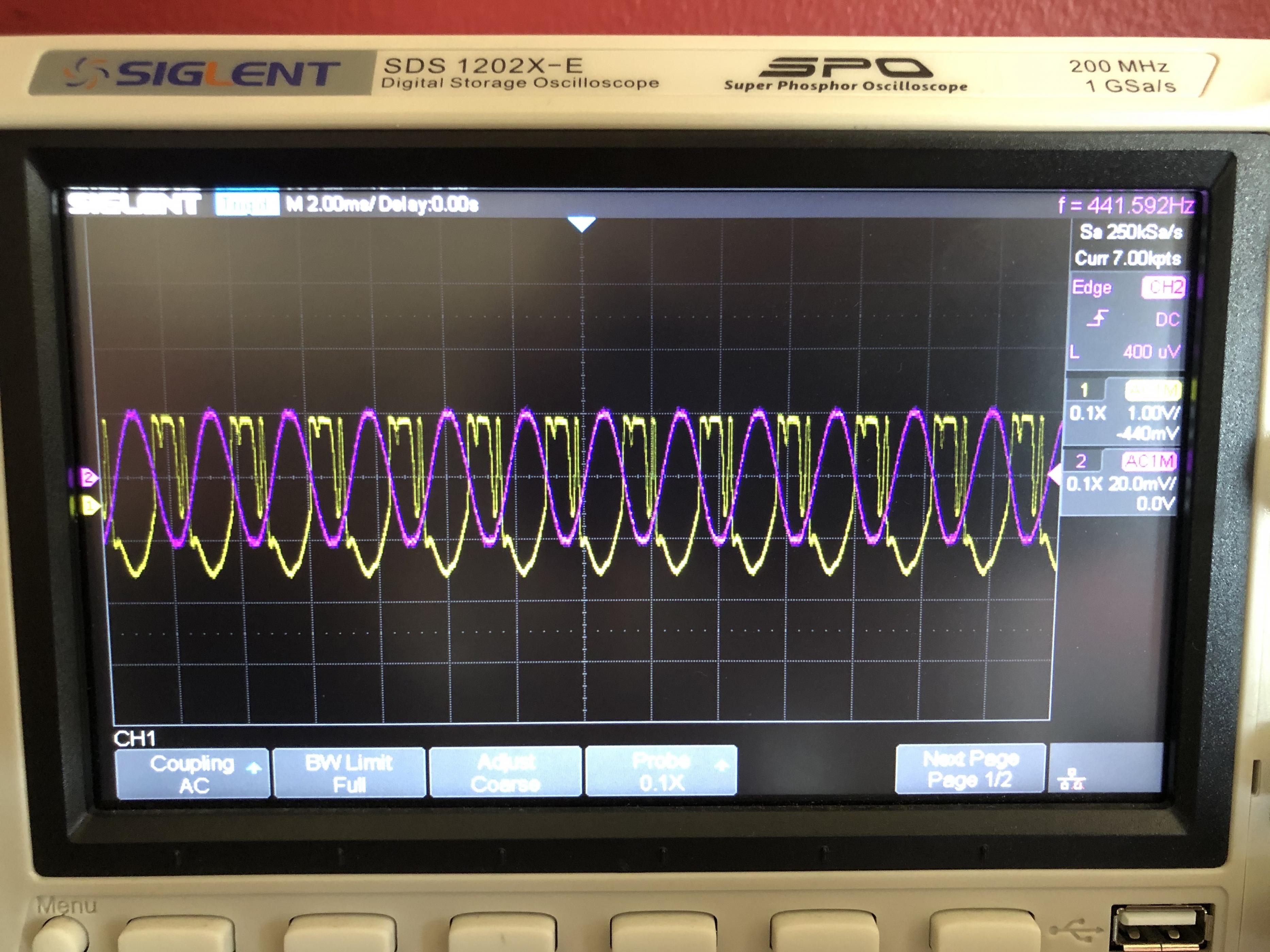

Okay, first let's clear up some potential confusion. I should have specified: the results I posted were with an 8R load — I see now that you'd asked for both.
And, in answer to your question #1, the input signal was about 40mVpp, probe is 1X. 410hz was the frequency of the signal.
Here are results with no load (meaning, no speaker or dummy load connected — I suppose R18 and the Zobel are acting as a load...). Note that while input scale remains 20mV/div, output scale is now 1V/div.
With volume at zero, there's some noise:
Here's volume around mid-way, so you can see how clipping begins:
And here's max volume:
I'll work on getting the other measurements as I have time today.

Set volume to 10/Max
Lift left end of C3, the one touching Q1 Collector
Scope Q1 collector signal
Post screen capture.
This one is quick and easy. Signal looks pretty nice at max vol on Q1 collector with C3 lifted (note output scale is 200mv/div — and oops, I lazily didn't zero the vertical offset):
Ok, so far so good.
Q1 is showing about 10X gain and "almost" perfect sinewave although some clipping is starting to appear on top.
I have a doubt on your scope scale: both to the left of "20.0mV - 200 mV - 1.00 V" scale indications , it shows "0.1X"
WHY?
I thought it meant you were using a 0.1X probe, hence my estimation of 410mVpp input signal.
I am NOT talking frequency.
Is that so?
or: do you have a 0.1X attenuator engaged?
I want to be CERTAIN about scope scale, so far I am not.
At bottom it says: "probe 0.1X"
Please explain that.
That would modify readings by a factor of 10; unless we have that clear , measurements are MEANINGLESS.
WHY?
Is that so?
Okay, some progress! You were right JMF, there was a bad connection somewhere. While trying to take additional measurements, I noticed a drastic change when I jiggled something. After reflowing every solder joint that looked even a little bit suspicious and doing a little percussive testing to make sure I got it, results measured at output (C5 pos) with no load (other than R18 & the Zobel) look very much better.
Min vol:
Max vol:
Testing with a load, the output looks quite different (this is with a speaker connected, and volume at maybe 3 or 4 — a dummy load looks somewhat similar):
And unfortunately, plugging a guitar in, I'm still hearing pretty much the same distortion as always. So, very bad behavior during measurement is resolved, but the primary issue remains.
Min vol:
Max vol:
