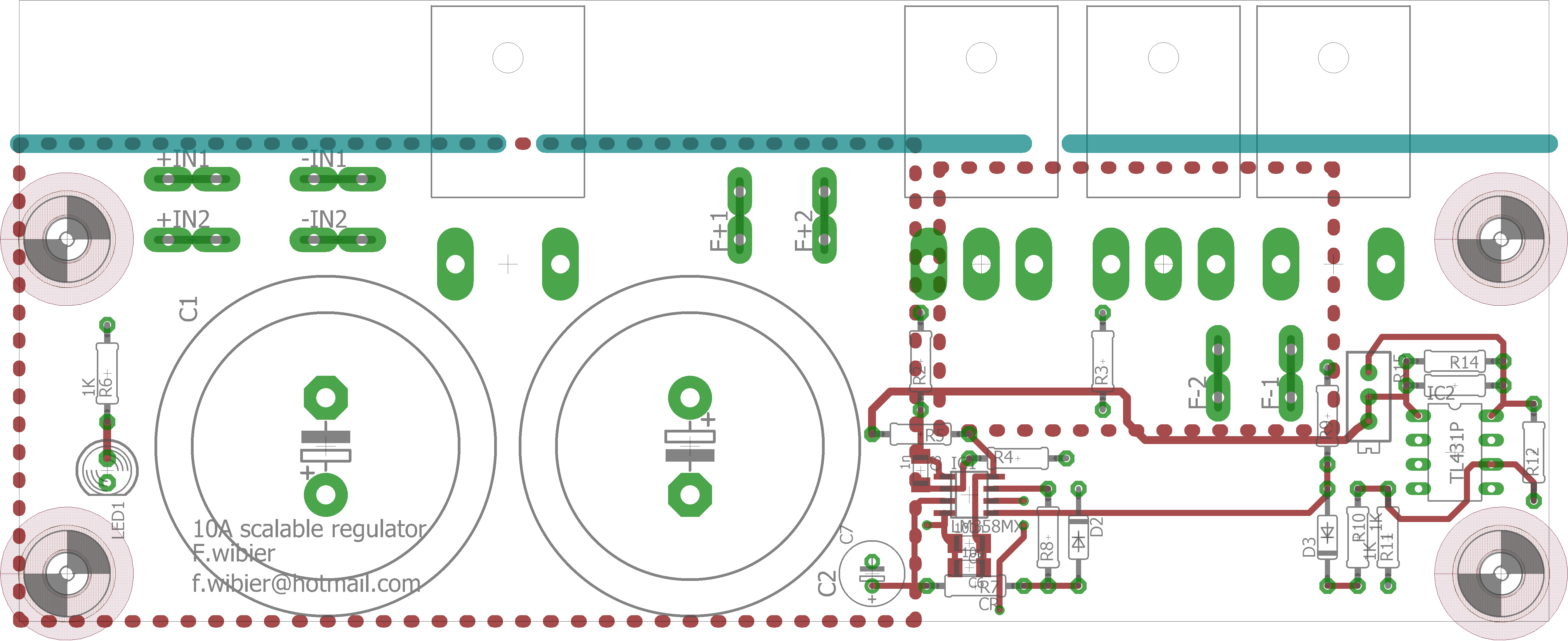

I have designed a regulator for high current directly heated tubes, tubes like the 211/845 on the low end of the current scale and 833 (10V 10A) on the high end of the current scale.
I want to start my own company, and this is perhaps one of the last times you can get this kind of product from me at hobby prices.
The module functions as a automatically adjusted current source, and has voltage control for low frequency, and behaves as a current source for high frequency.
I currently have eight boards left that aren't allready spoken for out of a total PCB order of 20 boards.
The boards measure 50x160mm and are 1.6mm thick green FR4 epoxy with ENIG-ROHS gold plated pads and 2Oz copper. There is a strip approximately 15mm wide along the length of the board that can be used to mark out the mounting holes of the TO-247 Devices.
Everything needed for the supply except for the bridge rectifier and optional secondary fuse is included on the board. It takes the output of the bridge rectifier and or LT4320 based ideal bridge and stores the charge in the two on board 22000uF capacitors.
The modules are adjustable in its maximum current output by means of swapping out the TO-247 current sense resistor for a different value.

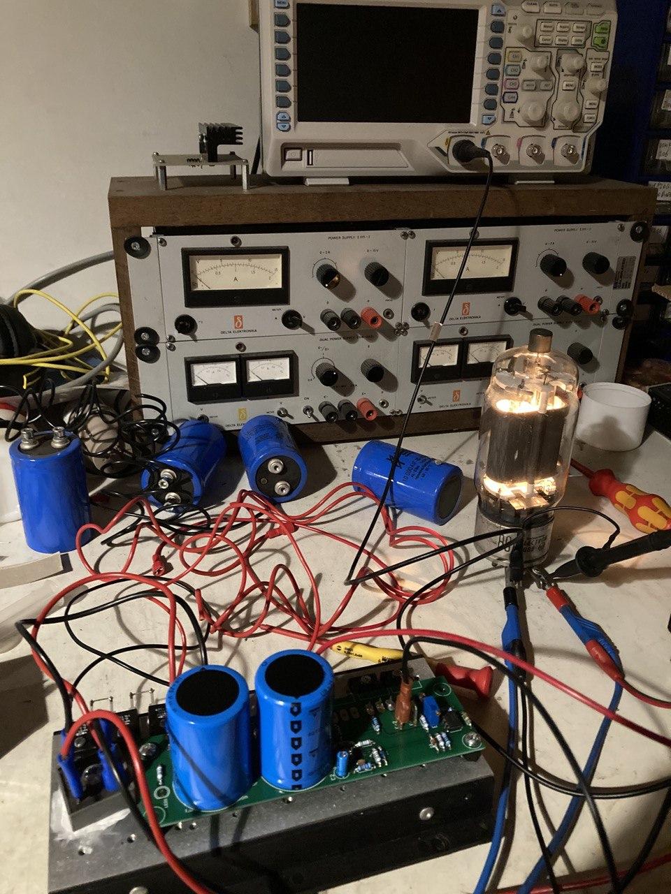

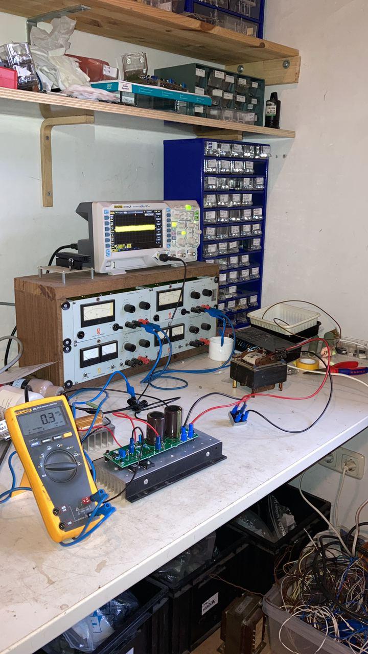

Some pictures, it seems to work ok

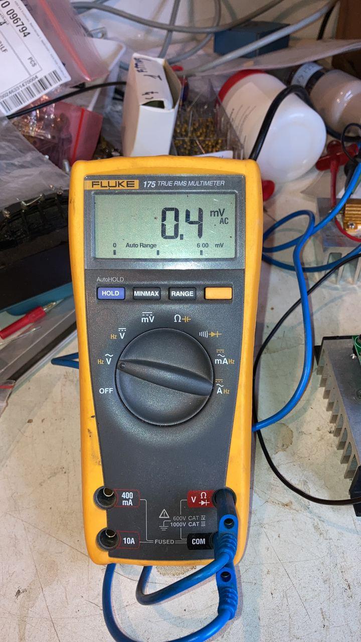

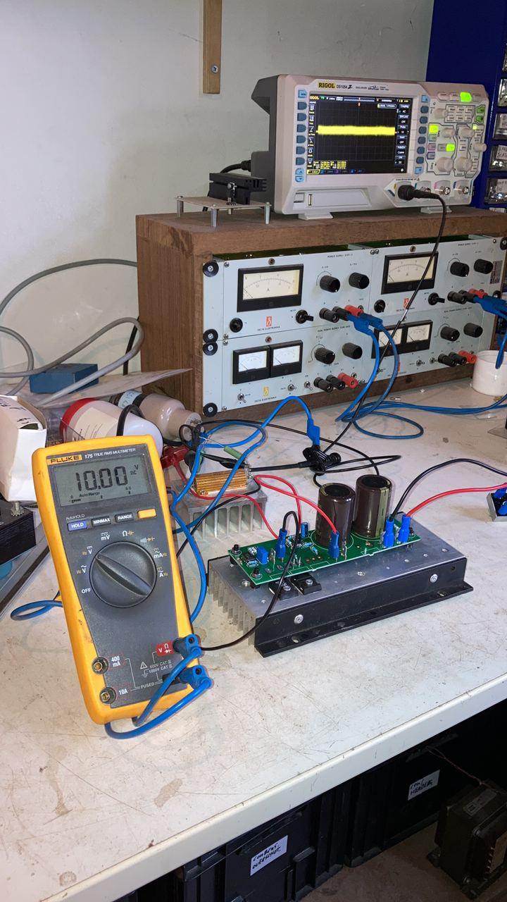

Here are some pics, i got the boards in yesterday, and found the time to build one into a unit on a test heatsink.
This one is trimmed to 10.0V on a 3.0R load for a load current of about 3A, or the equivalent of a 211
with a 12VAC transformer input, i'm measuring the noise unshielded with my fluke multimeter. And its lower than 0.5mV RMS.
Regulation seems to be up to spec as well, i am waiting for a friend to drop of some 813's so i can test the heater startup behaviour.

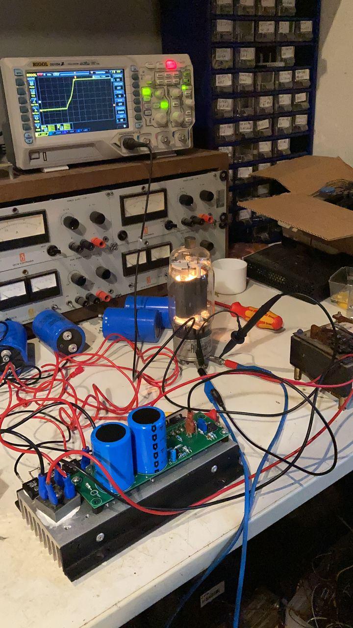

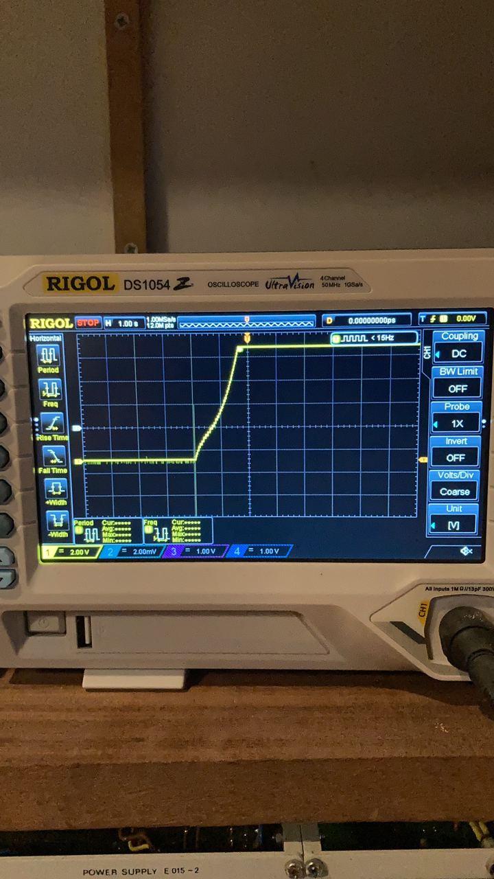

some additional pictures of the start up behaiviour of a 813
See the attached picture of the scope plot, these modules start up a tube in a controlled manner.
