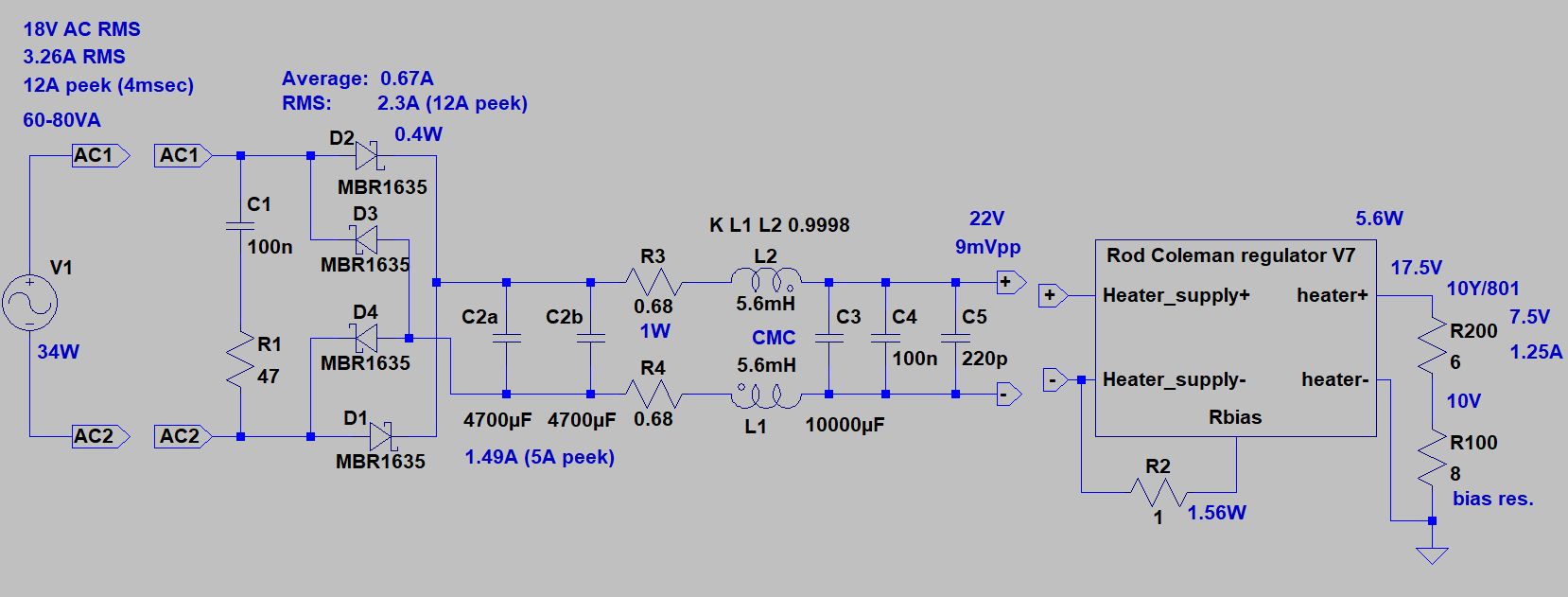

We discussed using CMCs with SMPS supplies in the thread on All-DHT Amplifiers, but could we continue it in more detail?

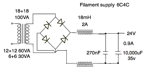

Can we also discuss using CMCs in a linear supply? Where to put them, what values, and how they help hum suppression?
Goal would be to use the supply for something like a 6B4G, 10Y, 112A stage in filament bias. Could be using Rod Coleman regs also.
Here's a simple diagram to start with that you can analyse and pull apart and suggest modifications.

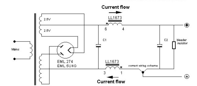

CMC (Common Mode Choke) helps to reduce such disturbances, which are on both wire of secondary. It's not hum decreaser.how they help hum suppression?
Thanks Bela. Questions:
- How do I wire up my 18mH/2A Epcos CMC correctly? I see you've indicated pos and neg on your diagram.
https://www.digikey.com/en/products/detail/epcos-tdk-electronics/B82725A2202N001/1243521
- What advantages are there of putting the CMC either straight after the rectification or after the first cap?
- Presumably the resistors you indicate can be sized for dropping the voltage as required, like could be bigger?

1.) If you see datasheet https://www.tdk-electronics.tdk.com/inf/30/db/ind_2008/b82725a.pdf the correct wiring is:Thanks Bela. Questions:

1 -> 2
4 -> 3
2.) If you use CMC before first cap, the charging pulse passes trough the coil, so stresses it.
3.) The resistors only dropping voltage, so CMC and R.C. regulator dissipation decreases.
My rule of thumb:
Filament voltage + bias voltage on bias resistor (if it exist) + R.C. reg headroom (variable of versions) == raw DC voltage (output of raw supply).
If dropping resistors (I use its in both -positive/negative- wire) necessary, use at least 3..4x larger wattage than counted.
Andy, please locate the CMC in the position that Bela uses. Putting it at the rectifier will form an LC tank circuit that gets excited by the big current pulses from the rectifier, and a lot of noise!
THe most important thing to say about common-mode filtering in Line/mains supplies:
The chief and best common-mode filter is the mains transformer.
Excellent common-mode blocking is given by a LOW value of leakage-capacitance between the primary and secondary, and if possible, an electrostatic shield.
If you are using a filament supply PT with more than ~50pF of PRI→SEC capacitance, it would be better to concentrate on improving that, since the 50/60Hz leakage current also increases with high capacitance. Unshielded toroidals can reach up into the nF region, and this is the reason that I advise keeing away from the unshielded variety, for feeding my filament supplies.
Puny little CM chokes have no practical effect at low frequencies; commercial ones are designed to stop HF CM noise getting back into the mains from the noise created by Line→DC converters. (They don't care about spectrum below 150kHz, since most EMC testing does not need to go that low).
R-core transformers are supposed to have very small PRI→SEC capacitance, I would be interested to know if anyone has measured any commercial units. Cheap DMMs have good enough C-metering to do this, nowadays.
THe overall message should be: if you get the transformer right, you probably don't need to worry very much about CM chokes.

Let's discuss this from a mutual inductance (M) perspective.
The dot notation:
If the two currents flow into each dot or out of each dot,
the mutual inductance M is positive.
On the other hand, if one current flows into a dotted end and the other leaves the dotted end,
then the mutual inductance M is negative.
The common mode refers to signals or noise that flow in the same direction in a pair of lines.
The differential (normal) mode refers to signals or noise that flow
in opposite directions in a pair of lines.
Referring to Fig (A) (From "Noise Reduction Techniques in Electronic Systems", by Henry W. Ott).
To the signal current I_S, the magnetic flux of each coil cancels each other out,
V_S = s (L_1 + L_2 ) I_S - 2 s M I_S + (R_L + R_{C2}) I_S ; s=j w
Neglecting coil resistances,
since L_1 = L_2 = M, I_S = V_S / R_L ; as if the common mode choke is a pair of wires.
To the common noise (common mode noise) currents which appear in both lines of the input,
the magnetic flux of each coil adds to impede common mode current,
the mutual inductance is positive.
Total frequency dependent impedance is s (L_1 + L_2 ) + 2sM = 4 s M.
Referring to Fig (B) and figure above, the latter is from
Lundahl's /Emission Lab application note that describes improved ripple rejection
for a CLC tube power supply.
V_r is the ripple source, I_r is the ripple current.
In this case, the mutual inductance (M) wrt to I_r is positive.
The (common mode) coils are impeding the differential current I_r.
At 100Hz, assuming L_1 = L_2 = M = 5H.
The impedance to 100Hz ripple is 4sM = 100 x 20 = 2K.
Notice that this configuration does not impede common mode noise.
I hope I got this right ! Feel free to chime in.
