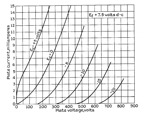

So...I made some measurements. I have attached the 841 curves, which specify DC on the filaments. From my measurements and the curves, we can deduce whether the effective cathode voltage of a directly-heated tube is the most positive side, the most negative side, or some point in between.
I run my 841s at 10mA with a CCS plate load, biased for 400V on the plate. I read a little less than -2.5V grid bias required for my operating point.
I connected the meter common to the grid and probed both sides of the filament and got 2.35V and 9.77V.
Looks like Kay Pirinha is correct (and I was wrong), and the negative side of the filament is the reference for drawing the curves.
The basic question I am after in all of this, though, still stands. I'm trying to determine which is the best side of the filament to connect to the low-impedance reference point in the circuit. Since all DC supplies are imperfect to some degree, which way will be more forgiving of the filament supply imperfections? Or are they both the same? That seems less likely to me but my intuition has steered me wrong before.

Okay, so any curves drawn with AC heating need to be shifted by 1/2 of the filament voltage to be valid for DC heating.
