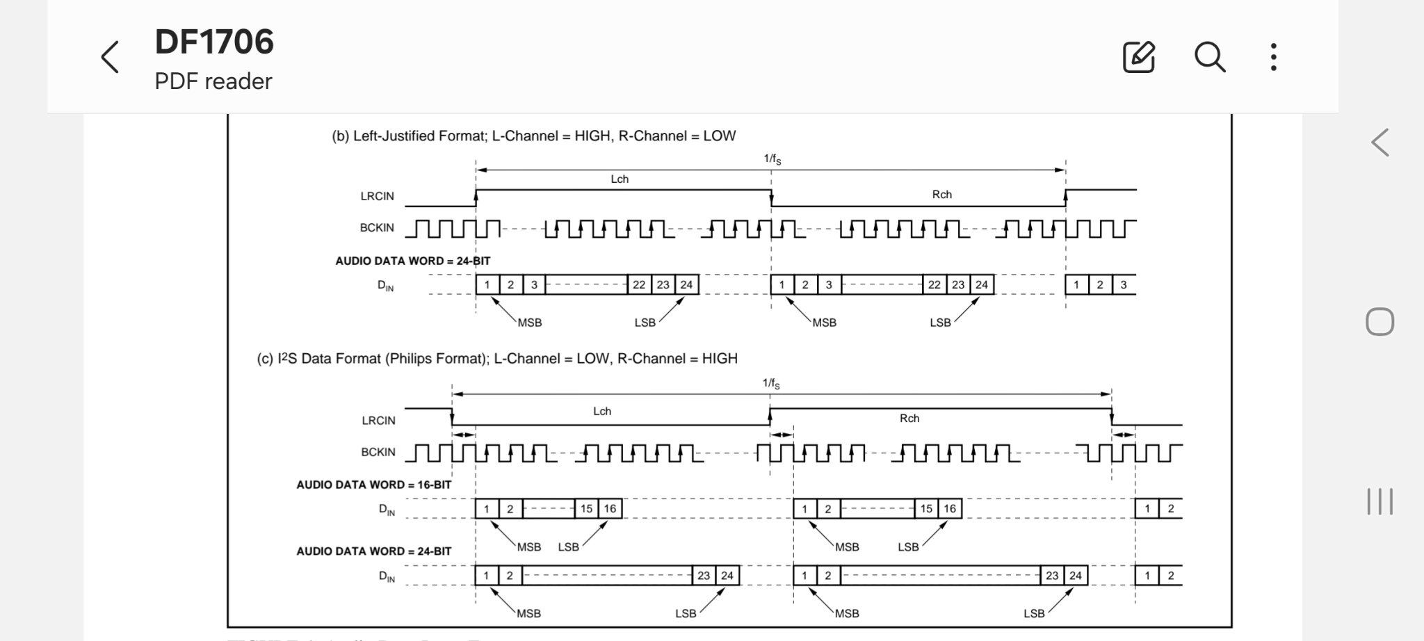

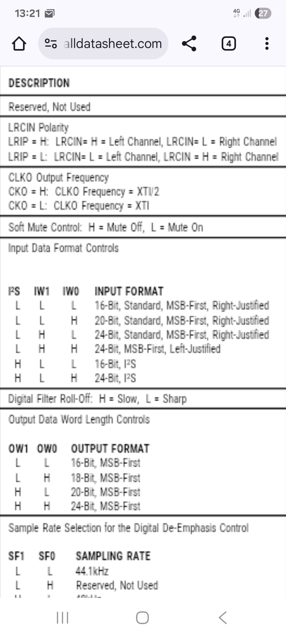

DF1706 Question
I would be grateful if anyone can explain why the DF1704/6 filter chips need to have the bit depth defined for left-justified input formats. The options available are 24 bit left-justified, 16 bit I2s and 24 bit I2s. Does truncation take place if 24bit data are input to a 16bit I2s setting?
