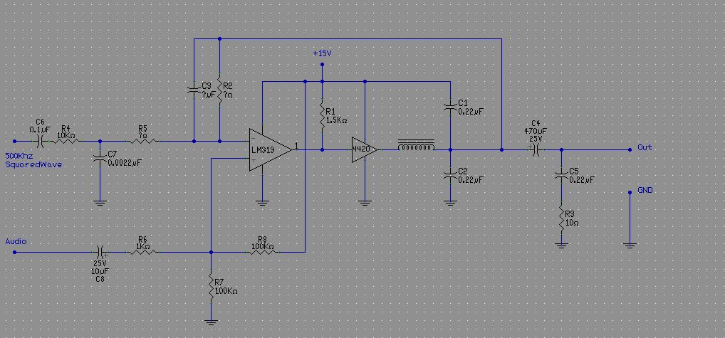

Hello gentleman! I'm looking for a simple design to mount or some help to develop a class D amp... I was looking for simple solutions as a 555 based class D, but nothing was conclusive enought to risk a mounting.
I've been working around some circuits that i've found over the forum related to what i want.
The one i'm looking right now.
http://www.diyaudio.com/forums/atta...65653410-10w-class-d-amplifier-design-10w.jpg
My first doubt about it is because i've simulated the square wave agains the passive low pass filter, and it just turn into a triangular wave if the square wave is simetrical (top +, bottom -)
That frustrates me, means i can't buid a 555 timer based for the 500khz square carrier? I'm looking for single supply applications right now, but if needs, i've a transformer 12+12 3Amps that i can arrange a +-15v or something.
I need some advise about it, cause i'll work around some simulations before go out to actually protoboard it (here at my city is a hard job to find electronics, and a hard "trip" as well)
