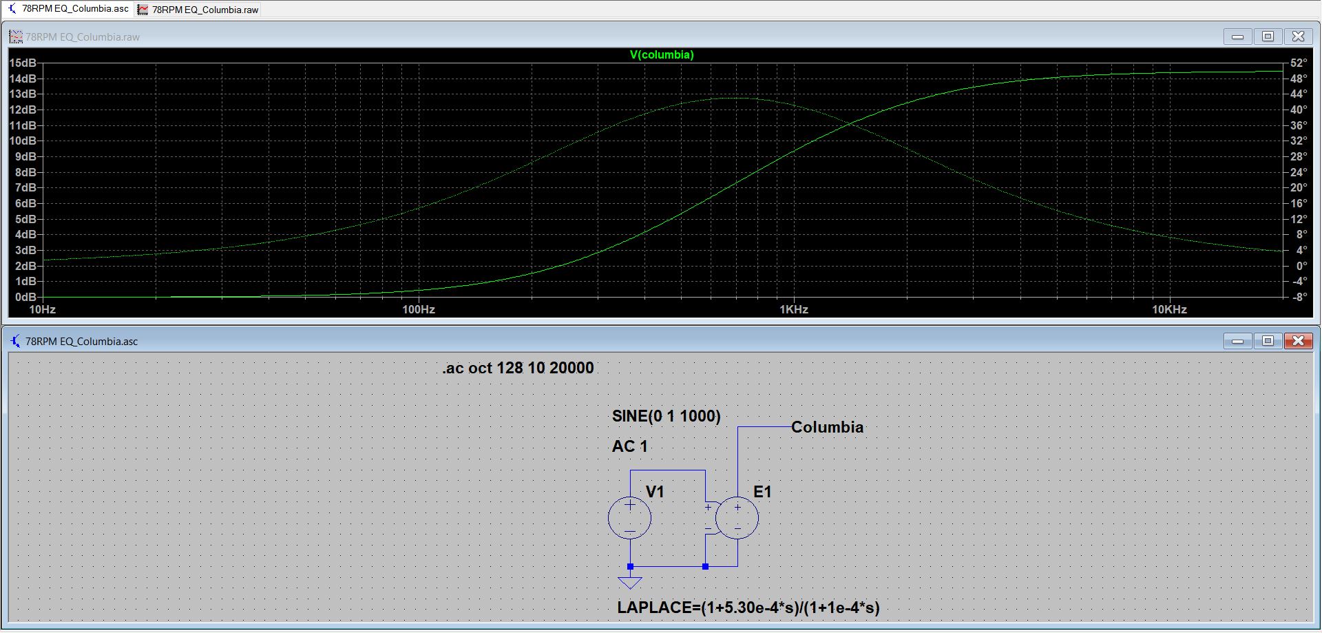

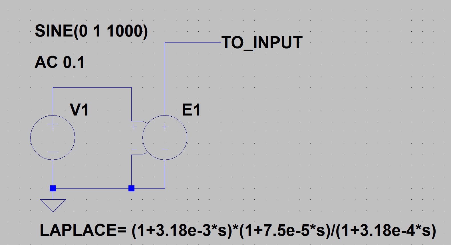

Hopefully this will help:
LAPLACE= (1+3.18e-3*s)*(1+7.5e-5*s)/(1+3.18e-4*s) and see the attachment below.
Edit: I misread your post so this probably isn't helpful, and I no longer exactly remember how to do the transform.
I would have thought it would be only the 2nd (tau 3) and 3rd (tau 1) term in the equation, alternately you could place the bass shelf an order of magnitude lower which ought to work?

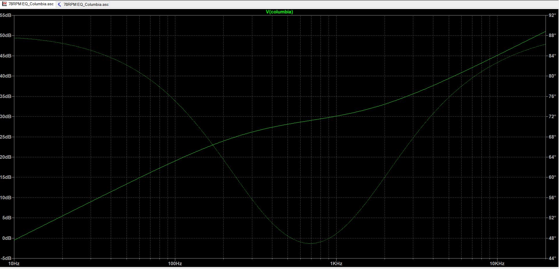

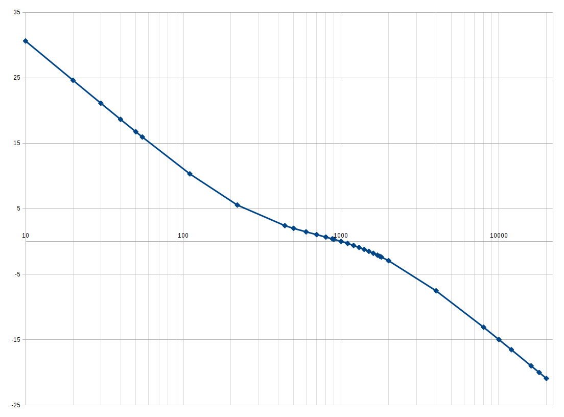

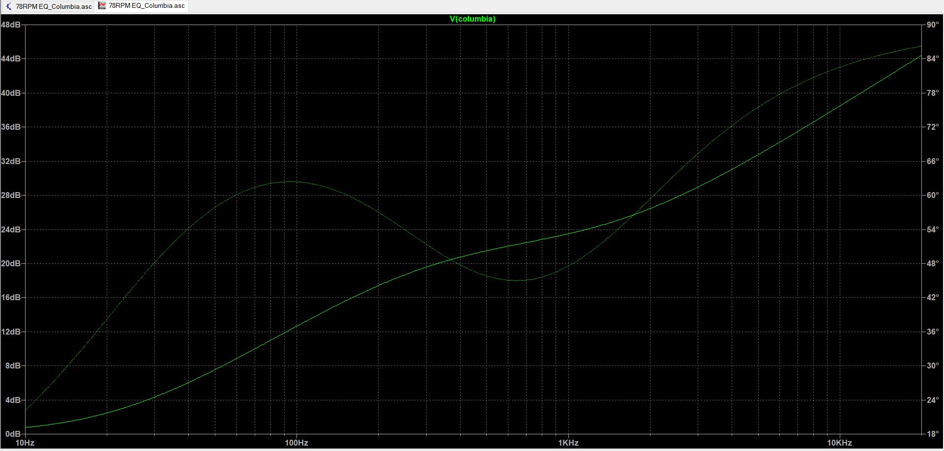

No, that's what I had tried initially as well. The curve would look like this (the playback characteristic). Obviously the recording characteristic would just be the playback characteristic flipped about the x-axis. The limit as frequency heads toward zero looks to be infinity? And the limit as frequency heads toward infinity looks to be heading toward infinity?
Perhaps LTSpice is trying to perform calculations that give division by zero and thus non-nonsensical results? Maybe there isn't a Laplacian that gives just two inflection points?
That (ideal) curve has a pole at the origin, so the transfer function would have a factor of 1/s.
At HF, the 100uS pole does take the magnitude toward zero, like the (original) RIAA curve.
Kevin was right, just use a second pole at a very low frequency, around 2Hz-20Hz.
There won't be that much gain available, anyway. As its time constant gets very large
(as pole frequency s0 gets very small), its transfer function factor 1/(s + s0) approaches 1/s.

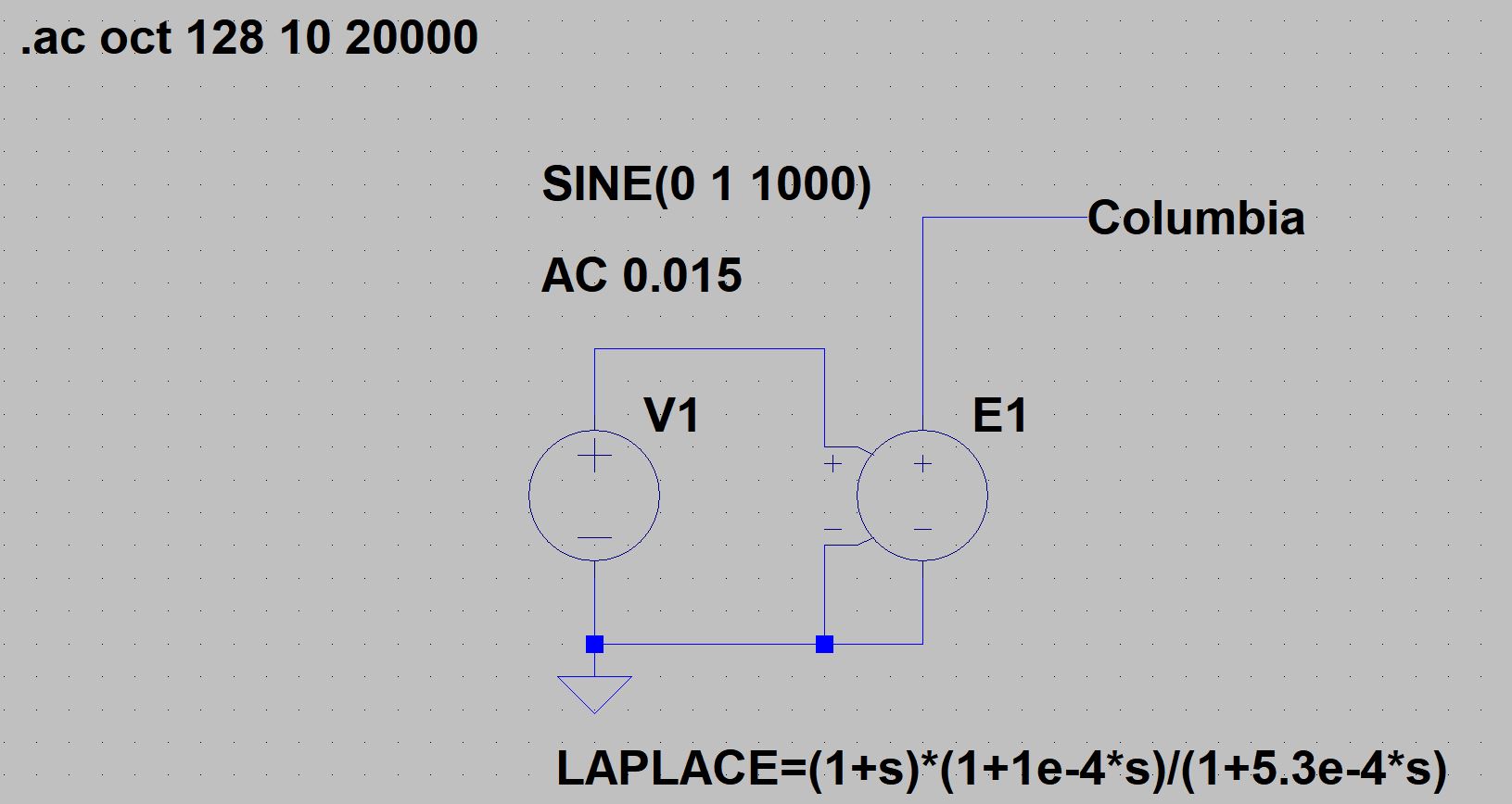

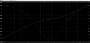

I tried this, and what Rayma said makes sense, so my earlier comment might have been closer to the mark..
LAPLACE=(1+s)*(1+1e-4*s)/(1+5.3e-4*s)
Note: I made a correction and this looks more reasonable. (replaced both attachments and modified the equation)

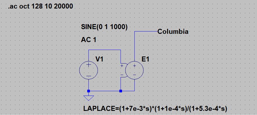

Perhaps for a 78 a good compromise value would be 30 Hz or 40 Hz?
I would say 30Hz might be a good starting point to roll off the LF boost. I would say add a zero (?) at around 7000us in the simulation and see where that gets you. Shown below..
