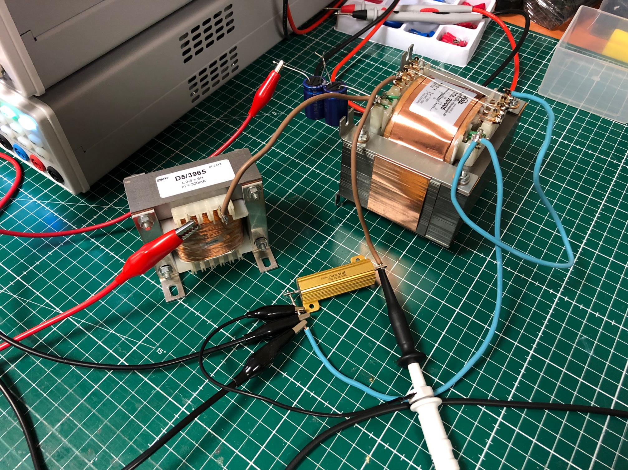

Yet another method uses a bridge rectified low voltage transformer secondary to pass a DC and an AC current through the DUT transformer primary winding and then through a series connected current sense resistor. Depending on the source transformer voltage, and the sense resistance, the level of DC and AC currents can be varied to obtain test points for increasing DC current, and AC current can be made fairly low so as to determine the droop in small-signal inductance along the BH curve.
I typically use this technique for power system chokes, but the technique works equally well for SE OT's.
https://dalmura.com.au/static/Choke%20measurement.pdf
I use my vintage valve tester to provide a very convenient multiple stepped AC voltage source (with sufficient current grunt for all the chokes and OT's I've tested due to the tester supporting a wide range of valve heaters) - strangely my valve tester gets far less use for testing actual valves!
