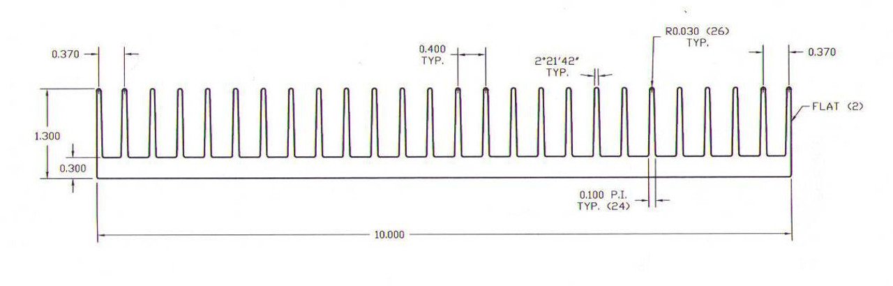

Rod's instructions say "a 0.5°C/W heatsink for normal hi-fi use if the quiescent current is maintained at the minimum recommended of 20mA."
I don't know what to do with that.
This is the heatsink I was considering and I found this calculator, but I'm not sure what value to use for Ts (max).
I have built two similar 2-pr output amplifiers. These hatsink fins are overkill, I have used the same length, same base thickness, but with 1" fins 3" tall (3U) and it worked great, never had any heating issues. That said this HS will be more than enough for the amp.

Height and base thickness are the main contributors to getting heat away from the output transistors - IMO, anything 3-1/2" or taller would be plenty for a single channel amplifier. I have run this same heatsink, with 2 channels of a 2-pr lateral mosfet amp on each heatsink 4-1/2" tall, +/-65Vdc without issues.
If you have space for taller HS and can afford it, it will always be better for reliability, also can be used later when you get the itch to build a different amplifier, which you will. Good luck!

The calculator posted in post #1 is not really useful, since it only varies fin pitch.
Maybe try this one :
https://heatscapecal.com/natural
The heatsink supplier actually gave you a spec of approximately 0.80 °C/W for a 3" extrusion.
But you should study in detail what that figure means.

In case you might want to turn the P3A into P3B (exactly the same circuit) one day, you should consider getting a heatsink of 0.25°C/W.
https://sound-au.com/project3b.htm
You would be looking at something like 400x50x150mm minimum per channel, something like this :

Thanks, I didn't catch the C/W/3" meaning.The heatsink supplier actually gave you a spec of approximately 0.80 °C/W for a 3" extrusion.
So assuming it's proportional, a 5" extrusion would have a .48°C/W rating and would meet the recommended spec. That seems overkill for a +-35v amp though.

Based on what bullitstang said I'm going to try the one with 1.3" fins. I have limited depth but I can go 5.5" tall so that's still allot of surface area.
