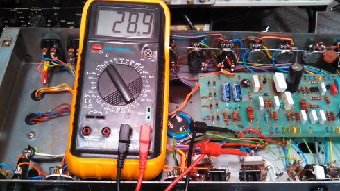

Amp turns on. Roughly playable. Owner mentions a weak output power, amp acts funny. Volume seems to swell and retreat, slowly. Other issues include almost no/faint response from the low impedance input (you plug in and can barely hear it).
First step on bench, speaker test confirmed issues. Amp was connected to a scope and signal source. A sine-in did not produce a pure sine-out. I did not document exactly what I saw for some reason, so I will avoid speculation. *
After checking the tubes in a tube tester and tapping them during speaker test, a few screws were removed to look at the circuit board. A toasted cermet power resistor called to the eye. Checked and found a bad electrolytic next to power resistor and bias adjustment. Live voltage test showed that the bias on the power tubes was a good amount off, but screen and plate voltages were alright (409/410V).
During probing (yes with aliens) the preamp tubes directly with a signal generator (capacitor coupled), something weird shows up. For reference, the high Z input goes to V1, while the low Z goes to V2. Injecting into pin 2 (control grid) of the second triode in V2 sounded bad, while probing into pin 3 (cathode 2nd triode) allows audible hum through to the speaker. I suspect that there shouldn't be signal moving from tube cathode to speaker, right?
*About my notes on the scope test, the output waveform was irregular, and I believe the top half had a greater amplitude than the bottom half. I swapped the position of the Power tubes, no difference was made. I can only imagine I must have swapped the preamp tubes around as well, looking for trouble in the phase inverter tube.

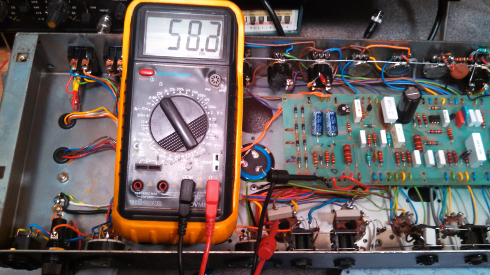

- After the above had happened, and I replaced the known defective parts, the bias was restored and I ended up probing the output transformer directly through the red and blue leads during a live test. One of the two tests (red side test and blue side test) produced a sine wave-out, and the other produced a minimum of two waves riding together, and of a lower amplitude than the clean sine test. When the amp was off and the caps unloaded, I tested the resistance through:

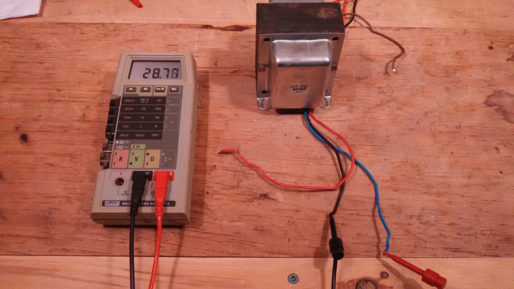

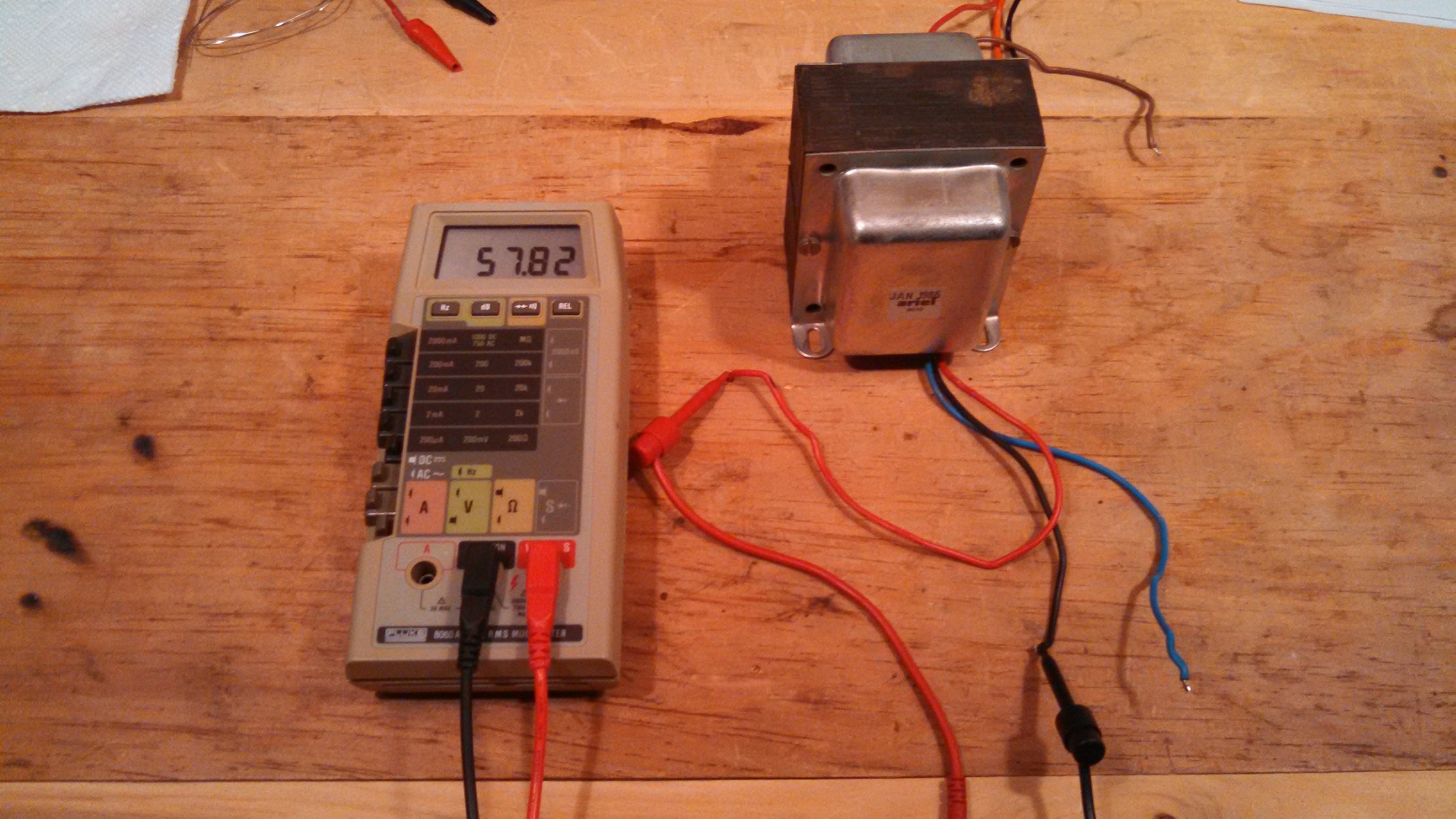

- 1. The entire winding, red to blue. 87.7R
- 2. The red to black CT. 58.7R
- 3. The blue to black CT. 29.1R
Where are things now? I bought a new replacement OT from Laney. Removed the 1981 original and compared the two. Installed the new one into the amp. Now, it has new issues. See my next post for pictures and data.

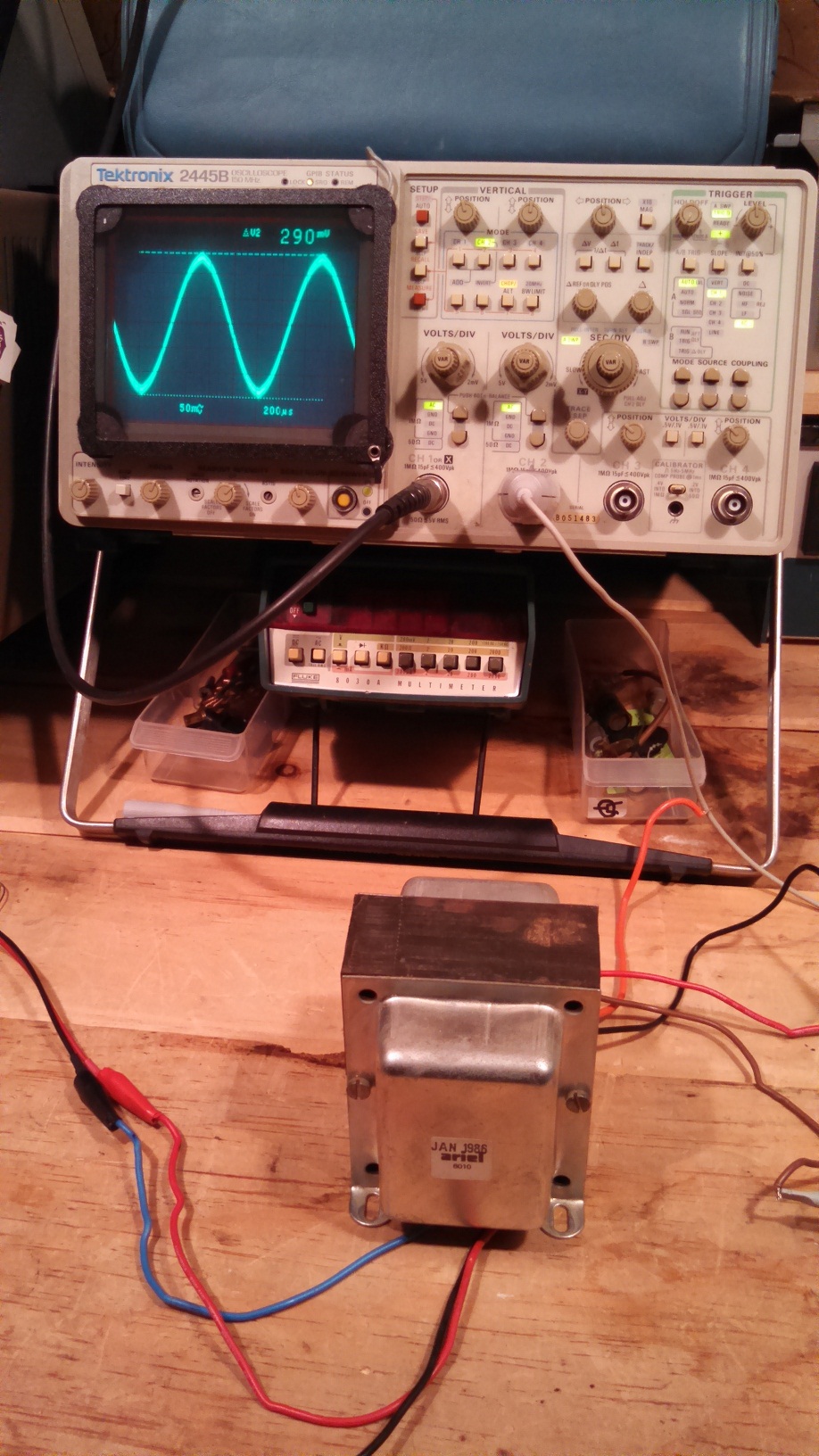

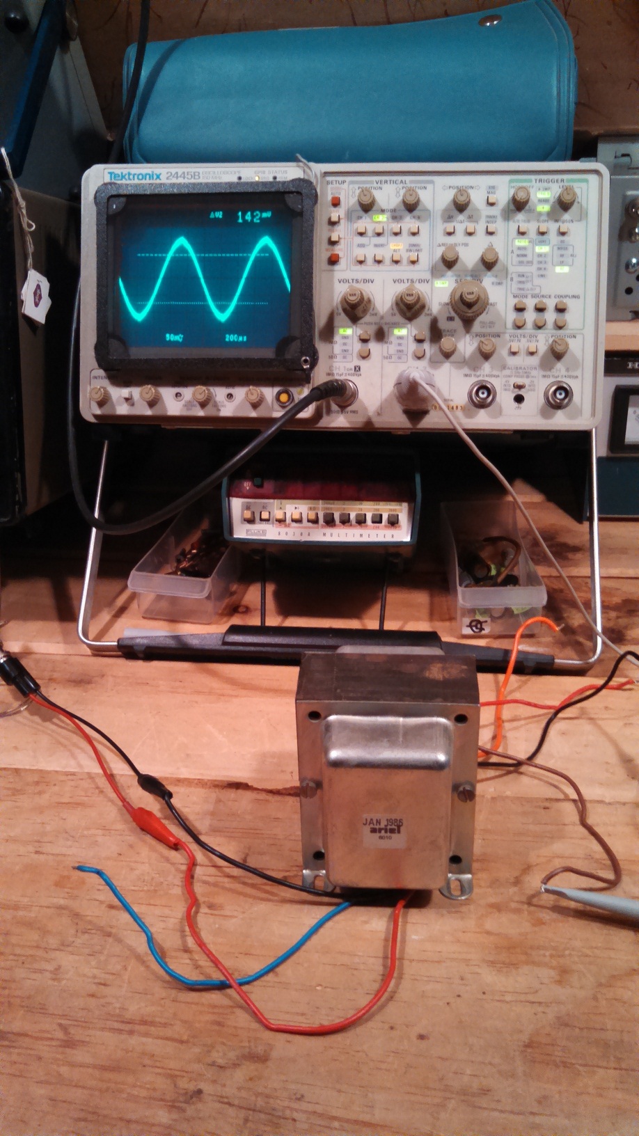

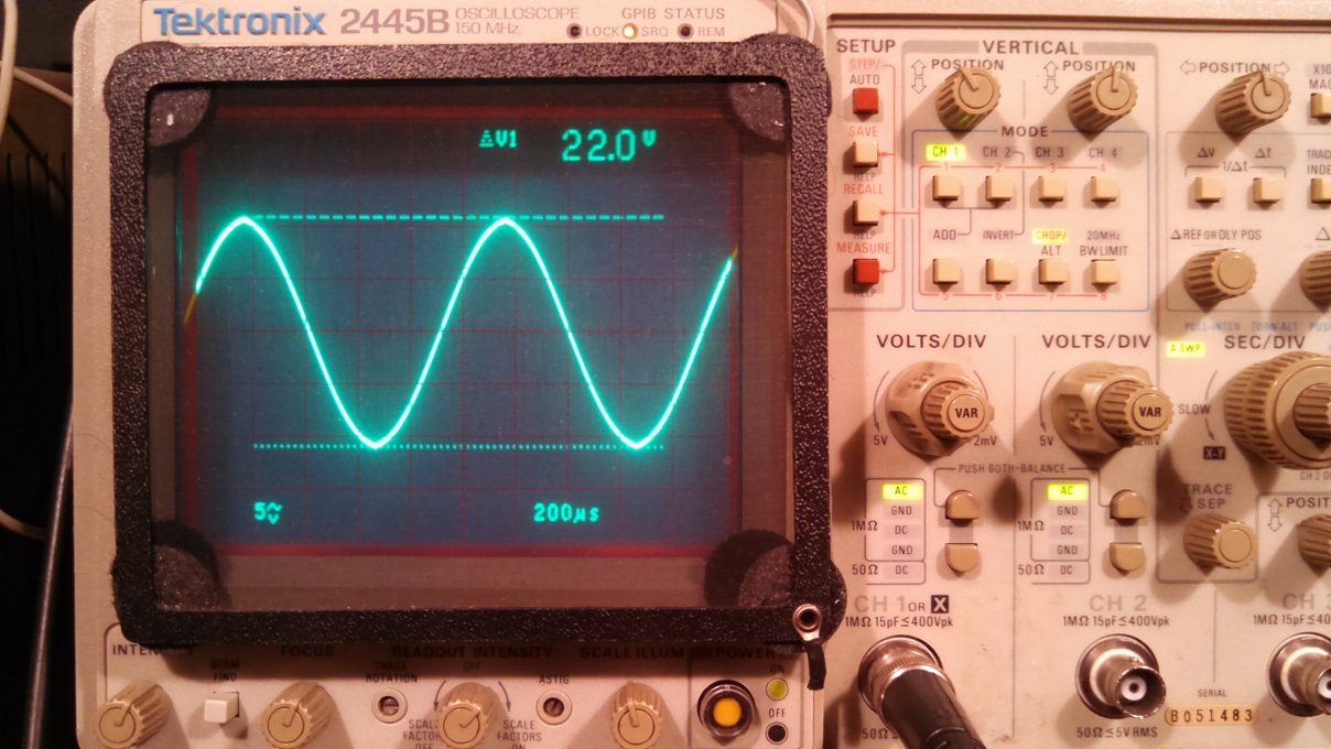

These shots show the different amplitudes across each primary side. The output transformer was bad for this reason alone, although I have suggested (incorrectly) that it was the cause of a low frequency oscillation heard during testing. Does anyone know if there is any truth to this transformer adding "other" problems to the circuit? Wouldn't the load impedance's seen by each power tube be different?
Pictures, from left to right:
Blue/Black lower ohm
Red/Black without cursors adjusted
Red/Black higher ohm
Red/Blue total winding (unnecessary)
The photos don't identify the test or levels unless you add some extra explanation - the cro screen cursor levels are unclear - the input signal is not defined.
The testing in post #3 is fairly bulletproof and safe, as long as you have a reasonable voltmeter.
About the levels...
The test was meant to send an adequate amount of ac through the primary so that a decent signal would show up on the secondary side.
IMPEDANCE QUESTION. The signal generator was maxed out at about 7.48VAC with a 1kHz sine.
The Fluke 8060A was used for this measurement, and it is a True RMS with no calibration certificate. A Velleman DVM890F read 7.41VAC. I have a question here- The scope is calibrated, performed this year by a well established company near Boston. I understand that it measures peak-to-peak, not rms. IF my connections were all exactly the same impedance, from the generator to the scope input, I would multiply the scope's cursor-to-cursor voltage measurement by .707 to obtain the rms value of a pure sine wave seen by the scope, right? Well, my scope displays a p-p reading of 22VAC when the input is set to 1MEG, and only 1.7VAC when using the 50 ohm impedance input selection. The signal generator has a stated output of 600 ohms. In order to see the correct p-p amplitude on the scope, the generator should have a 600-to-50 ohm impedance modifying bnc on it, and the measurement should be taken using the 50 ohm DC input, right?
The pictures in the previous post compare the amplitude of the red-black portion of the winding to the blue-black section, in a relative way. The new transformer shows 50/51 ohms, on each of the primary sections. I realize this is probably as within tolerance as I will get from a mass produced product, but, would anyone bother to add a 1 ohm resistor??? Even though the resistor will not be the same as an additional turn or two of wire, and it wouldn't contribute to the production of a magnetic field inside the transformer, could it be of any benefit to the system? Thanks.

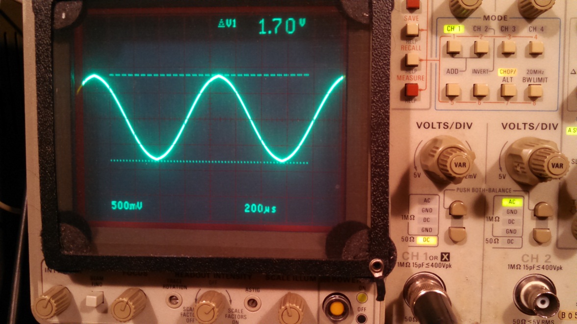

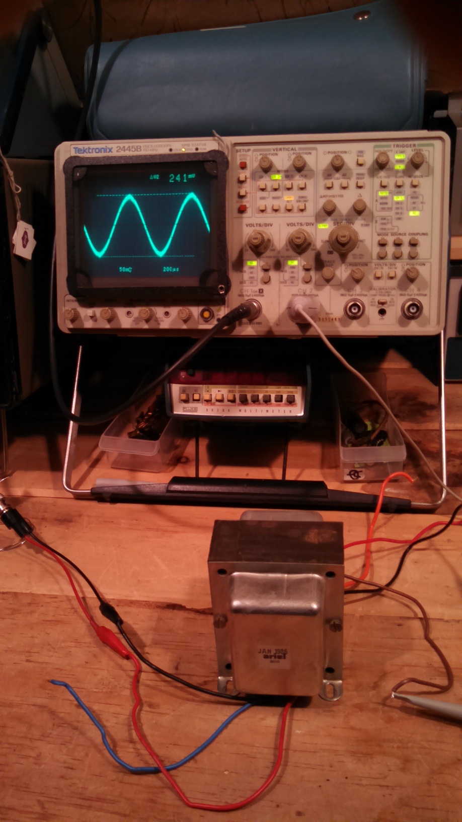

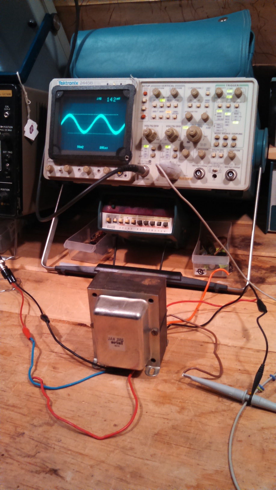

scope w/ 1M input
scope w/ 50 ohm input
scope w/ 1M input
Your posts are very confusing 🙁 so please just do this:
1) use the new transformer which you just received.
All leads unconnected to anything else, except stated measuring instruments.
2) drive it end to end (red to blue) with your generator, set to 1kHz.
Also connect your scope input across same ends; say ground to blue, hot to red.
FORGET the 50 ohms input, not needed here, just use the 1M setting, also measure end to end voltage with the multimeter.
3) rise the generator output level as much as you can, without getting a distorted signal, then lower it a little to some "round" value, simply for convenience.
Say, if you can get up to 7.48VAC, lower it to plain 7VAC.
VAC measured with the True RMS multimeter, since you have one available.
Leave the other multimeter aside for now, we don't need alternate values at this moment.
4) now measure voltage from center tap (black) to red and to blue, post both values, while still driving the windings end to end .
So: generator still end to end : Red to Blue.
But now Scope ground and multimeter black probe to center tap (black) , and scope hot input and multimeter Red probe measure center to one end, then to the other.
I'm interested in what the multimeter says , simply because it's more precise, the scope is there mainly to confirm that the waveform does not distort or clip and as a rough "backup" meter.
That's enough fo now.
