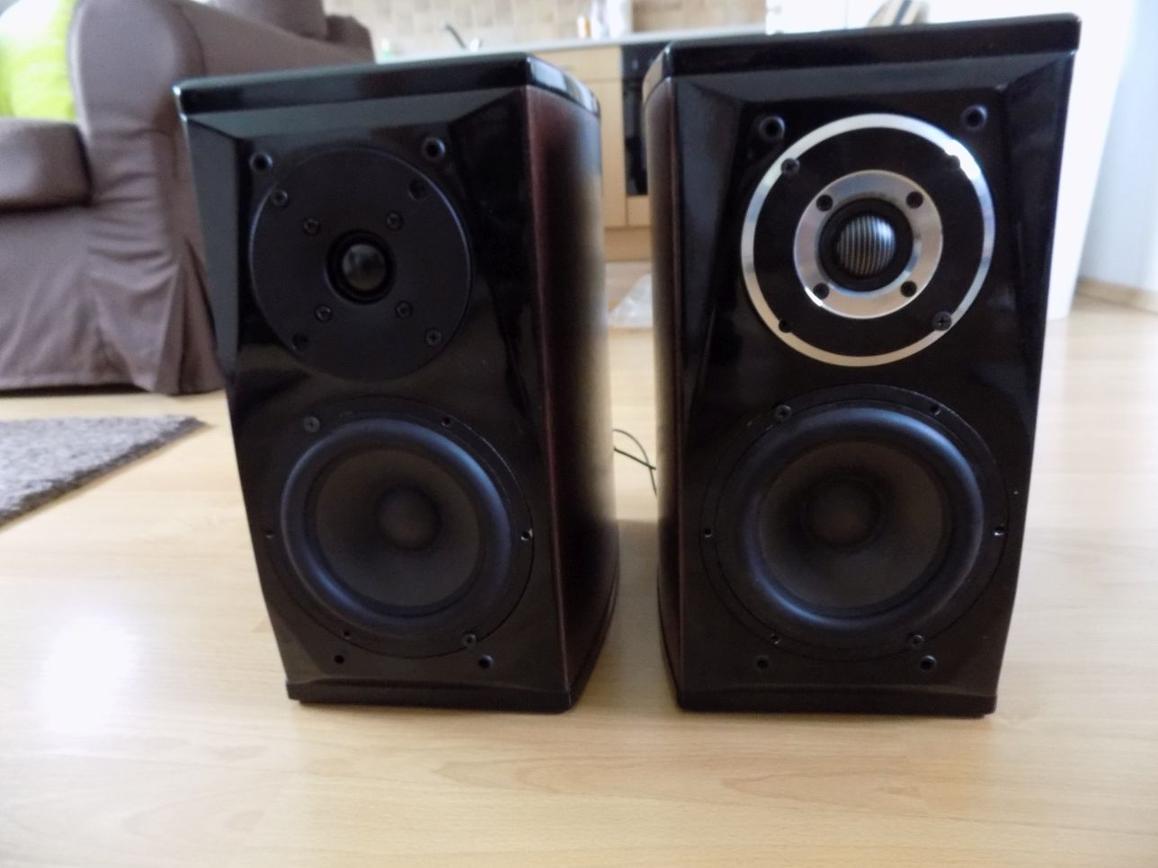

Hi!
I used it to replace the original tweeter of Sound Art W2.
Originally it used a modified Dx25 (i think)
I liked it's sound, but you should xo it higher, at least 3k. If i tried with 2k, 2,5k - it had noisy mid-high (high 3rd harmonic distorsion) but i never measured, only my ears 🙂
For this low amount of money it is a good tweeter. You can pair it with small midwoofer or use it in a 3way application.
