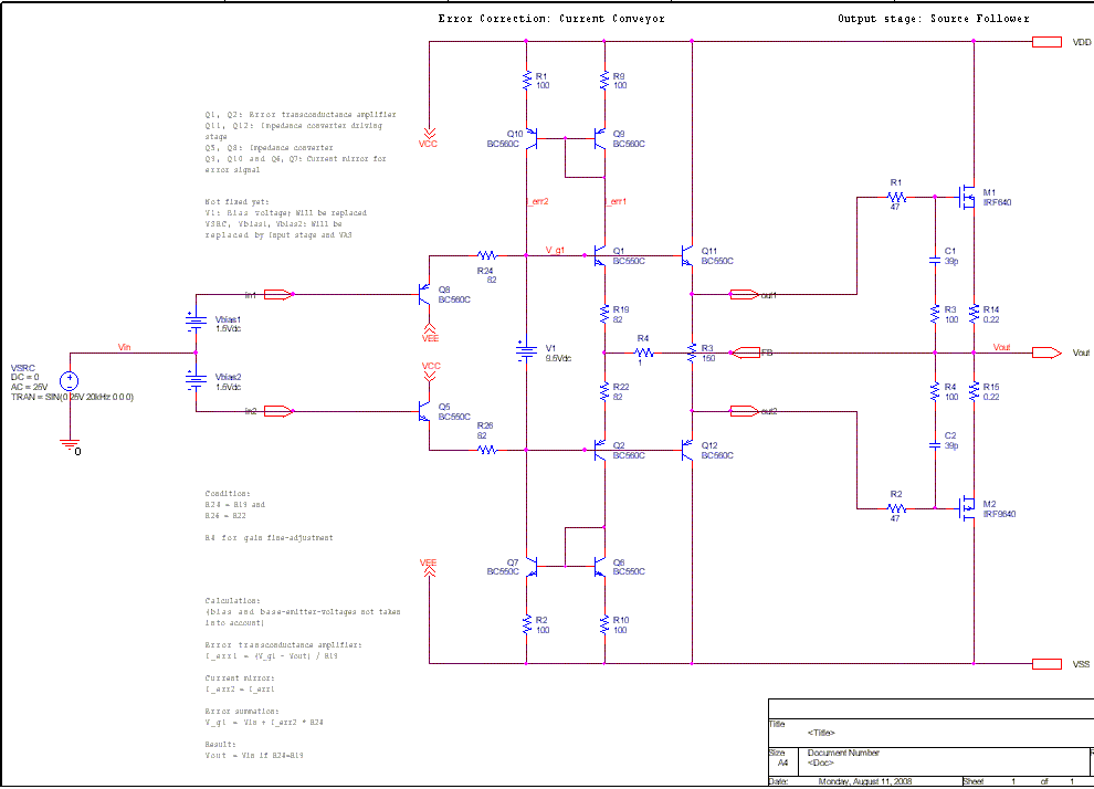

I did some considerations and changed the EC circuit, so it will work with low bias voltages. I will show you in a few hours, when I have access to my computer at home.

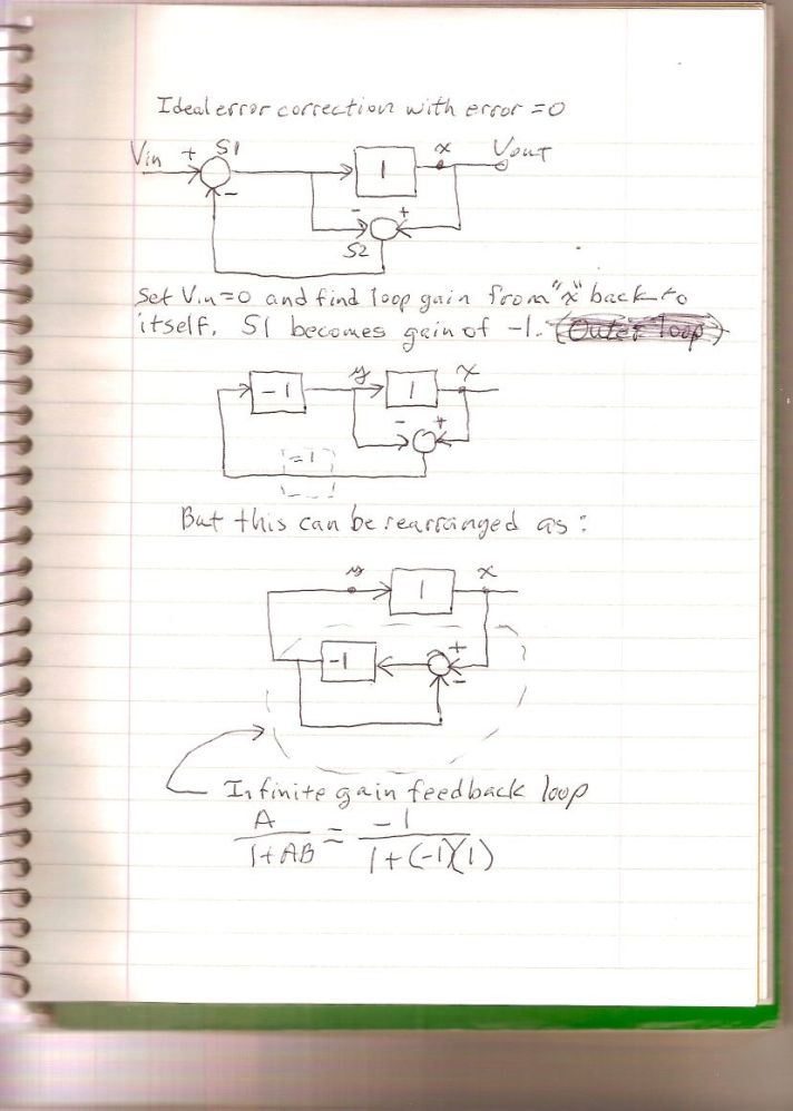

No it doesn't. Cordell's circuit effectively puts the loop gain in the FB path rather than the forward path, that's all. This is commonly called a servo circuit. It is NFB just the same. There is no more "error correction" going on than there is in ANY other NFB circuit.
By all means base the choice of Cordell's circuit upon number of transistors or other implementation attributes, but don't fool yourself into thinking it is anything other than localized NFB.
Cordell borrowed the term "error correction", which is a misnomer, from a paper by Hawksford which presents a simplistic and theoretical mathmatical model, including both negative feedback and feedforward elements.

Guthorst said:
Because the forward path has a less than unity gain, and the result should be unity gain, there must be something in the feedback path to increase gain.
Here's something I posted in the Cordell error correction thread a couple of years ago. Using Hawksford's simplified model, it shows where the "infinite" loop gain comes from.

Dear Rikard,
This is a first proposal from my last design I'm working on. It's a current conveyor, like Jan Didden used. I didn't want to use integrated circuits, and only a small number of transistors. The design is not finished yet, some bias voltage components have to be replaced - I inserted DC voltage sources to simplify the design. And a frequency compensation is essential, because above 1MHz, gain increases dramatically.
Its not a complete amplifier, input differential pair and VAS stage are missing. I only want to optimize the output stage.
THD+Noise for that Error Correction and Output stage is near 0,04% at 20kHz, 25V_peak and 8 Ohm load. Components are not optimized yet. And adding the input differential pair and VAS, and applying an overall NFB will reduce THD.
I'm used to calculate THD at 20kHz, because Douglas Self showed that it is easy to design a good performance at 1kHz, but it's a higher challenge to give good performance at 20kHz.

Looks interesting!
I like symmetrical designs, something tells me non symmetricals are not as good, eventhough I have seen many very nice amps that are not symmetrical...
So, here is my prototype. I have built one but not using the error correction stage. I get ok performance from it, but would like to see this EC work.
I zipped a gif screenshot, hope it opens ok.
