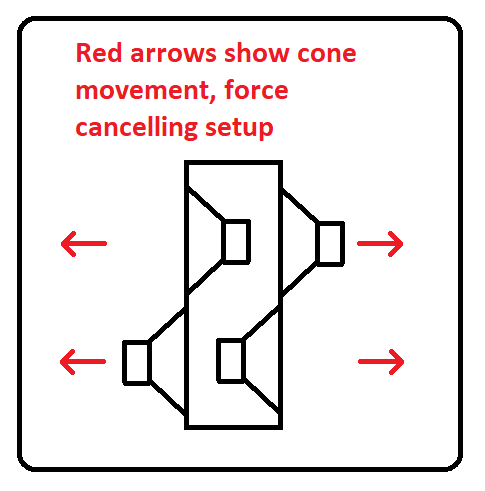

Instead of going with a singe driver you can go multiple smaller ones, while 4 may be overkill there are huge advantages to go in multiples of 2 as you can cancel pretty much all the mechanical forces in such a setup.
Inverting half of the drivers also reduces driver distortion since if you take 2 drivers that combined push-pull at the same time now the outwards stroke is the same as the inwards stroke -> less distortion.
You want to keep the drivers as close as possible though, in my example I have drawn selaed sub with a open slot at the front with 4 drivers in a push-pull configuration.
