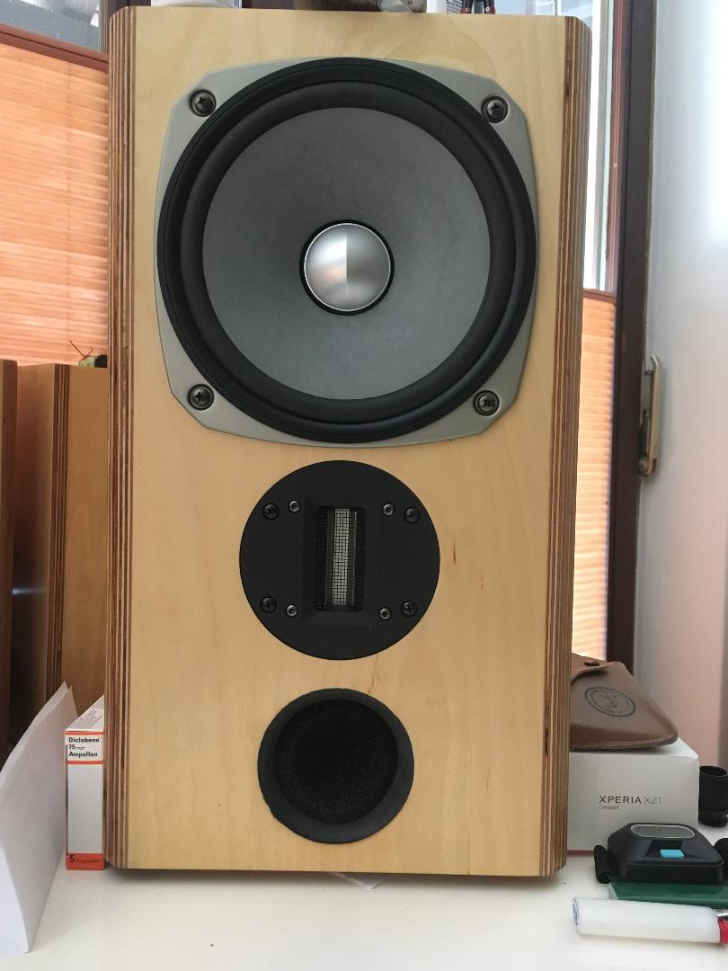

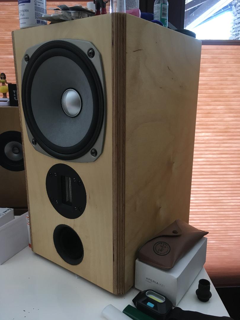

Hi all,
Am in the process of designing and building a 2-way standmount with the Fostex FF225WK and the Aurum Cantus G2Si tweeter. (Why these drivers? Well, I've had a pair of G2Si lying around for more than a decade, and I suddenly realised that I need to build a small high-sensitivity standmount pair for a small room, to be driven by a SET amp. So, I chose these. Maybe I could have chosen some other 8" or 10", someone referred me to the PRV 10FR300PR, who knows? But the deed is done.)
Other than the driver selection and the enclosure, nothing else is decided. I'm going for a 34-litre bass reflex design. I built the enclosure using my current practice of using (relatively) inexpensive 18mm ply for internal bracing, 25mm MDF covered in real-wood veneer for the outer shell, and 25mm birch ply for front and rear baffles.
I decided I'll just keep writing all sorts of things I discover or think while taking this project ahead. I'm sure I'll learn a lot from your comments. I'm definitely getting into some new territory here, since this is my first ribbon tweeter (I've already blown one tweeter's ribbon), my first attempt to measure driver distortion, etc.
Some photos of the enclosure build included here. If anyone finds the design interesting enough to want detailed scale drawings, just ask. I'll put them up on my website later anyway -- I always do. This was my first (and only) attempt at doing a stepped baffle with ideas of time alignment. I am not sure of the physics of a 25mm step actually succeeding in time aligning these drivers, so I'll just leave it as it is without arguing about the pros and cons of physical time alignment. Enough has been said in other threads, and I've read them and find the matter inconclusive.

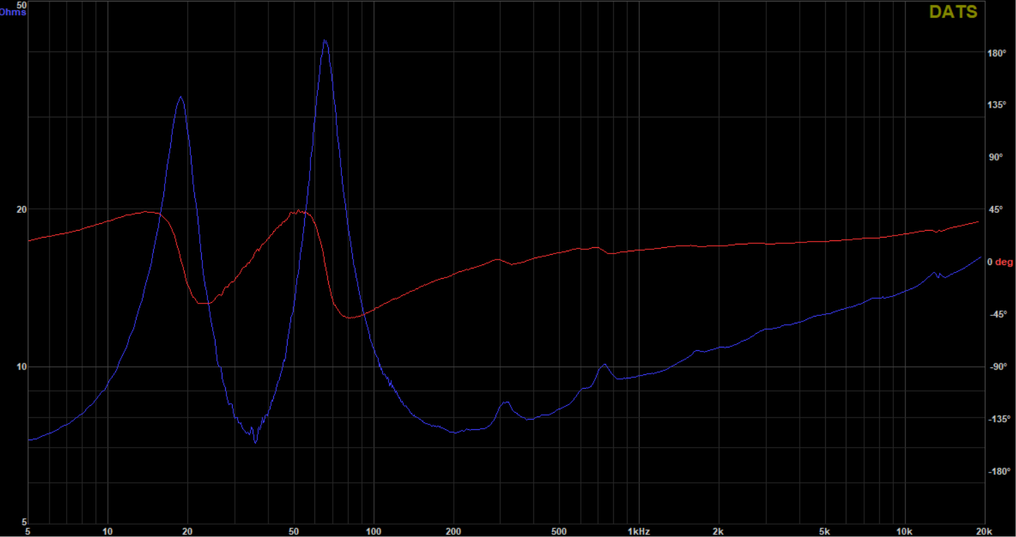

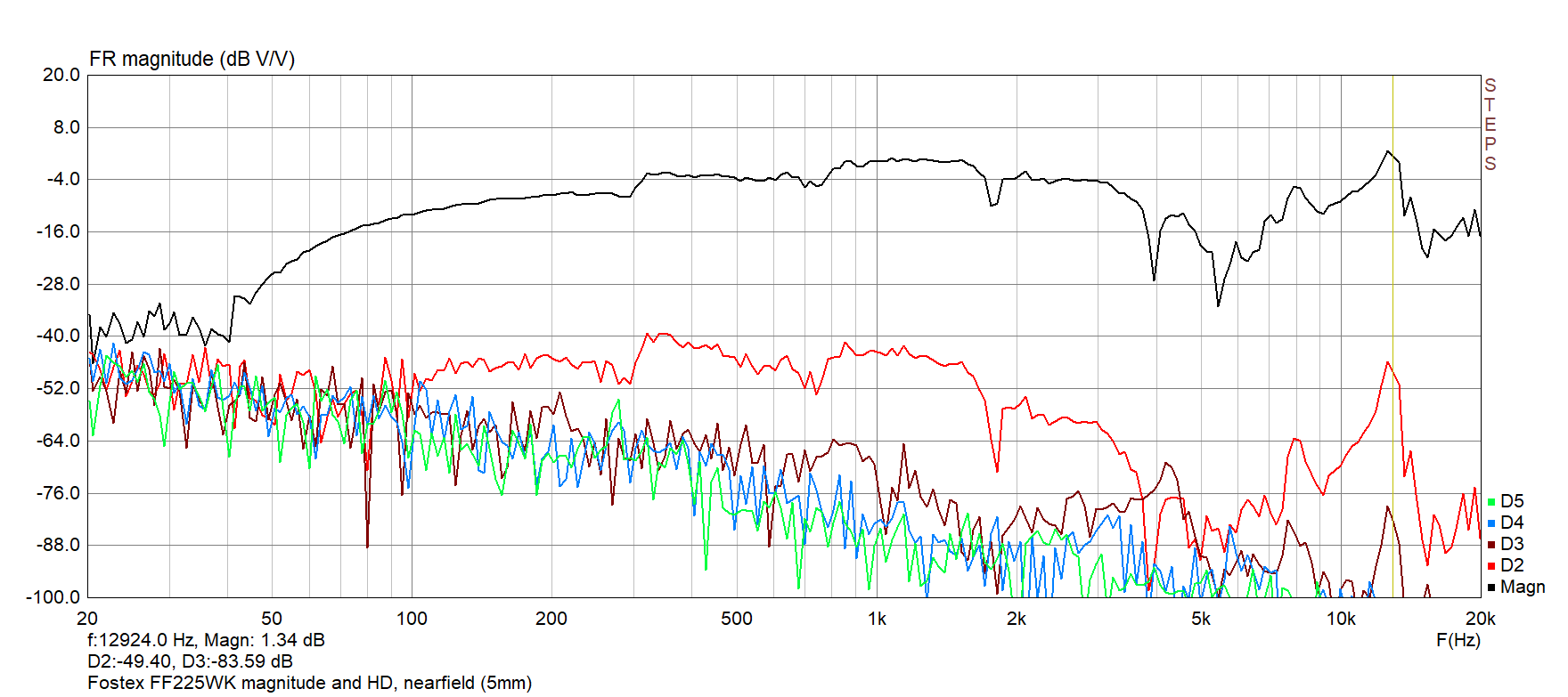

Took impedance measurements of the FF225WK in the enclosure, with my new DATS v3, with the bass reflex port fitted. The twin peaks match almost exactly with the Unibox simulation prediction.

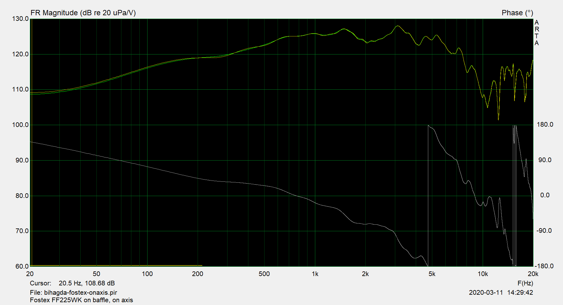

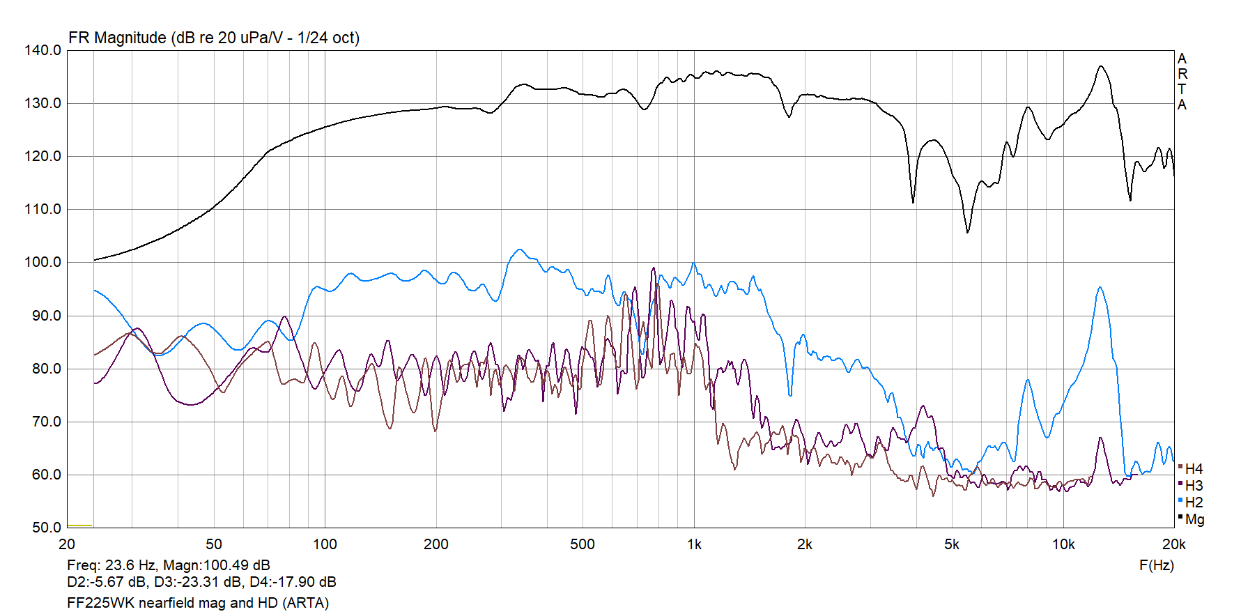

Also took SPL measurement, gated 1 metre, using ARTA.

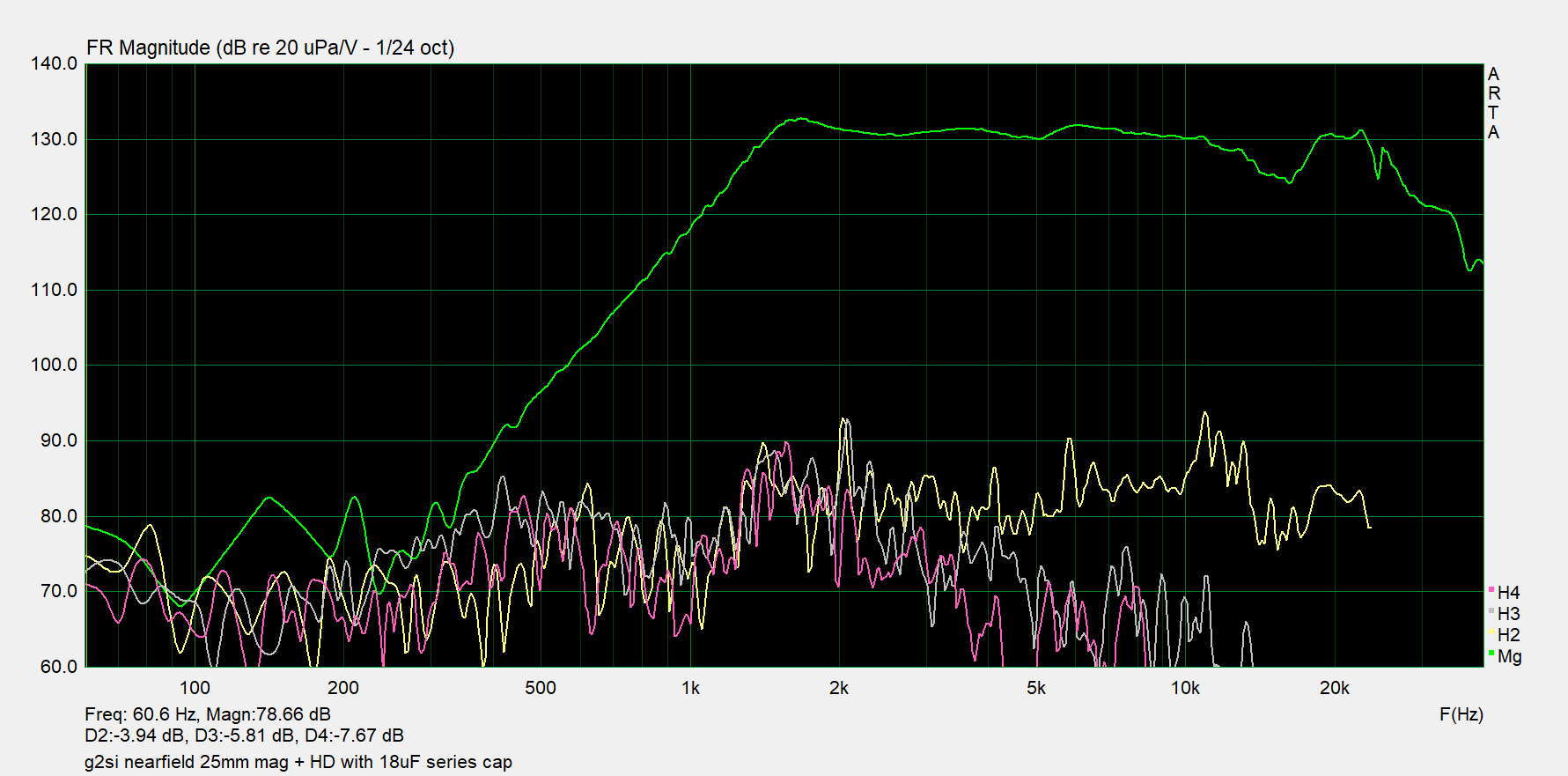

Then I decided to try my hand at distortion measurements, with both Arta and Steps, from the Arta suite. I use a Focusrite Scarlett 2i2, and a Dayton mic calibrated by Cross Spectrum Labs.
For the Fostex distortion graphs, the graph which says "magnitude and HD, nearfield (5mm)" has been taken with STEPS. STEPS takes a long time, since I was doing 1/24 octave steps. The second one, which says "nearfield mag and HD (ARTA)" has been taken using Arta, using its swept-sine signal, with the mic untouched, the level and gain settings unchanged. This one gets done in about 5 seconds, unless you want averaging over multiple rounds. I just wanted to see what the differences would be with the two methods. These are the very first distortion measurements I've done of any speaker driver.

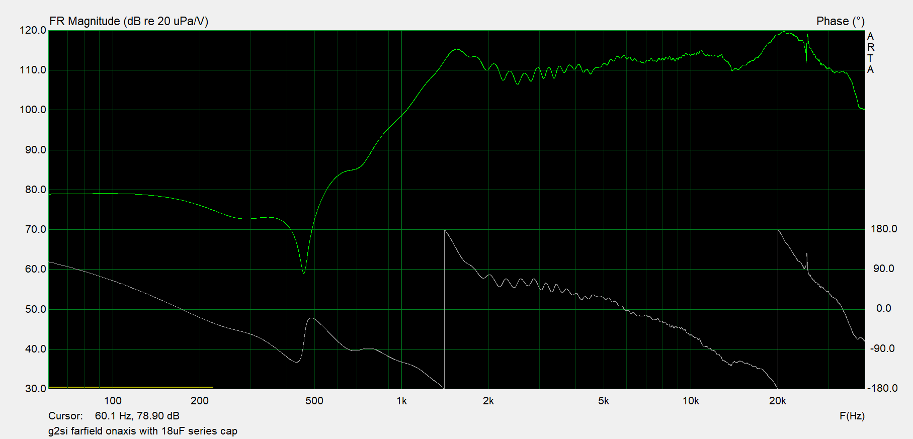

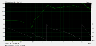

For the G2Si measurements, I used ARTA for both the SPL measurements and the distortion measurements. I kept an 18uF capacitor in series this time, after I blew my last G2Si while taking measurements without any cap. The mic was about 30mm from the front grille of the tweeter.
Some graphs with a black background, some with white, are irritating. I'll keep a consistent scheme in future.
What should I do about the crossover? I'm tempted to try a 2nd order at about 2.5KHz. The beaming of an 8" driver going up to 2.5KHz won't be as much of a problem in the intended usage of this speaker, since one will listen to it on-axis almost all the time anyway.
The peak in the FF225WK at about 1.5KHz will be audible. The peak at 3KHz will be taken care of by the crossover, I expect.
Before designing the xo, I intend to take off-axis measurements. Will post here when done.

g2si-nearfield-25mm-mag-plus-HD-with-18uF-series-cap.png105.9 KB · Views: 103

I totally agree with you. Given the choice, I'd never use a ribbon like this in a 2-way -- one needs to cross over too low for the ribbon to handle it well. In fact, I've not been too enamoured of ribbons based on what I've read about them. But I'd bought these ribbons well before I had acquired these nuggets of wisdom. As my reservations about ribbons grew, I left them lying all this time.
So, I know that there will be a sharp difference in the directivity when I move from the 8" to the ribbon. Your idea of the 2K dip was very similar to what I was thinking -- I was wondering if inducing a BBC dip would help. I believe the BBC dip was invented to handle this sudden change in directivity. And I'm hoping to get away with all this a bit more than in the general case, because I will be using these speakers in a small space, 10' x 10', with pretty much on-axis listening.
So maybe I'll go with a 4th order at 2K? If I am forced to use four coils for a 4th order xo, I don't even know if I have enough space inside to fit four coils to minimise their mutual coupling.
If I could start afresh, I'd not use an 8" in a 2-way, unless it was some kind of magical high-dispersing 8". If I didn't have this desire to use up the G2Si, I'd probably use an SB Acoustics SB26ADC 1" dome, which I am told has very low distortion down to 1K, and can be crossed at 1.5K.
What do you think of the distortion plots? Are they representative of what these drivers are like? Am I getting the graphs "right"?
..the scaling on that particular graph needs to be improved (along with color background changes).
The integration window should probably be further away from the loudspeaker, so I'd make my decisions on the crossover at 2+ meters. With particular emphasis on the polar response (mostly horizontal) and the listening axis (..as opposed to the reference 0 degree axis). Lot's of pillows on the floor (spanning the distance between loudspeaker and mic.) tends to help with those further field measurements.
