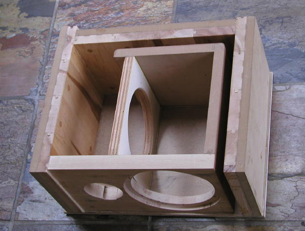

On a backburner for a while is fine, as I also have some projects to finish, but not too long😉.
The box definitely has to be out of solid wood. This one is made of 3/4" maple plank, used for floors with MDF on the outside. I find that with time, wood tends to warp and MDF is there to keep the panels straight. The sides however, will be solid maple boards, like Sonus Faber. Again, the woofer, 5" AudioTechnology, is connected straight to the the amp, no crossover and a single cap on Triangle tweeter.
I will start lookin for those Seas drivers.
