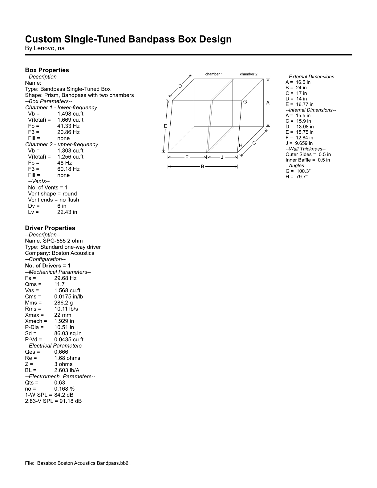

Modeled an enclosure using Bassbox 6 (first time using this software) and wanted to get your opinions on final specs.

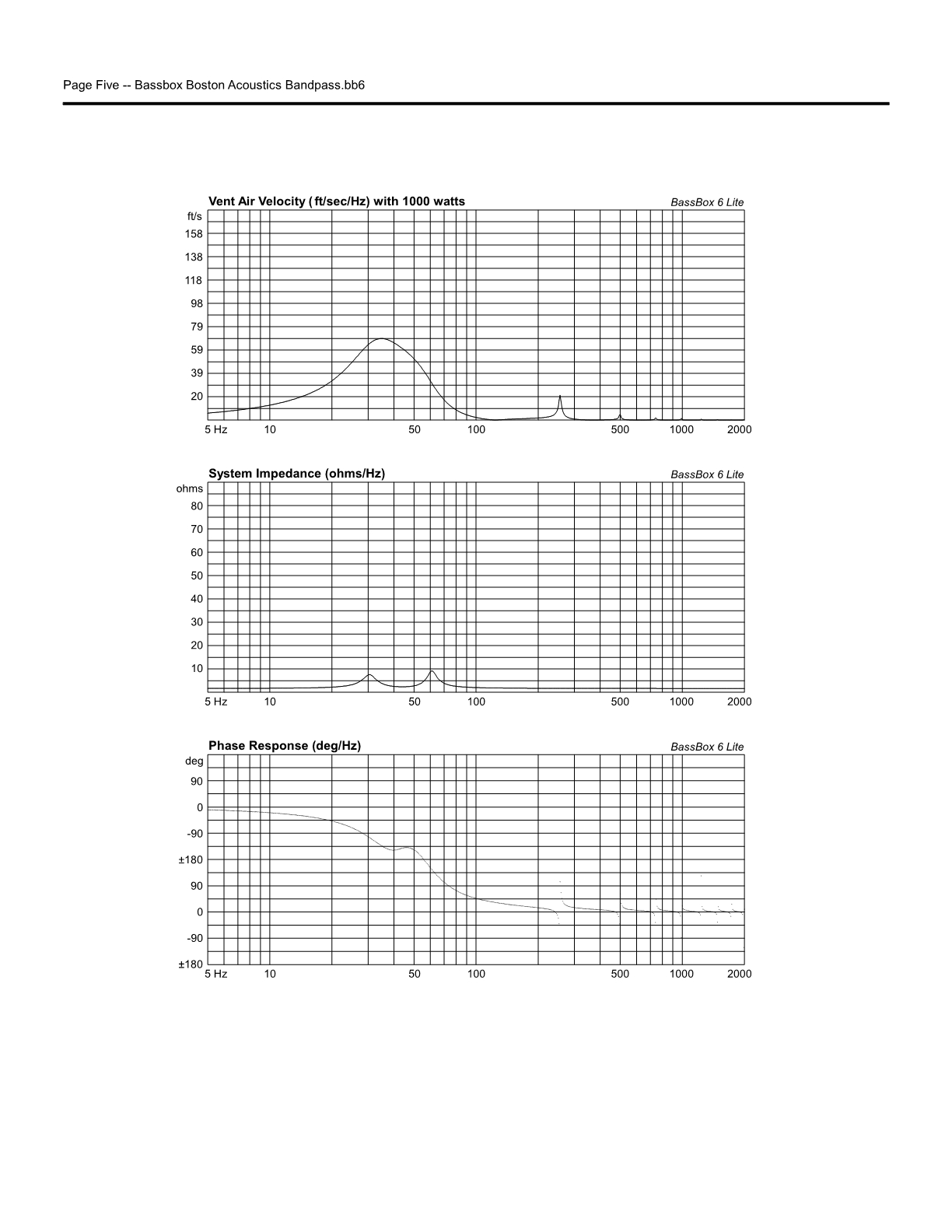

Anyone see problems with this set up? One of the issues seems to be potential air cavitation using the 6 in port, not sure what is 'too fast' for air to travel without distortion.

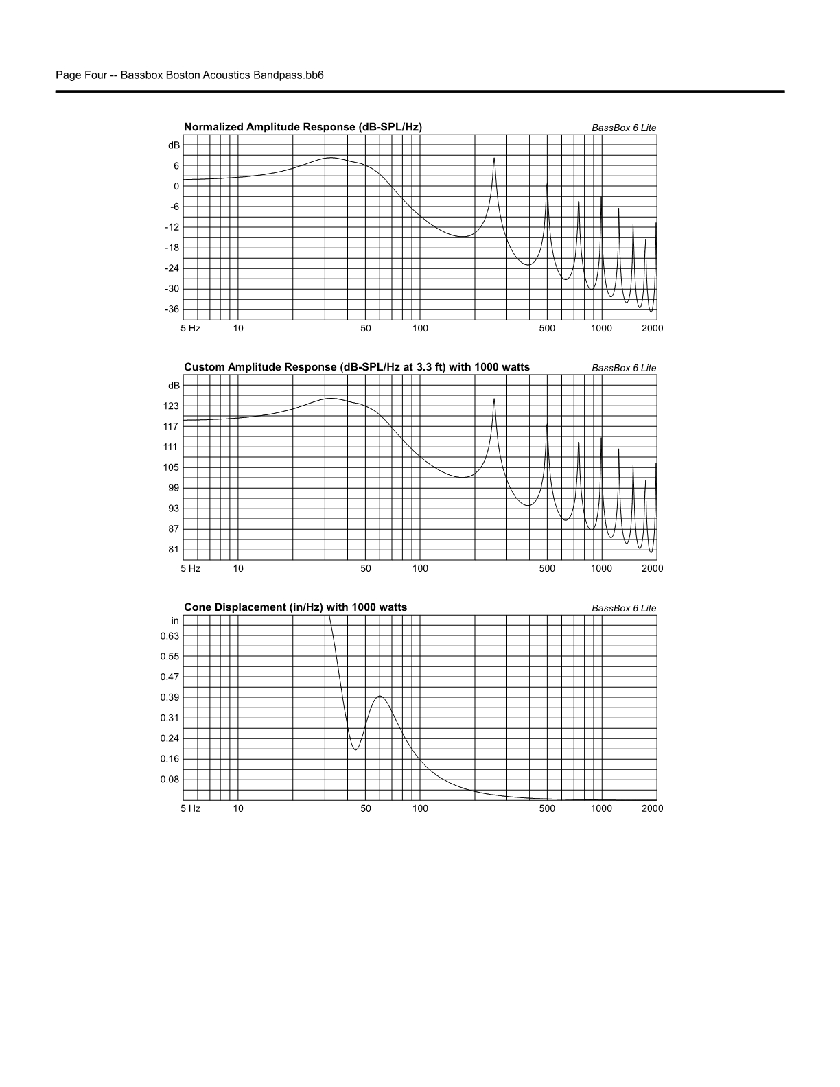

Charts, settings, etc....included. Any issues? Adjustment suggestions? Thanks!

I don't see inductance mentionned...it's add a big low pass in this kind of speaker box. Do you have this parameter value for this speaker ?

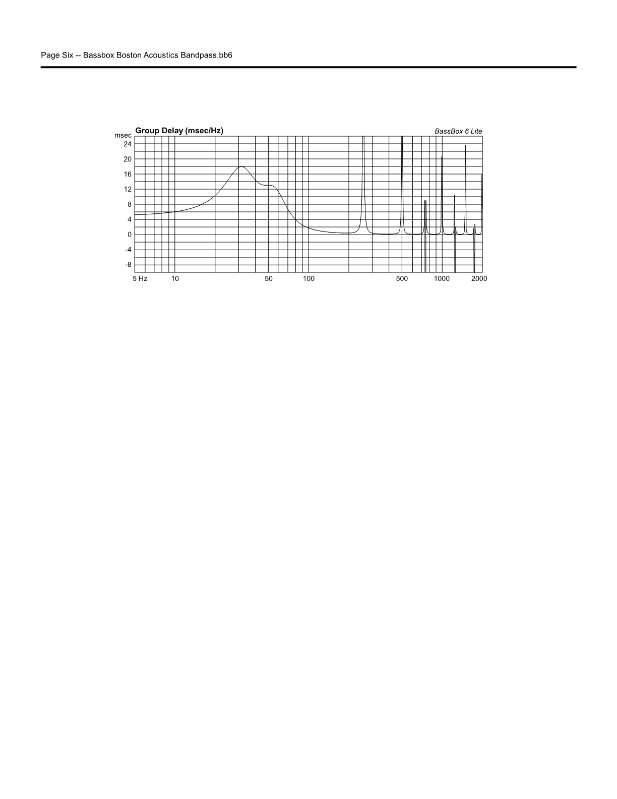

Got +/- the same result as you with hornresp with 1400 w (taking account of speaker real resistance), and with inductance of 2mH (seems me reasonnable). Group delay is not too bad.
40m/s vent air velocity on port (lot higher than more reasonnable 15-20m/s) means lot of chuffing, and port compression, very bad thing.

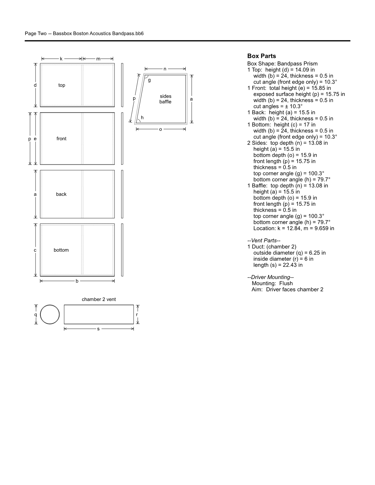

The 22" vent should be ok, I'm going to run it either through the rear parcel shelf or through the arm wrest area of the back seat. I may need to add a bend within the box to take up some of the total length.

Have you experienced chuffing/port compression, power compression ? there will be a point (and a lot sooner than what you can expect) where leveling up power will no more add lows, but a bit of noise. 6" vent is just too small.

I'm not familiar with Bass Box, but I'm wondering why the first graph shows the response leveling off at 0 dB to the left, all the way down to 5 Hz and beyond. For a 4th Order Bandpass, I would expect a plateau (or peak), with a roll off slope on each side.
Also, I'm wondering about the value and units given for the Bl product in your attachments. The spec sheet that I found on line gives BL = 11.58 T*m for the 2-ohm version. (What is lb/A?)

The software has a cabin gain algorithm which significantly affects some of the graphs. It flattens them out a lot.
FWIW, you could build a sealed or vented box, with an additional "coupling chamber" that directs the output through the entire arm wrest area. There should be several examples of such a configuration available via Google search on the Internet.
I once tried the bandpass with vent through the rear package tray approach. It sounded like crap, due to the location and the use of a vent that was too small (the output of a 4th order BP enclosure changes significantly at different levels if the vent is too small).

I've had to move up to a 6 inch port due to air velocity issues, it's tricky to build but will model and decide. I don't mind a challenge, but don't want to bet on something that the odds say won't work.
