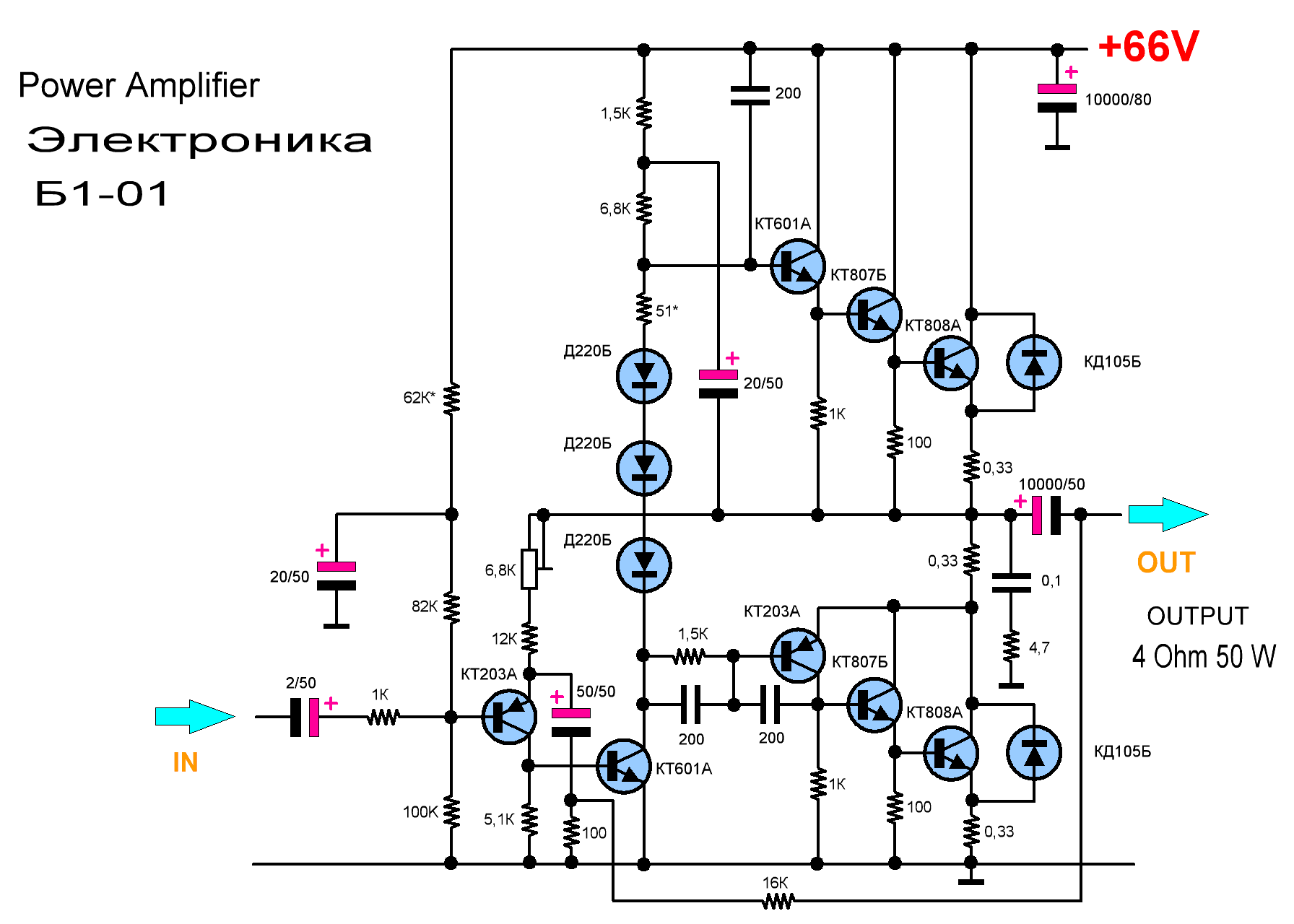

Hi Tiefbass !
Here is example of using output tripple inside of SSSR vintage Elektronika B1-01 integrated Amp.
Maybe this schematic can help you to get some answer to solve stability of quasycompl tripple .
Best Regards !
Thank you for this schematic. But I don't understand follow features:
1) Why a short to GND at the speaker output befor output capacitor (GND symbol at right hand of 6K8 DC-NFB resistor
2) Why 51Ω as serial resistance for the three serial bias diodes?
3) Why not Vbe multiplier (Transistor and one resistor and one variable resistor)
4) Why different kinds of resistors for the DC-NFB pad (maybe one with and one without unwanted parasitic inductivity)?
5) What is the benefit for this kind of compensation

1) There is no any ground sign there , since 6k8 resistor is actuallu 6k8 trim-pot .
2) If you look close you can see that 51R resistor have * marking beside them ( same as for 62K* res. ) , which mean that resistor is precise chossen to establish desired OPS quiescent current , basically we can replace fixed 51R res. with 100R trim.pot , and 62K res. with 100K trim.pot .
3) I think three series bias diodes is suficient to get relative stable bias for this simple Amp .
4) I don`t know
5) I don`t know
Best Regards !

thank you for clarifying.
