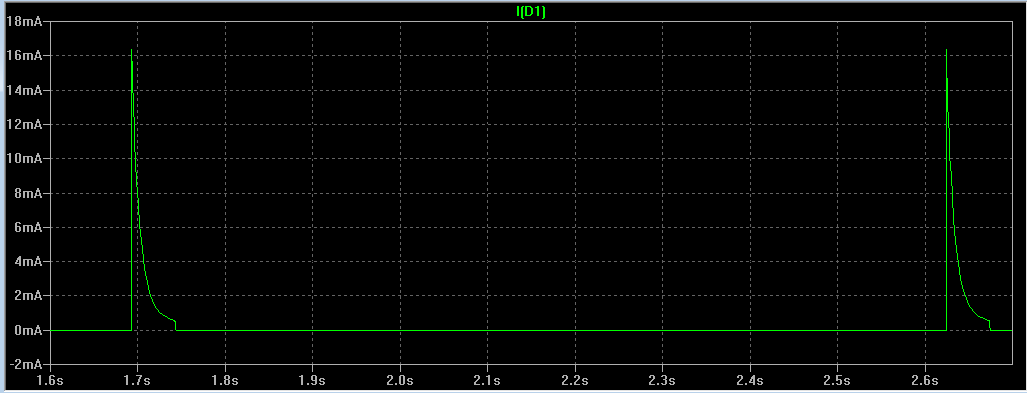

I'm attempting to attach a picture of the current waveform through the LED of my latest design. Parts have been ordered but not yet delivered, so, yes this is a simulation (gasp!). It happens to be a 3 (discrete) transistor circuit, but I find that transistor count and charge efficiency don't always correlate; few transistors often means worse efficiency. Or, maybe that's just a reflection of my ineptitude at designing small device-count circuits.
I'll post my circuit in a month or so, after I've built it. Meanwhile, fool around with the idea, do the Etude, have some fun! Post your circuits here if you feel like it.
