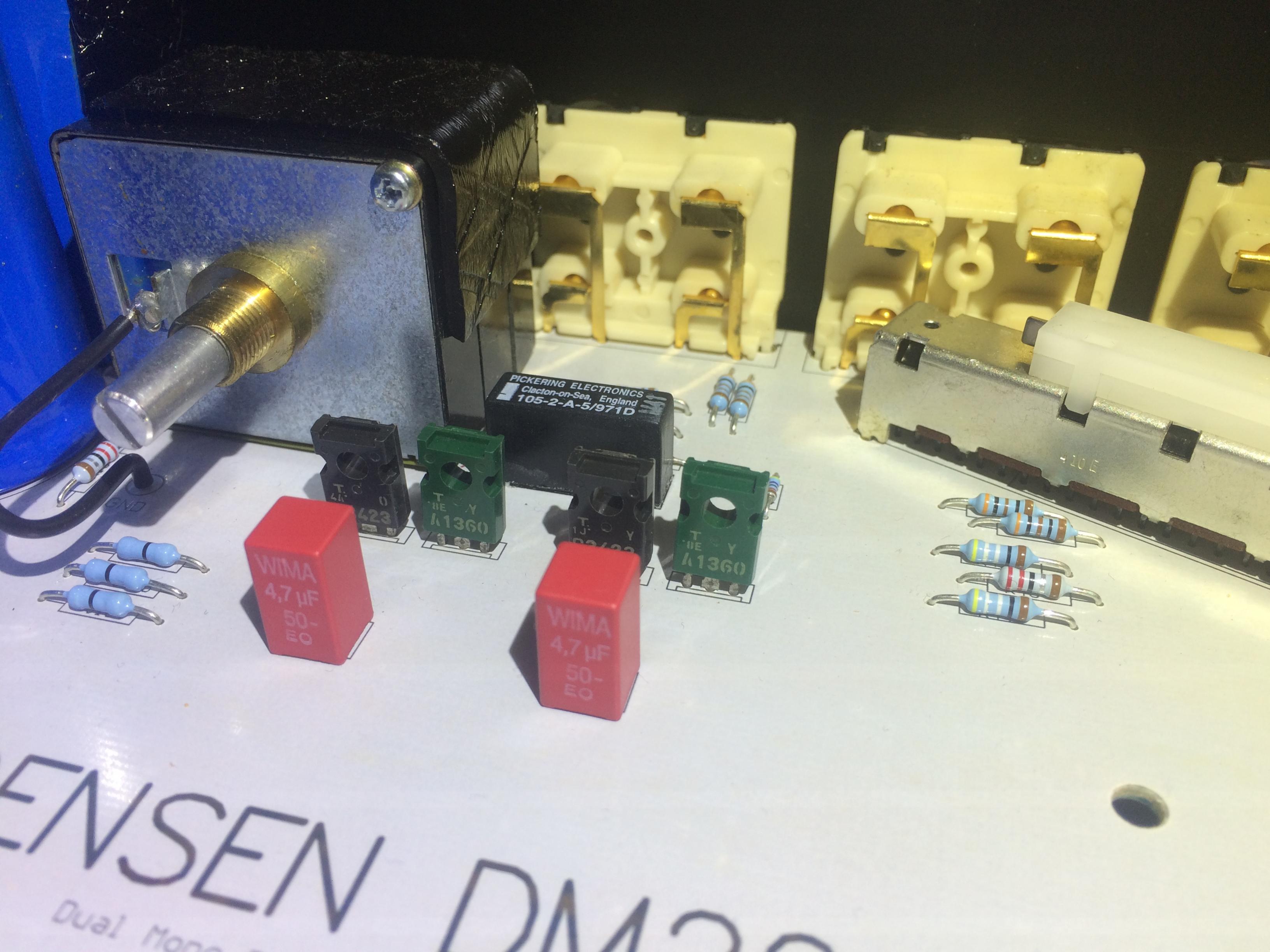

yesterday i was at a friends house, he has a densen pre and power amp. dm-10 dm-20.
after a few hours the amp started to smell. for me it smelled like a leaking cap, but after opening, it might been a resistor. what do you think guys ?
the main filter is on a small print, i can see the back of it, but not the rifa cap itself...
the owner is dropping it off at my place, so that i can look for myself. he made a close up of the resistor and it looks fried. i wonder why that would go. never seen a resistor overheating without a reason.

There is something gungy on the resistor but the resistor body itself doesn't look discoloured.
I wouldn't like to say on tbh. It would help to perhaps see what the resistor does on the circuit. There looks to be bit of discolouration on the pcb at the left, but not at the right.
Could something have been spilled into it?

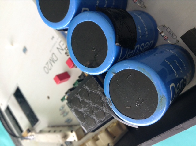

Change all the electrolytics in both the preamp and power amp their old enough to start giving trouble, the resistor could be part of the power supply and a bad electrolytic cap is overheating it. And yes it could have something spilled into it, but use this opportunity to get ahead of future trouble.
both the power amp as preamp is coming over.
i have a capacitor and esr measuring tool.... i will measure the caps...
it could makes sense to change them all; they are at least 19 years old...
anyone with advice on what to replace them with ? just looked around
nichicon dubilier mundorf ... 5000uf/63v (for the preamp) double for the power amp.

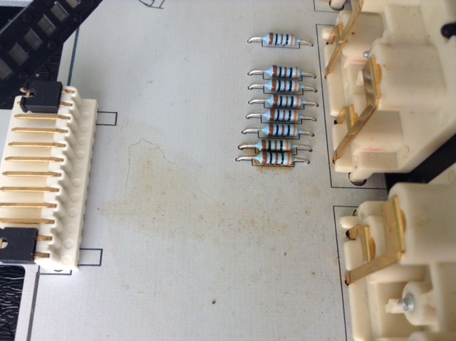

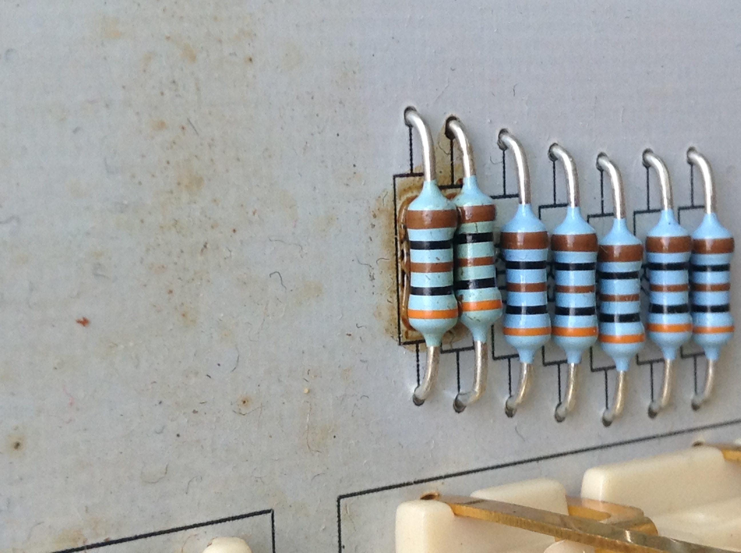

the preamp has left the building. all the resistors you see on the first post photo are input resistors of 301 ohm directly after the cinch connectors. they all measured 301 ohm.
the first two had some brown fluid under them. i desoldred one leg of each, i wanted to see how the underside looked... they looked fine, (i left them one leg loose, cause the owner only uses 2 inputs).
i put a bit of toilet paper on the brown stuff and i was surprised that it soaked up immediately as a fine brown fluid. it must have been there for at least 15 years (it is the first time the amp was opened up..
a few questions arise
1)what was it ? (must been something that can stay fluid and not evaporate within 15 years) has to be some kind of oil; to me it remembered me of some very fine chain oil.
2)why the smell: the resistors don't heat up, or was the fluid acting as a conductor and heated up ?
(still it's strange, since it is an input and the input signal is not that powerfull... so i checked what was connected: a MF X-CAN preamp tube... and that was doing just fine, voltage was fine, no DC..... so not really an aswer to what caused the "heating up" of the fluid...

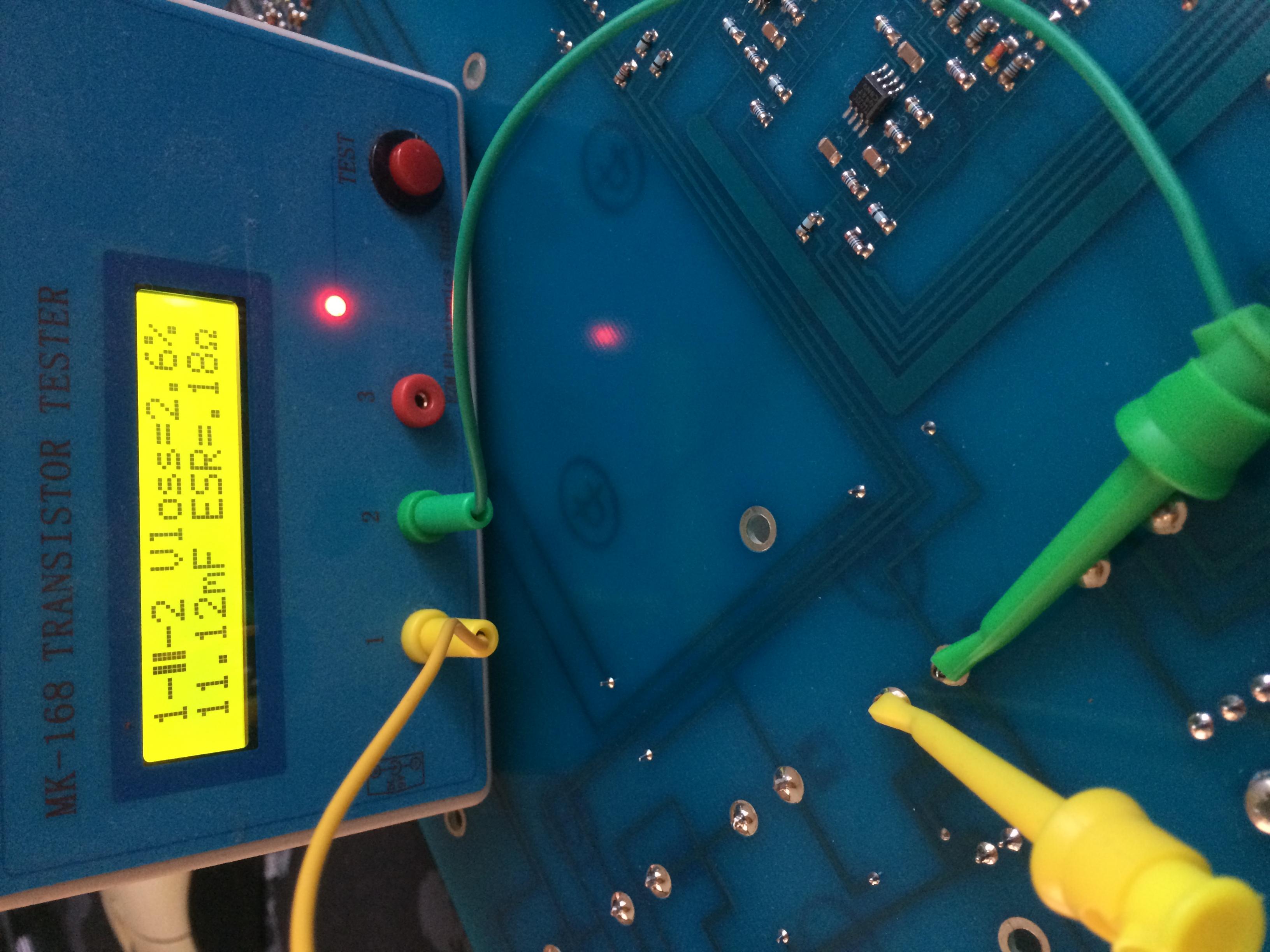

i checked all the caps too,and they were fine, very fine; so i left them in there. i guess that within 5 years i might change them in this preamp and the poweramp (which all looked fine)
11.26mf 0.18ohm Vloss:2.6%
11.39mf 0.17ohm Vloss:2.3%
10.83mf 0.18ohm Vloss:2.9%
10.84mf 0.18ohm Vloss:2.6%
11.12mf 0.18ohm Vloss:2.6%
11.01mf 0.17ohm Vloss:3.3%
12.09mf 0.16ohm Vloss:2.9%
12.17mf 0.18ohm Vloss:2.6%
