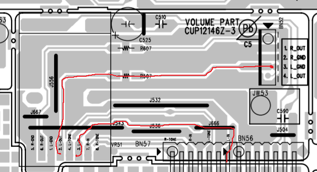

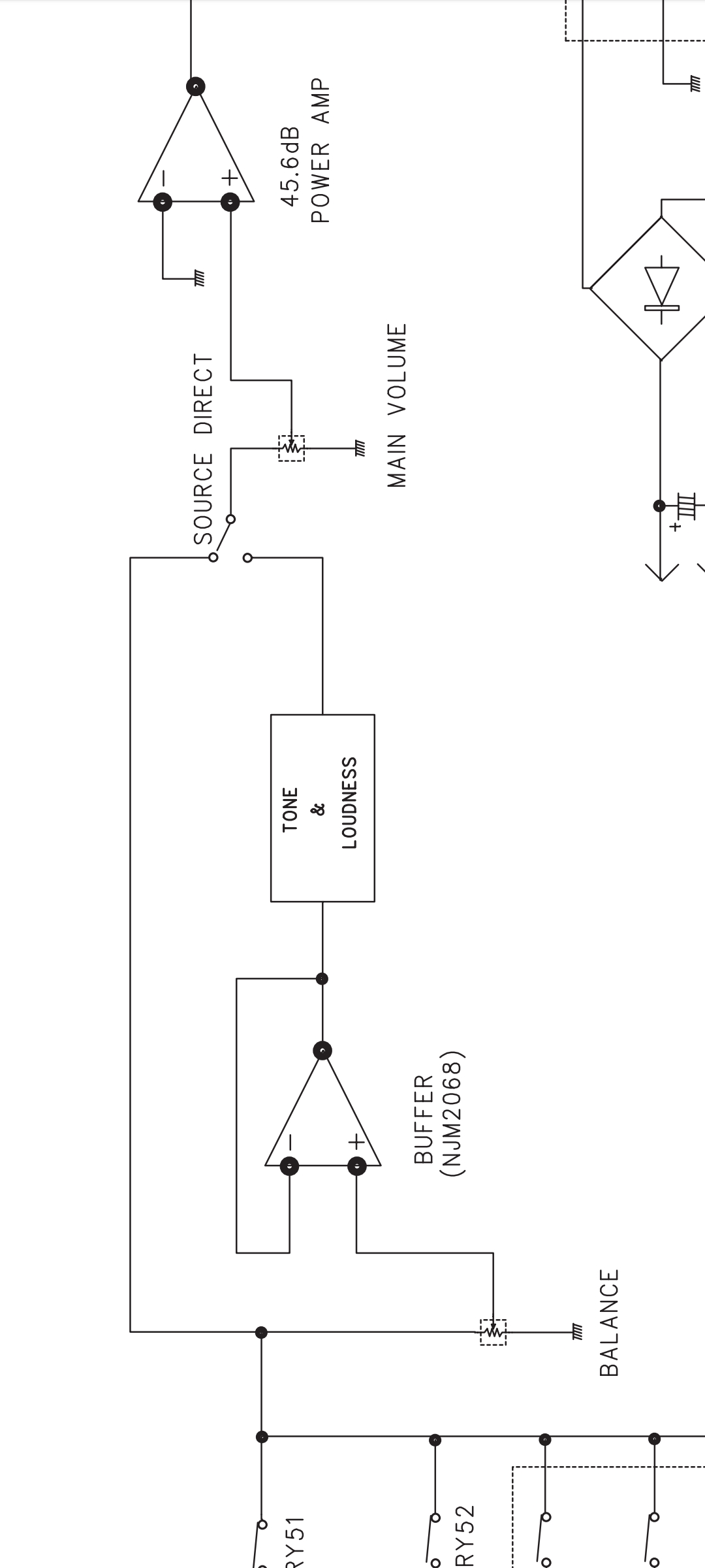

Ok. Got this Denon pma 510ae amp. It has a low static (white/Pink) noise in left channel, But the music sound fine otherwise. So easiest to hear the noise when there is no music playing. The noise changes when turning the volume knob. Most noise is at about 1/4 volume and 3/4 volume. But when turning on source direct the noise rises more and more the more volume i give it. The signal path is separated in three sections. There are the input section on the main board, and a volume and bass treble balance aso on the front panel PCB connected by i wire . An Its the power stage on the main board. I disconnected the signal wires to the power stage and it became quiet. Its probably not on the main board input side either. I disconnected the left signal wire coming in from the input side and there was still noise. I put another pot parallel to the main pot, no difference. Any ideas what could be the source of the noise? Is it The tone controls?
Attached the service manual and a image that shows the area that might be problematic. I think I will have to take the amp apart to check bad solder joints. But all I have seen so far looks shiny and nice. Can The tone contol buffer somehow distort the signal even if its not in the signal path?
Btw. It does not matter how i turn the balance or tone contols. The noise is the same.

I also disconnected the left signal wire coming from the input section on the main board, but keeping the gnd and right signal. And it didn't help. However it's still a resistor and an input capacitor in the signal path after the wire from the main pcb. From that signal goes stright to the source direct switch and then on to the volume pot.
I can try to ground some signal nodes to see if thats gives me any clues. Thanks for the suggestion, will do it tomorrow.

could it be the RY52,
just short the pin 3 & 4, and pin 5 & 6,
see if noises go away..
if noises persist,
lift up one leg of R239 0r and R240 0r to cut power supply to the IC20 TL9164, ( use CD, direct..)
and see if it help...
I grounded the left channel signal path before the volume pot and the noise remains. When I ground directly after the pot the noice is gone. So I guess the pot needs a replacement. They doesn't seem easy to find 🙁 Part number CVV9Y13B503Z
If i short the signal before the pot there is still noise. So the noise must come from the pot or after it?
But there is also a 1k resistor after the pot. And when I shorted the signal before the resistor the noise went away, as it should.

Dont know if I misunderstand, I flipped the signal wires after the volume control going in to the power amplifier stage. And the noice remained in the left speaker. Same channel as before So I would think the noise is generated in the left channel of the power stage.
