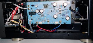

I have modded a PMA2000 for a friend (don't remember which version).
The internal (transistor) preamp is VERY bad and throws away the baby with the water.
The power amp is quite good.
There's a switch in the back pannel to use the amp as a power amp.
First test I did was to switch it on and test a simple passive pre with an Alpha 10K log pot, short interconnects.
The sound opened-up like there's no tomorrow, bass became much tighter, harmonics of the instruments appeared out of nowhere.
Realy, a half-decent op-amp would make a much better pre than the one Denon uses.
My friend was so impressed he made me bypass the internal pre, so the amp is fully functional (including remote control), but the internal motorized Alps pot is wired directly to the power amp modules.
A little less gain, but fine.
This way, it will beat the Rotel pre/power combo.
Here's a pic.

the first pma2000r used a njm2068 op amp for the pre amp,you can replace this no problems along with the phono pre amp op amp.at the time (1998) this amp was built & sounded better than most on the commercial market (even rotel) and for the price ($2100 aud)only used it with b&w speakers.power amp is good,quasi comp output using 2sk851 devices.
This one had a double op-amp on the (relay) input switching board for the phono pre.
And another double op-amp for the tone controls and loudness, right behind the front panel.
And the transistor pre.
Power amp board, left channel:

I think there is some misinformation in this thread.
The comments regarding the PMA-2000R are correct, it is not dual mono and it has a very limited preamp section.
The newer model, the 4th generation unit, PMA-2000mkIV-R, is very significantly updated from the previous unit that the poster above modified, and is the current shipping unit from Denon. Previous experiences with the PMA-2000R are not especially relevant in terms of comparisons with Rotel, etc as the sonic qualities are very different from the previous version. Four separate model updates were released in Japan, though we only received the first and last of these in the US.
The preamp section has been significantly upgraded and the overall sonic qualities are much improved. I have one of these units and demo'd it extensively against the Krell KAV-300i before purchasing, I was amazed to find that they were very comparable despite a $1000 difference in street price. I upgraded to the Denon from a set of Audiolab separates that I was very happy with.
This is easily the best single-chassis audio piece ever released from Denon for the US market.
