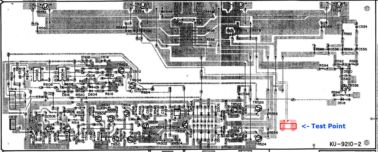

DENON PMA-1560 IDLE ADJUSTING BIAS
At least read the values? They should be something around 30mV...
You have the test points (T.P.) in board
thanks finally in perfect English. Now compare the tensions. I do not understand how to measure one side and within 10 seconds of each other? I have to use two voltmeters or as a means for marantz measures taken in parallel? or do a first channel and then the other by turning off the amplifier to cool?
done all the correct procedure here.
all the trimmer counterclockwise to zero, no speaker connected to all switches off. measure the voltage on tp and take it to 8 mv. 10 minutes go check that it is still sent to 8. So send 1khz and raised approximately at 9 o'clock the master volume up to about 11mV read you will see that at a certain level back to 8mV. stay in between max and min and then act on other trimmer and bring to 30mV. thanks to all
