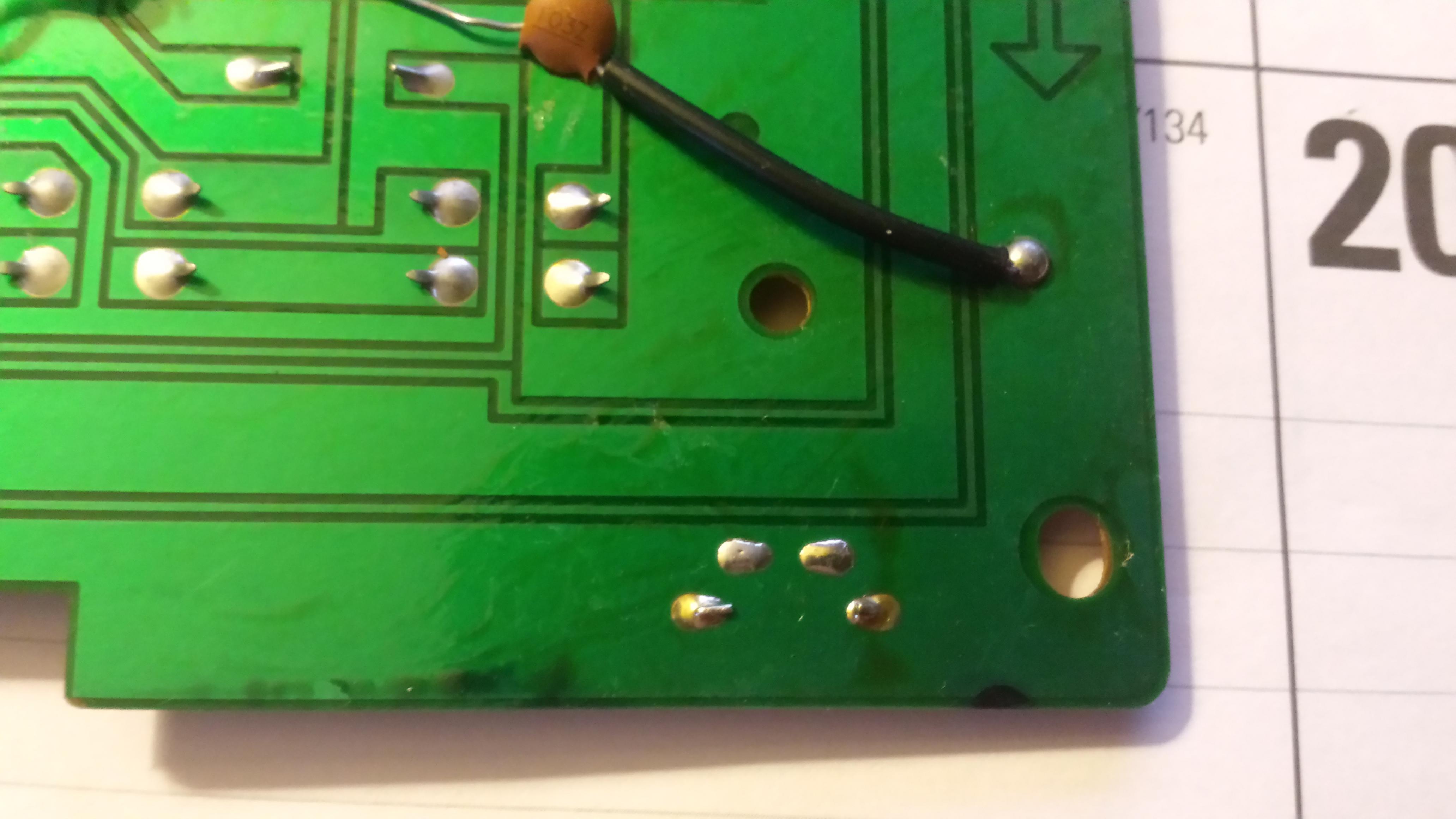

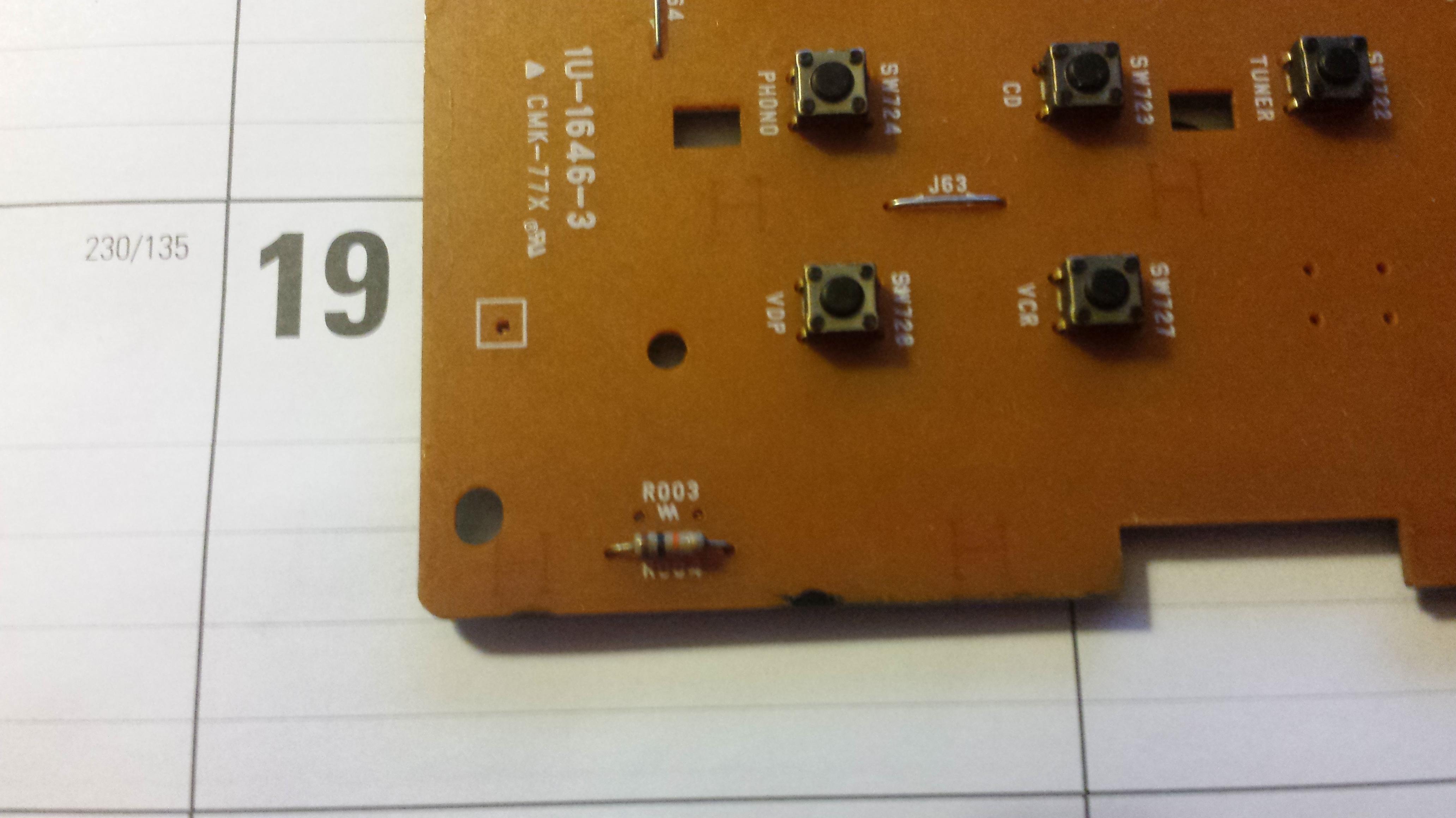

Here we have R004 going from, uugh? ground to ground? lol

SONY also do this things. What is the purpose, BTW?
Thank you.By mounting certain 'dummies' mfg can read PCB version. Resistors are cheap...

Generally these are places so the value can be machine read on a test rig or similar, you are always going to get 0R with that set up.
NO, it is used as a spacer on the edge of the pcb so that the pcb stays clear by that distance from whatever, may be front panel in this case. I have another post with similar purpose resistors.

Yes done that with SMD resistors to support a display, far cheaper than a bespoke mechanical alternative.
