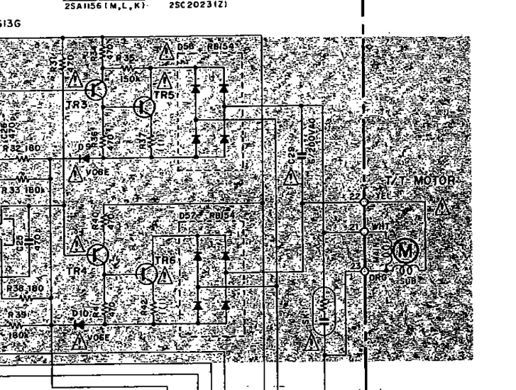

Since it is a 2 phase AC motor can it be powered by Bills multi phase PS?
There are 3 wires going to the motor showing 2 coils. I will try and post a snippet from the circuit diagram.

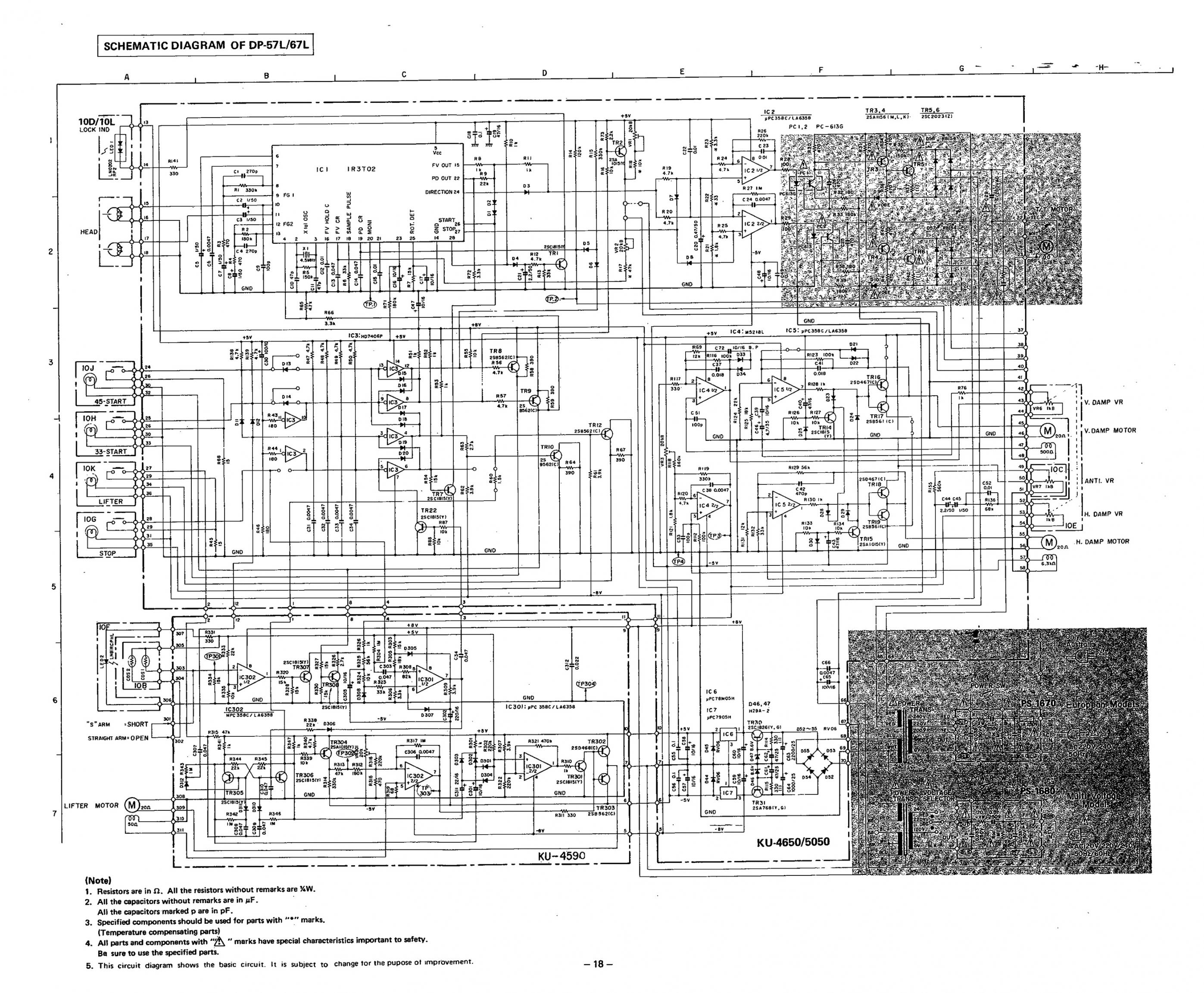

I did try to upload the service manual but it is too large and I couldn't extract pages as it is locked. It is on vinylengine.
The section around the motor of the circuit diagram is dark. the rest is OK.
kffern
kffern
I was able to clone the schematic page. Still working through the design, but it looks to be a farily standard PLL control. If the speed is too fast, that would indicate there is a reference signal (crystal) but no feed back signal. There are alignment diagrams as well as sample waveform graphics in the manual. Have you tested any of those points?
