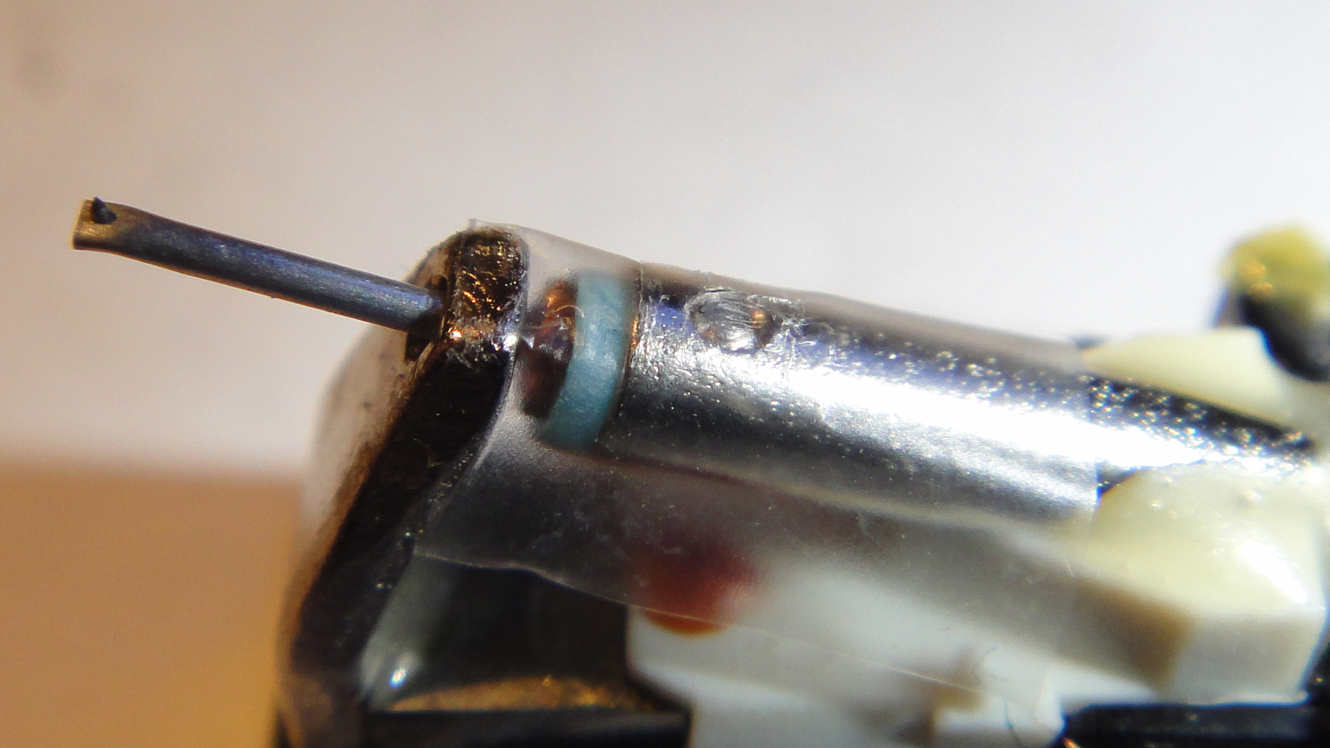

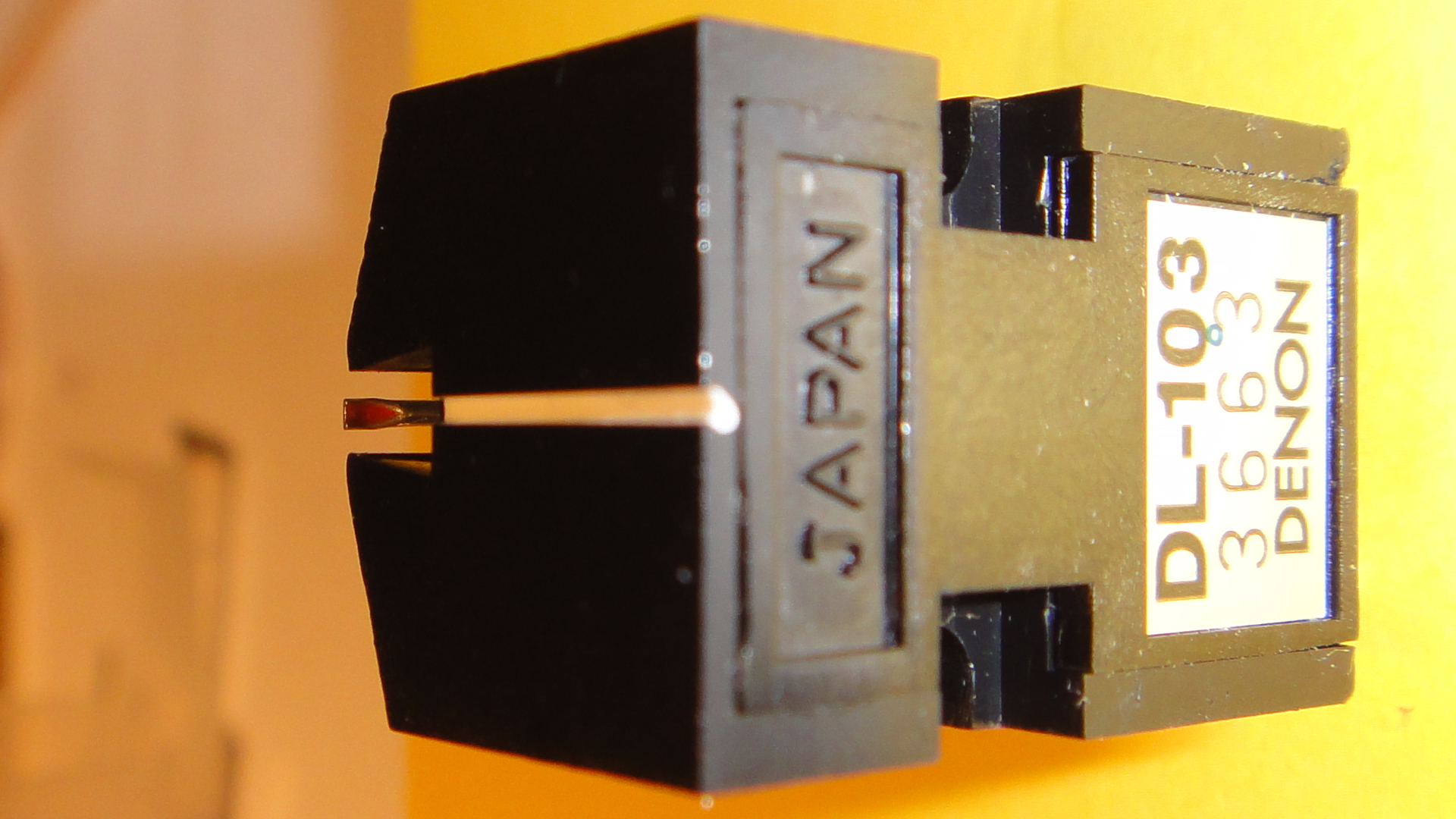

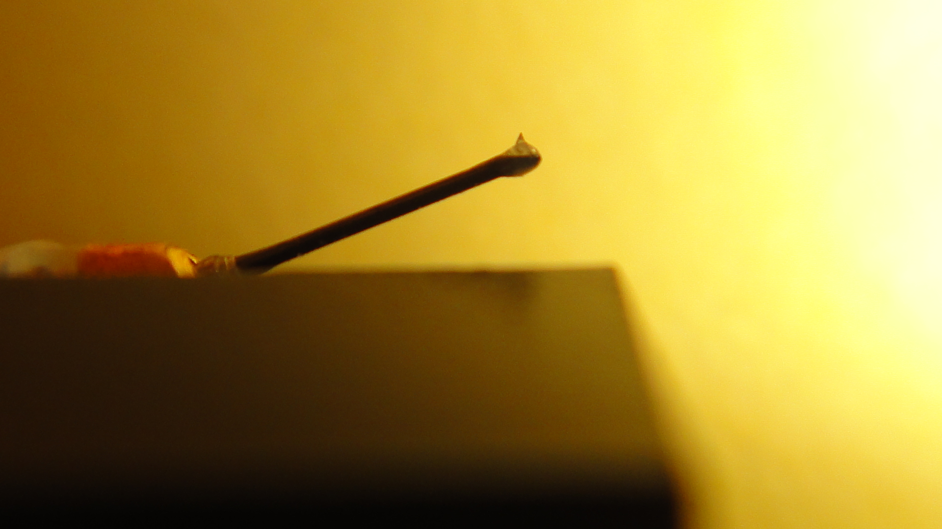

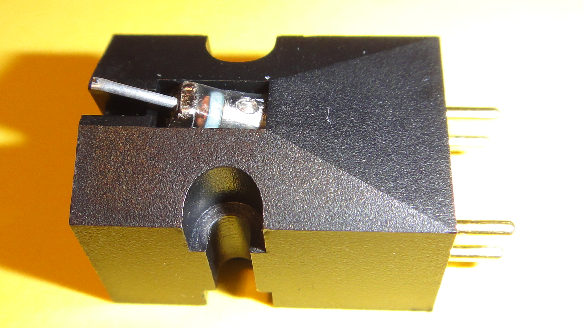

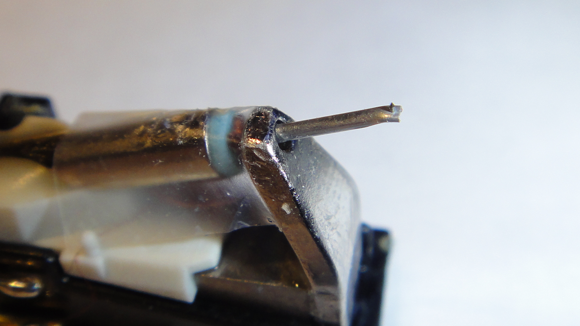

With the approval of the owner (who is a diyaudio forum member) I would like to share some photos of the famous Denon DL-103 and 103R cartridges.
Both of them had broken cantilever, but luckily the coil and the tension wire did not get damaged. I've never broken a cantilever so far 🙂 so I believe that these should get a huge shock from one side.
Interesting that most (actually only a few) Denons I have seen so far with broken cantilever were similar to these ones; the cantilever broke off at the same point.
As I mentioned these should get a big shock so I was suspecting the tension wire to be damaged but these cartridges withstand a LOT!!!! Very well built cartridges in my opinion.
Paired with a boron cantilever and FG-II or FG-S stylus it can become a favorite for many people.

If this is not the right place to share these photos I really apologize for it and please move the thread to the correct place.
Thanks for the pics!
Well, you know that this is against the original construction of the 103? The 103 was originally developed to allow some tracking distortion cancellation by an optimum combination of a spherical diamond and generator. In case you read german, there are very insightfull articles of Reto L. Andreoli who goes a bit into detail!
PS: therefore, I would also expect the 103R to be more than simply adding a new elliptical diamond (beyond the fancy coils etc.) to the stock 103.

I would not like to start an argument about it as different people have different opinion, ears and musical taste. On the other hand if you check the internet there are companies that deal with upgrading the DL-103R with wooden or metal housing as well as upgrading them with ruby or boron cantilever. In my opinion the Denon DL-103R paired with boron cantilever and FG-S or FG-II tip sounds wonderful. This is of courser my opinion.
