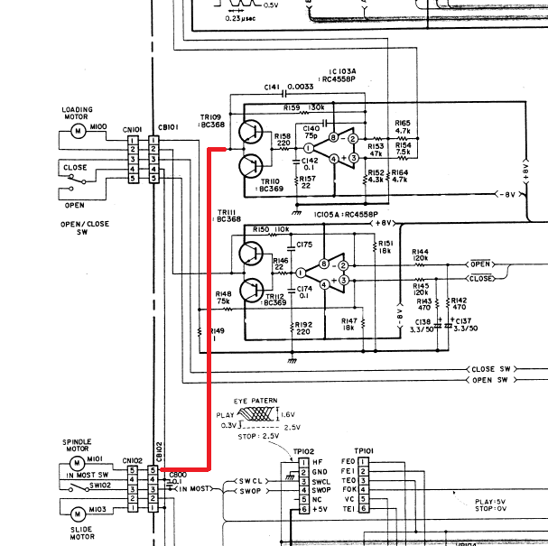

I been given an old Denon DCD-595 CD player, in very good external condition. But when I load a disc there is no spindle movement, not even a jerk.
I can see the laser lens moving up and down when the tray closes.
I found a copy of the circuit, and traced the spindle drive to IC103a and the rails are good, and if I short out the op-amp inputs the motor starts to run.
I don't know much about CD player, is the unit looking for a laser signal before it spins up the disc?
Any suggests on what to check.

My parents DCD-590 had the same problem. I took the cover off had a look played with the clamping mechanism, and (whilst the power was off) gave the disk a bit of a spin.
When I powered it back on the cd spun up and correctly showed the tracks and played fine.
I don't know whether I freed up some stiction in the motor, or whether perhaps I bumped a sensor, but the issue was resolved.
Tony.

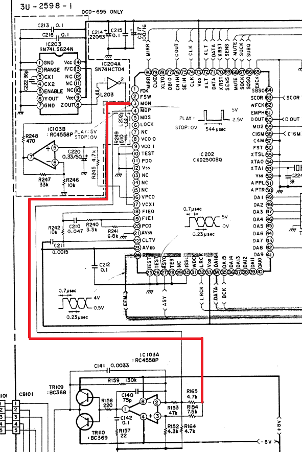

Thanks for the reply.
I've forced the motor to spin up shorting pins 2 and 3 of the op-amp, and it spins fine. Is you follow the input to the op-amp it is marked:
5V = PLAY
0V = STOP
See attached image.
So I'm thinking the controller is not spinning due to a lack of signal?

Can you trace where pins 2 and 3 go to? I suspect there is a limit switch , may be on the tray mechanism, or on the door perhaps, or possibly on the clamping mechanism. Something that won't spin up the motor unless it is sure that everything is where it is supposed to be.
Does the display come up with the number of tracks etc when you spin up the motor?
Tony

The pickup first needs to find focus on the stationary disc and only if that is achieved will the platter spin up. Its worth checking the height of the platter and making sure its not moved. Very unscientific but you can hold a CD (or bit of broken CD) close to the lens as it performs the focus search operation and fool the player into thinking its found something reflective.
50:50 it could be the pickup (is it a KSS240 or KSS210 type?). Just because there is red light present doesn't mean the laser is OK, the laser diode may just be functioning more like an LED if the diode is faulty. A laser power meter would confirm that.
Beyond that and things get heavy fault finding wise
