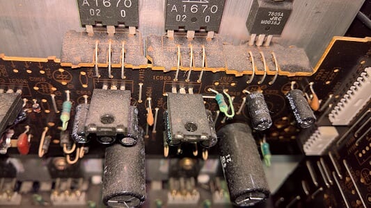

Denon amp that I am trying to repair. It was working fine suddenly it stopped. No more sound. Once in a while comes on , if the receiver is on for sometimes. I am not sure what to change. I guess it is in output stage. Do I have to change the output transistor or it just some kind of relay?
when I turn the receiver on, the power/standby light blinks 7 or 8 times and ralay clicks. But no sound. Please give some input so that I can fix the amp. I am really into it. Any help would be appreciated.

Check for DC on outputs.

does the display stay lit? if so, have you tried changing surround modes. if you want to bypass the DSP, put it in EXT IN mode and feed signal in through the EXT INPUT jacks on the back. if it works fine that way, you probably have a problem with the DSP board or one of the power supplies feeding it. +/-15V regulators are a common failure item in Denons

Found the problem!
Thanks for the tip - the denon AVR-2800 doesn't actually have 15V regulators but I found that the 5V regulator (IC903 as shown)
This seems to be a common problem and the 7805 used by Denon - over time and with heat the IC loses the ability to regulate and the 5V line sags to about 3V, usually the voltage will slowly rise to about 4.5V and the DSP board starts working again.
Replace this with another 7805 IC and the Amp works flawlessly. Do not be tempted to replace with an 'equivalent' 5V regulator as the 7805 forms part of a tuned and cascaded regulator and any mismatch in characteristics causes the entire 5V rail to oscillate.
