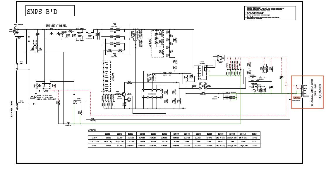

Ok,
I found a schematic on line and here is the smps. I replaced c901 and it powered up once. then nothing. I seem to be missing the digital supply power at CN903.
I seem to have power across where C9004 would be but there is nothing across the top258 (IC901) pins 5 and 6 where I would expect like 58 volts or so?
Am I on the right track with this? Any thoughts or comments would be appreciated!
Thanks,
Jeff

All I know is something on that board has failed. On the yamahas it is a cap failure. So if you have a cap tester, test every cap on the board. The only thing you have to lose at this point is the time doing it. Are you thinking the ic is bad or something?
Thanks for all of the reply's so far, I think that I am getting somewhere. The .01uf 250v caps in the switcher are at 8 nf (.008 uf)
I am continuing to check these chiclet caps, but I am wondering if this is causing the SWM to go into auto-protect and that is why I don't have a standby power.
