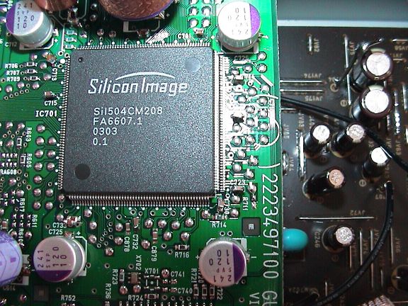

It has a silicon Si 504 for I/P conversion and ADV 7300 da for svideo and component. Sound is decoded by a analog devices melody 32 bit dsp and da conversion is done by 3 burrbrown DSD/PCM1790 (cant find data sheets on these) and opamps are a 2068 type and ad825. Not more then one pair in parallel (balanced) and another for buffer.
Regulators are your average 78xx and some sharp lowdropout version for 3.3, 2.5 and 1.8 voltages

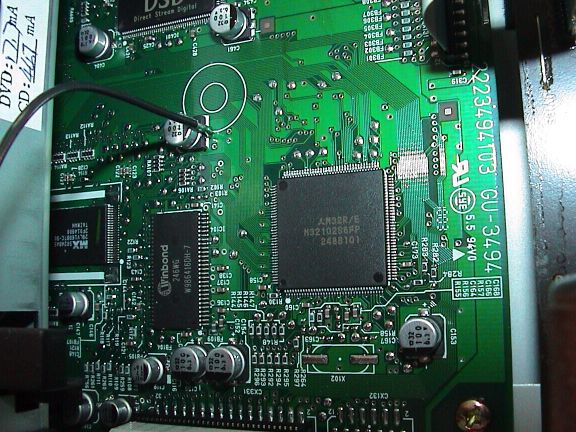

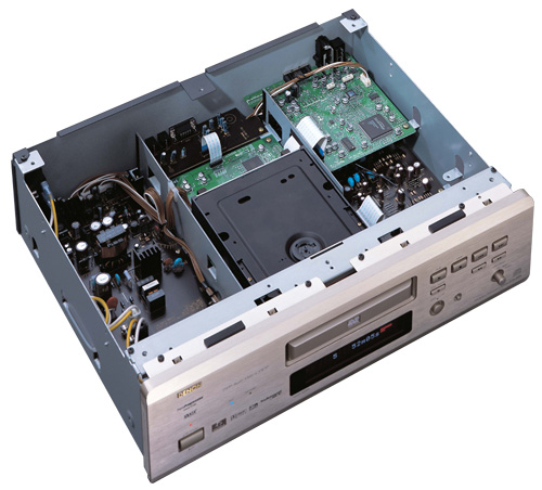

Thats it,
The two boards in the left section are the video and audio boards, the upper one is the video board and contains all processing after the mpeg decoder.
easy to get to in other words.
Looks very promising - am I right in thinking that the power supply is a SMPS and that it's replacable (should I want to make a linear one instead for example)?
It looks like theres enough space in there to beef up the PS a bit - if that's the PS on the left of the picture?
Cheers again for the post - nice player.
I might do some closeups next time mine gets taken apart.
Yes the ps is on the left and it is a switch mode supply, lots of space to beef up..hehe.
The A1/9000 has the same switch mode supply for all functions but the audio and video analog supplies.
I quickly found that I needed to beef up the analog video supply a bit.
Have not touched the audio side yet, still trying to figure out the best strategy.
It gets pretty hot and to much tweaking without considering heat dissipation could potentially get you into problems.

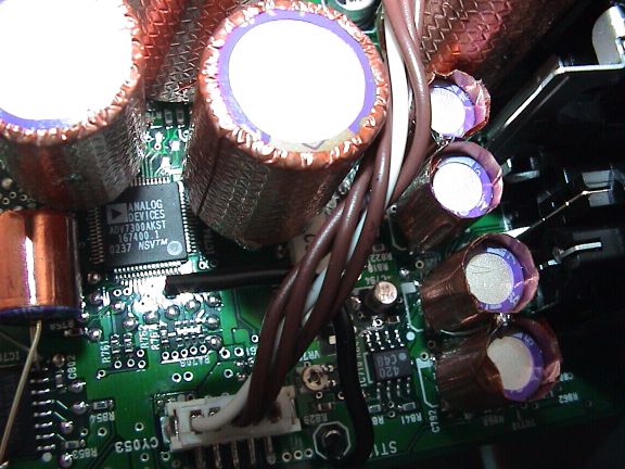

This is the video da, filters and buffers for progressive component out.
All of the DA powersupply has been decoupled by a 1000uF Oscon on each supply ie analog, digital and interface supplies.
The analog section is getting a bit of help as well, besides adding 2*10,000uF there are also a few oscons close to the chips and some more stuff but it don't show on the pics.
