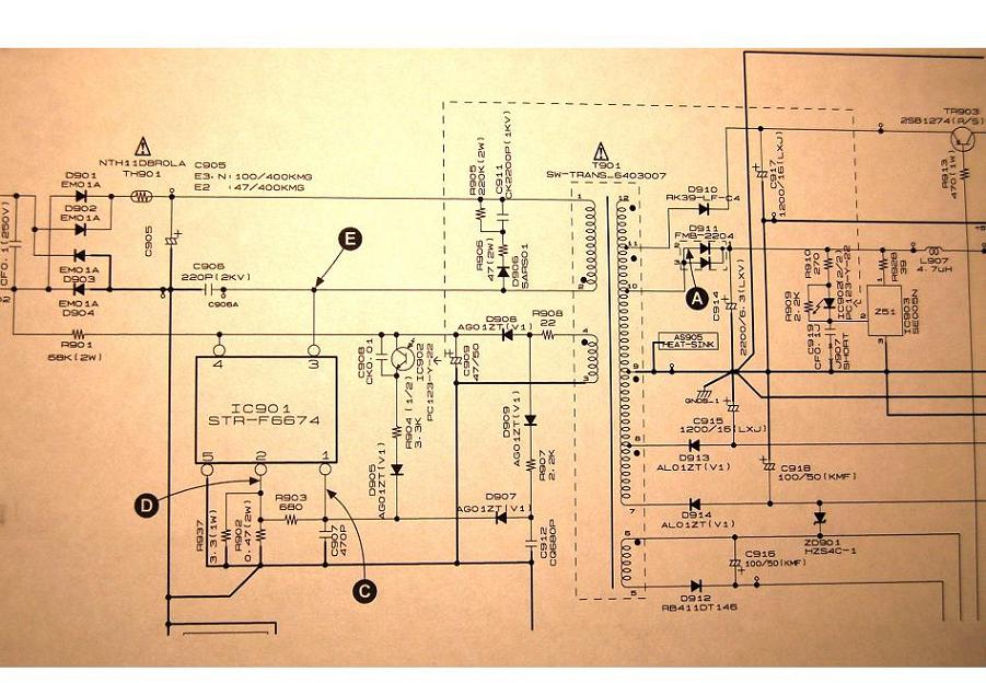

good to hear that a clock upgrade will be beneficial. I will be looking at the player again after I complete my present project (a turntable rebuild). The upgrade involved replacing all of the capacitors with Panasonics (I think!) and 5 diodes replaced with much beefier items. I actually got the PSU done professionally despite having the skills myself because I was very busy at the time.

Simeon wrote:
Please be more specific- were these the diodes before(D901-904) or AFTER the Switching Transformer (D910-914)?
I am attaching a schematic diagram to help specify...

It was the four rectifier diodes and another of the same type close by.

I just learned from another member that the diodes to change are D901-904 and the cap, C905 may also be upgraded to Black Gate or other high grade, high voltage, Low-ESR type.
