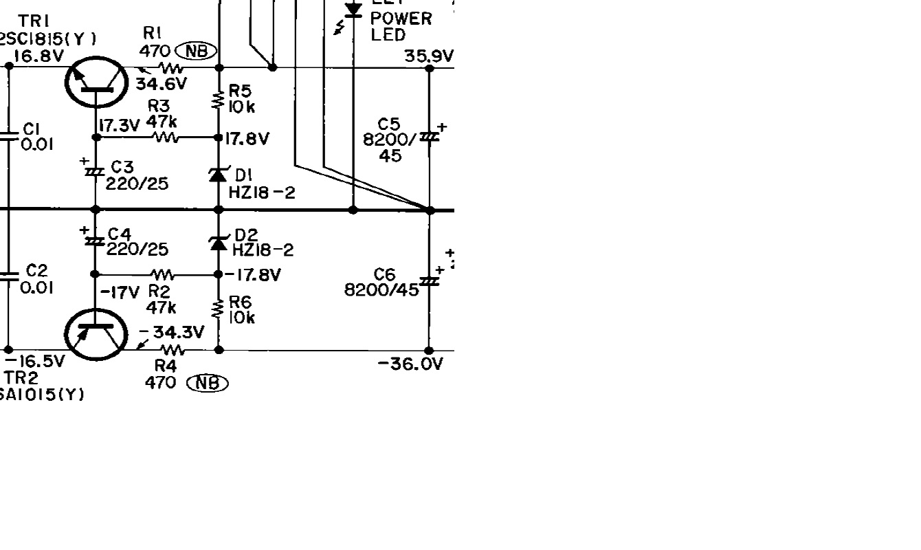

Okay, I have a symmetrical supply regulation area, turning 39-0-39 DC into ~+/-15vdc. Its done with zeners and a pair if transistors that have developed cavities.

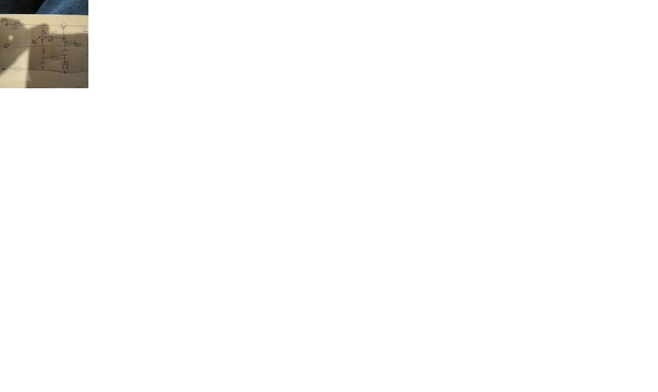

5 hours and many ring pulls later, the clock says 4:20 and I have a plan.
The 4.6M resistor is huge isn't it? These expensive transistors must have quite some gain I'm thinking.
The stock 250 model, and others, use the exact same circuit layout. The 250 uses transistors I can get pairs of for £1 so £2 gives me two shots at this. I need to swap a few resistors (all of them, but it's still a few) and I'm not sure my zener can be much smaller than the 0.5w typically found doing this duty.
I will pause for thought, and see if I get peer 'correction' then order away 🙂

Indeed, it is...The 4.6M resistor is huge isn't it?
It's also NOT an E12 value and is wholly inappropriate in that position in your supplied (reverse-engineered?) circuit diagram (from what I can see - the image is too small).
N.B. Most Zeners need >5mA to Zener properly.
The -ve rail Zener is upside down!
Copy that circuit...The stock 250 model, and others, use the exact same circuit layout.
Adjust R1 & R4 for the appropriate voltage drop.
Good Luck!
Hello Hamish. Thank you for the reply.
I must admit the -ve section mistake is all mine. I just sketched that half of the circuit in quickly, so people could see it exists.
Oh it's 4.7K, Yellow Violet Black Brown gap Red. I just metered the pair which is what I did before, but checked the colours for an extra layer of confirmation. It's my micky mouse volt meter. Auto Ranging on me. It does ac/dc to 20 amps. Frequency+duty. Temp. hFe. Caps+diodes. min/max. Bargraph+hold. Seems great, and gives the accuracy of a decent Fluke. It's going in the bin soon though. It moans about being on for 5 minutes, then shuts down. Even in use. Then auto ranges and makes me feel an incompetent fool. It's the first and last time that will happen. It's 'hammer time' soon.
Obviously 4.7k and 1k, I don't even need to look. That says my zener is high enough power for the circuit, if using 10k as I intend. I ordered the transistors and actually got 5 of each for £2 delivered, so that's made me happy.
Next I might be changing the 4565 op-amp in the tone section. It's all this regulator supplies now the phono stage is isolated. It's not the original and may of fried. I'm not sure what the original is though. The next stage along uses a 5532, as did the phono stage. Where it was flanked by new capacitors, but did scream loudly. So I won't pull that out, but I think a 5532 is my best option.

What is R1 even for? It's not in any other example I have seen. The transistor looks quite capable of taking lots more than the main rail voltages. The resistor barely drops any voltage at all, but it's quite large at 470ohms.
Well built as per the drawing, it's not right somewhere. It takes a full minute to climb to 16.4v
edit: I think maybe it's right? I'm waiting for the 220uf's to charge through 57k. The zener has 17 across it almost instantly. Must I learn about timer rates... I didn't go to bed last night.
rc calc says 63 seconds, If I'm using it right. Which the confirmation kinda says I am. A minute to hit full voltage... It seems ages. I've set my controls, seated and pulled a can ring in that time.

Fixed 🙂
Well.. the phono stage isn't but I'm not sure I'm going to bother. I think this regulator setup is happy enough driving just one op-amp
