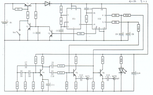

Per,
What it does has more to do with remagnetizing the cartridge,kind of rechrging the batteries and realigning the coil's fields I think.
No expert on this though.
Maybe this is more in Dice's territory?
Ciao,🙂
