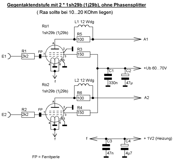

I got some of those subminis,
the 1ZH29B for output and the 1ZH24B for preamp.
There is some information about them in german. I found this schematic for a PP amp>
more info here:
Treffpunkt der Interessengemeinschaft :: Thema anzeigen - Russen-GT mit 200 mW
here a preamp that uses those tubes:
Gitarren-Vorverstärker mit russischen Batterieröhren 1SH29B - Michael Gaedtke
All working with 60v, and probably less than 500mA for the heaters.
more info here:
