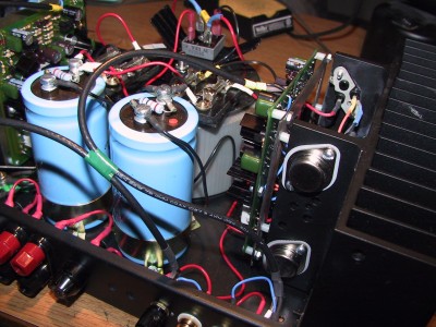

I have recantly finished my Leach amp 4.5, but when I turn it on, my 10inch basse's make a little move in, and then out again.
When i turn off, it's the same, just not so much.
I'am sure it's because of the cap's im the PSU, but i would like to awoid this THUMB.

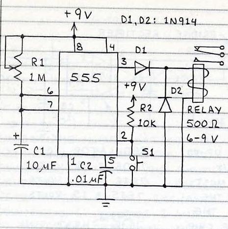

I was thinking on a circut with an ne555 or simmular, an two relay's, one for each channel for cutting the loudspeaker connection immidiatly when turn off, and delayed when turn on.
The cap's I'am using is 4x10000uF, but I'am planning to use 8x10000uF in the future.

I had some thump from mine when I first built it, so I put bleeder resistors on my power supply caps, and I don't have problems now unless I turn it off, then immediately turn it back on. It didn't seem to effect the performance at all.
Here is a pic:
More pics at:
http://brian.darg.net/leachamp-2channel/
Brian

i have that problem, BUT solved now. im building a simple circuit for turn on thump. I'm using a murcury wetted relay in each of my mono blocks that i built witha simple timer ic 555 with a 10 second time delay that way there is time to let the amp settle down.
J'

I've just re-read your post and noticed that I confused ne555 (timer) with NE5532 (op-amp)!
You could use a 555 timer for a deley on power-up but it won't disconnect the speakers immediatly on power-down, so thumps could still get through. The reason is that the power supply capacitance will hold-up the voltage rails so the 555 won't see that power has been disconnected.
I guess you could use a second bridge rectifier to power the delay circuit and just use a small electrolytic to hold-up the 555's rails for just a few seconds, say 10uF -> 100uF.
