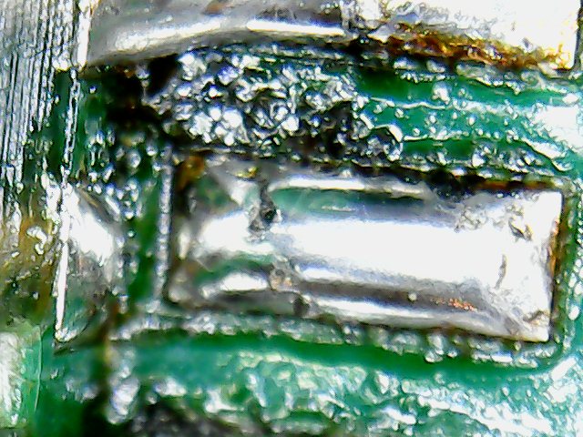

Anyhow, I fixed the other one the other day. It was the same failure. I took a few pics with a usb microscope of the connections. There were more broken than these two, but they all look about the same...
