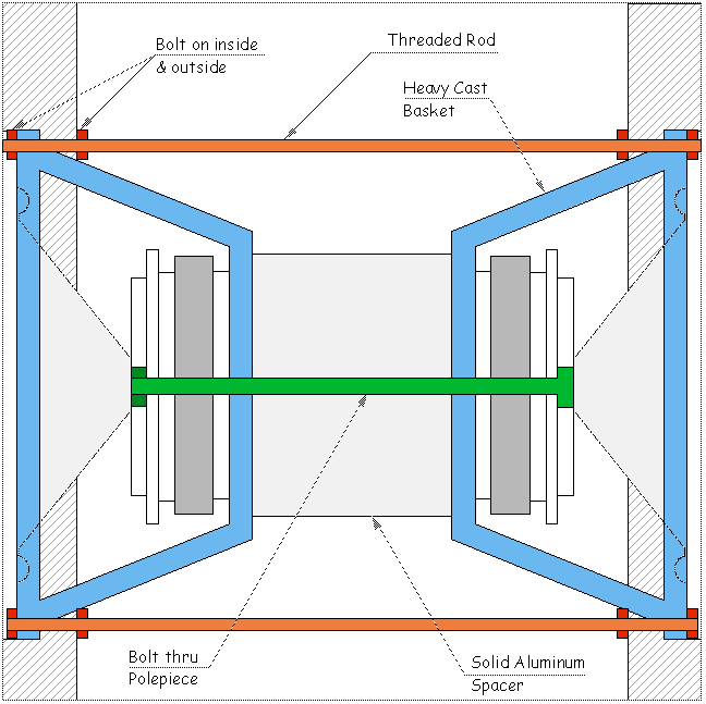

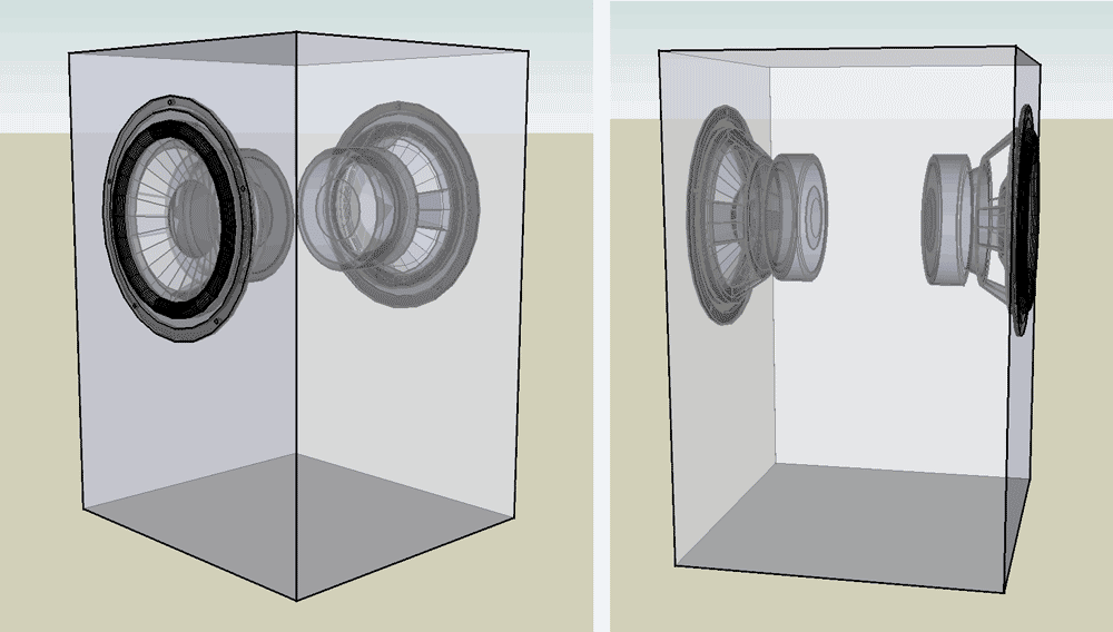

Push-push has a pair of drivers mounted in a box such that their acoustic output sums (ie in acoustic phase), but are physically opposed and tightly coupled such that the mechanical output of each driver is out of phase with th eother and the reactive forces are (largely) actively cancelled out leading to dramatically less load on the box panels. So one can use an elegant solution with light, stiff wood (we used 15mm BB), or brute force (not push-push) to attempt to achieve a noisless cabinet.
A basic ilustration (does not show the tight coupling).
This ancient thot experiment takes a pair of woofers designed to be bolted thru the pole piece of the driver to the cabinet and uses that to bolt the backs of the drivers together and the common ready-rod bolts tie the front together.
An over the top solution. Not unique thou.

Planet10's dual driver examples in post #3 would be better described as "horizontally opposed", perhaps using "push pull horizontally opposed" if one driver's magnet would be reversed direction, which would require reversing it's polarity for an acoustic output summation.

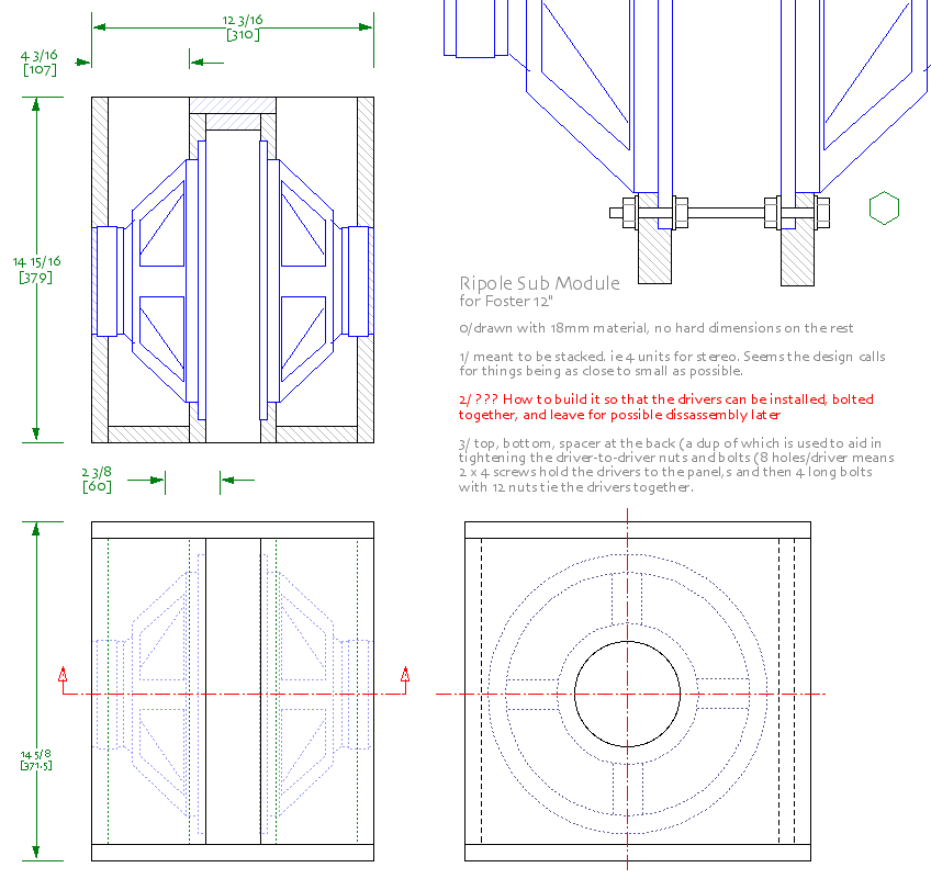

The "slot" or "plenum" or "V” shape you are talking about is just a complication. Something i have most often seen in OBs. I did a concept w visualization, Papa’s slot-loaded bass helper on an OB, the ripole.
The simpliest push-push, i posted in illustration in Post #3, (be better described as "horizontally opposed”) has the same meaning but the orientation is irrelevant.

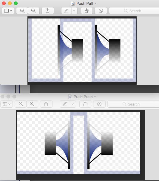

Here a more diagramatic illustration of push-pull push-push
dave

Let's make it simple. Cones move in-phase : Push-push
Cones move out of phase: Push-pull.
That is independent of cabinet alignment. Sealed, ported BP, IB, isobaric though usually for the tightest isobaric, they are in push-pull with cones facing to get the very smallest volume between possible. ( Art's second picture)
One can mount drivers opposing each other in one cabinet where the magnets are mechanically coupled. This is still a push push as the cones move in phase. Good design for several reasons and does not need to be as complicated as Dave's picture.

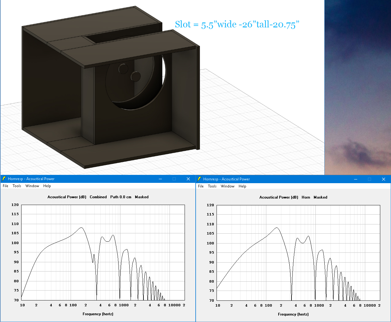

You can simulate one in HornResp as an offset horn....with a sealed or rear chamber. Its not exact because it doesn't simulate 2 drivers facing each other...but you can atleast simulate one side in an accurate sized slot....and anticipate the rest.
