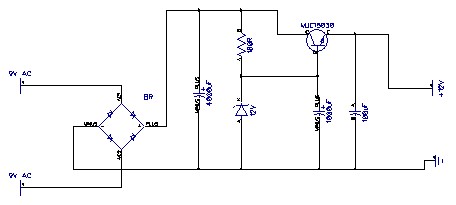

2. Take a single, passive R/C, and add a zener diode then buffered by a bulky
transistor. You first calculate how many volts will be dropped on the R (the rest will be on the zener). You then choose an R to allow you to drive the zener so that it does not get hot (5mA is very typical for little, 0.5Watt zeners). Based on that R you choose a C to achieve the single-pole low pass of 1Hz (or better). You then bootstrap a heavy transistor
capable of withstanding shorts (eg a 50W/8A transistor can definitely survive temporary shorts from a smallish, pre-amp PSU). I used the audio transistor MJE15030 which has quite high hFE, and very linear as a bonus, unlike some other rubbish eg TIP31C/BD911 etc. When you connect all your pre-amps to this semi-regulated supply, there will be like 2 dozen 100uF capacitors all eager to be charged, and they will in general blow the likes of BC639/BC337 in an instant. Additionally it is more than likely that you will inadvertently short the supply yourself, and every time you do that it means a blown "lesser" transistor. Hence the need for an 8A transistor capable of withstanding even prolonged shorts. A 100uF capacitor at the emitter of the transistor is also needed to stop oscillations that might arise if you, for example, decide to power a fan from this regulated voltage. Of course, if you can, it is 1000 times better to power fans, relays, LEDs etc from the unregulated voltage and keep the "clean" voltage just for the amps where the audio signal will flow.
3. A combination of the above: a regulated supply and local R/C filters on every stage! Assuming that you can afford a 20-30% voltage drop on the R, then you can use smaller Cs and it should not cost that much. But you will have to design the circuits from the outset - you cannot easily do it retrospectively, eg if you have planned a 12V supply, you cannot feed it 9 volts and expect it to work just as well. Well, unless your circuits are somehow immune to voltage variations, like op-amps.

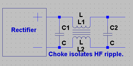

I like the idea of the pass transistor best. Try using a CFP instead of Darlington, as it will have lower output impedance (don't know about ripple isolation though, I think it's the same).
Look at the attached schematic for a simple ripple suppression technique that works well.
- keantoken

This is the essense of my approach: to design (and understand) as much as possible from first principles. My zener regulator plus R/C filters comprise of 4-5 components in total, and I have experimented and seen on the scope and heard on the speakers the effects of ripple, filters, different capacitors, oscillations, blown transistors due to accidental shorts, current limiting etc.
It would feel like cheating to use someone else's design with two dozen components and techniques I do not (yet) understand - I might as well go buy a ready made guitar amp 🙂
I attach the final circuit I came up with - nothing clever but hum has almost disappeared. I will try (to understand) the shunt regulator suggested here on my next project. Assuming I ever finish this one 🙂

That circuit, which I drew from memory is slightly wrong, there are 2 * 1N4148 on the back of the zener, to raise the voltage a bit to compensate for the drop across the BE of the transistor. I get 12.60V output from about 14.3V input.
