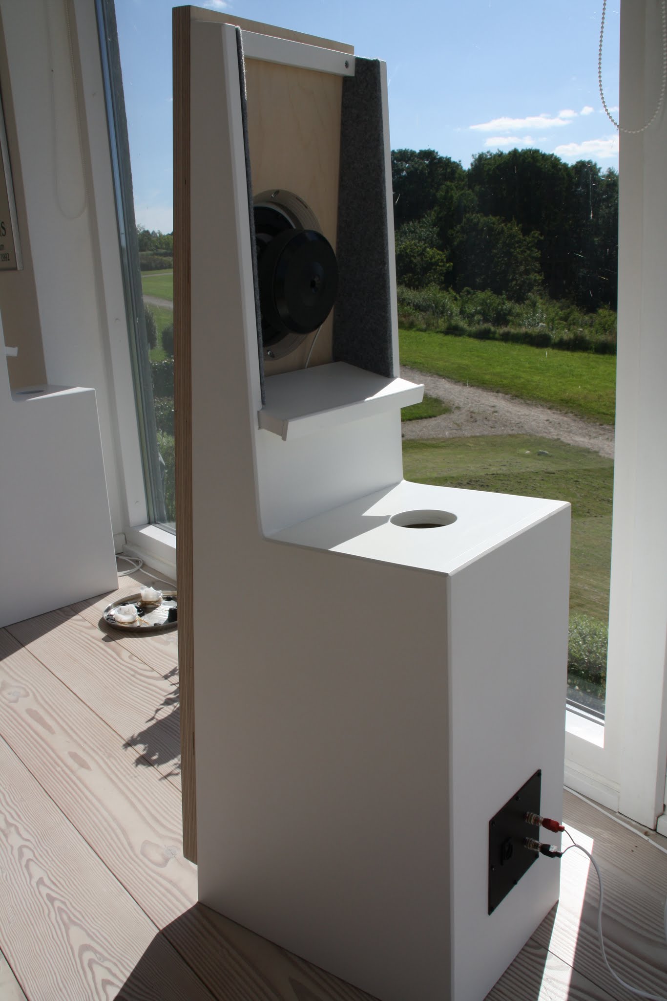

The Building process.

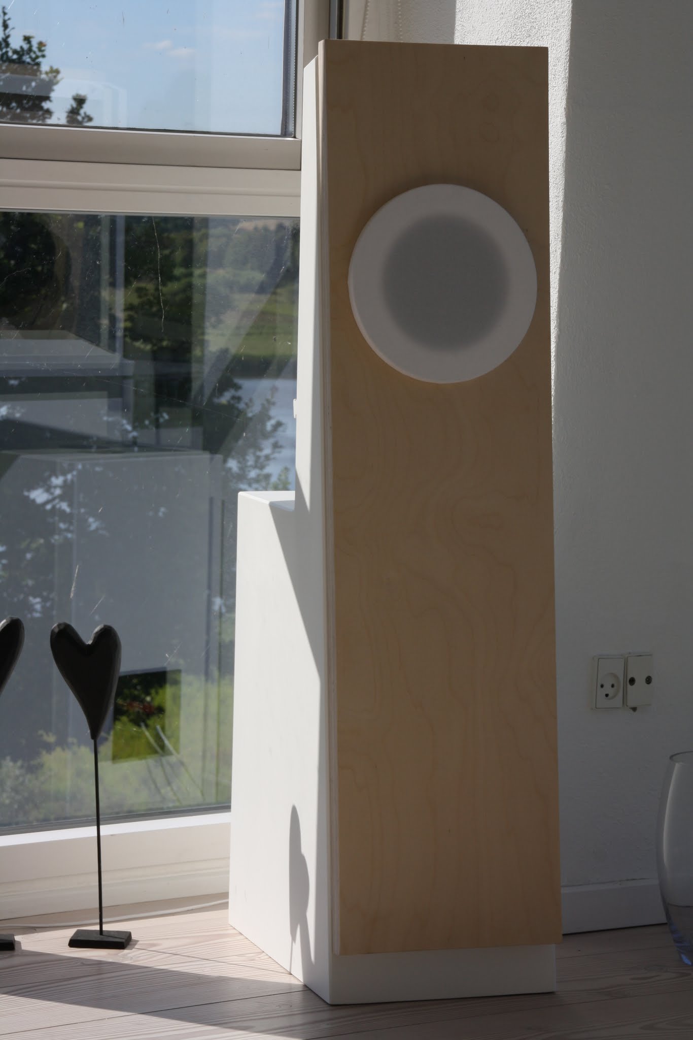

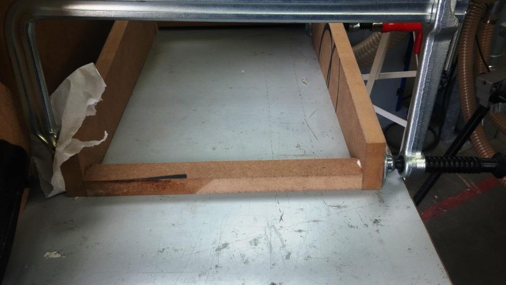

I have to start by saying that I am NO wood craftsman by any means. But I’m trying my best 🙂
This part is intended as inspiration for others who would like to build these speakers and like me bump into questions as the process goes on. Also I have to say that I made some small design adjustments and minor errors which led to some (IMHO) nice design features.
My design goals
Front baffle af birch veneer (for looks 🙂 )
Integrated microphone for bass broadcasting.
Design adjustments:
  • Front grill to accommodate different drivers of different sizes. (This was an error on my part. I cut out a hole that was too big for my Cube Audio F180 drivers, and I had to find a way to mount them.
  • Front baffle thickness: 30mm rather than 38mm. ( I already had some 15mm birch veneer at my disposal)
  • With of front baffle: 305mm instead of 317mm. I forgot to add the thikness of the edges for the front baffle. This left me with a front baffle width which was smaller than the width of the body. Rather that trying to add an edge to the front, I decided to cut off 3mm at a 45 degree angle of the sides of the MDF body sides. This way the enclosure/body kind of narrows in, to fit the front baffle. It actually turned out very nice 🙂
  • Wooden brace at the top of the body to fasten the front baffle by screws. See pictures. Later I found out that the ZOB’s on Decwares own homepage has the brace.

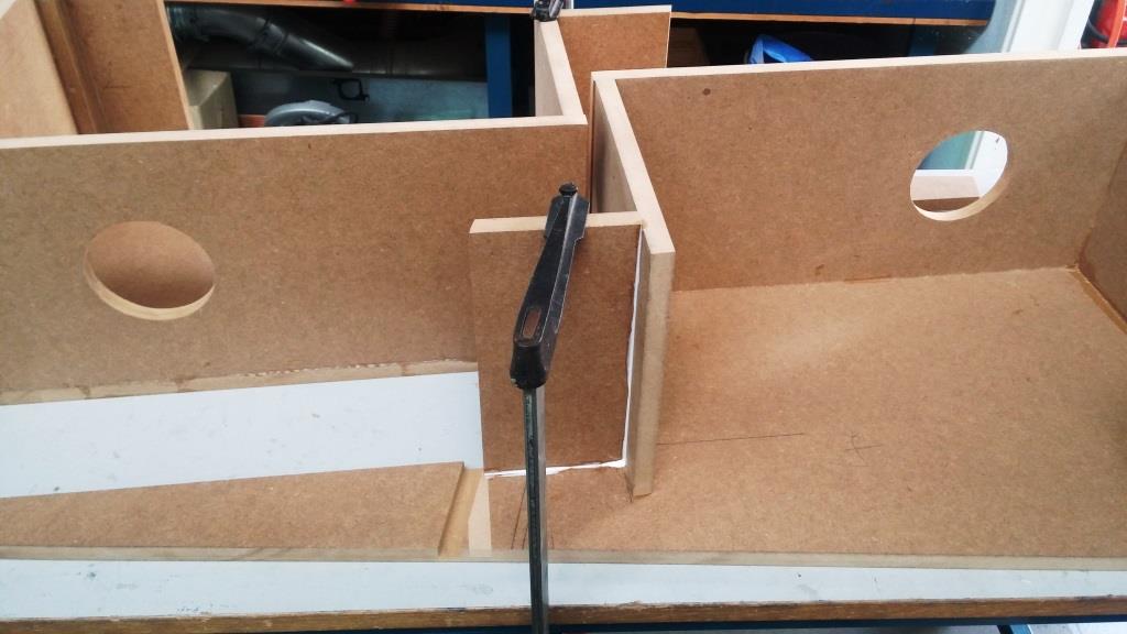

Building the speakers
First of all you’ll have to download the drawings. They are fairly easy to follow but are unfortunately only in imperial units. I live in Denmark and use the metric system. So a little conversion was needed.
I Decided to do the front baffle in birch veneer. I already had some 15mm birch veneer, so I glued 2 sheets together to get a total thickness of the front baffle of 30mm. This is a little less that what the plans suggests but I think it works fine. The body of the speaker was made from 19mm MDF.

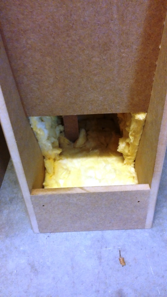

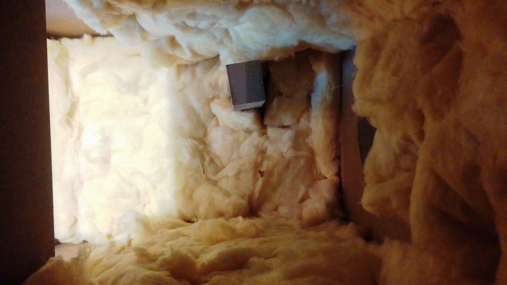

I have also posted some pictures of the damping. If someone has some comments on whether I used too much or too little, then please feel free to let me know.

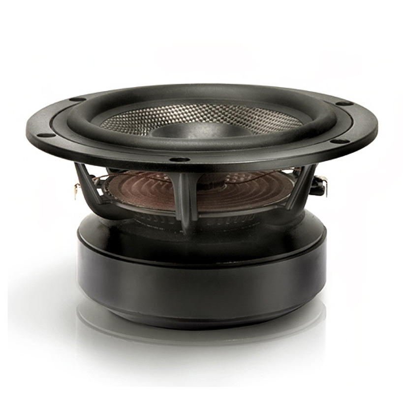

Drivers
The FRX2 Drivers look very nice, but are a little expensive, especially not knowing what the speaker sounds like. So that was not an option. The next speaker on my wishlist was (is) the Tang Bang W8-1808. I was planning to buy the W8-1808 but came across the Cube F180. It came recommended by a local dealer Alto-hojttaler and at a price tag of 850 dkr a piece (125 usd/ 115 eur). I decided to give them a try.

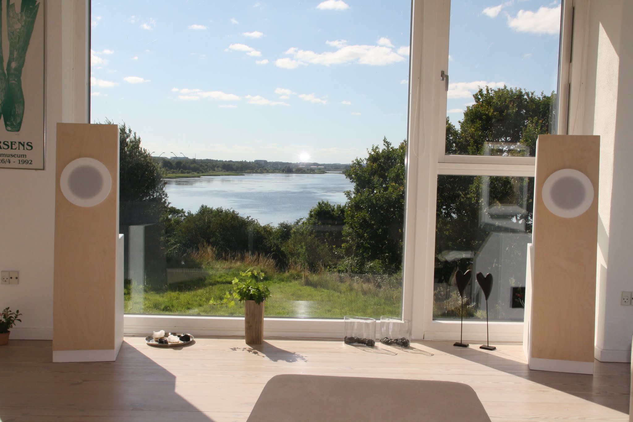

The Sound
And now to the moment everyone has been waiting for. The sound. From 150 Hz and up they are excellent, from 150 Hz and down I had expected more output. Overall they are very neutral and very detailed. The soundstage and focus are on par with anything I have heard at any price. The bass is as detailed as promised, but there is less output than expected. Positioning close to a rear wall is almost a must in my opinion.
At first I found the treble to be somewhat rolled off and dark. I raised the rear of the speaker about 5 cm (2”) to get the front of the speakers to be vertical rather than slightly pitched backwards. This makes the speakers fire directly at my ears. This helped. Now the treble is nice and smooth.
Midrange. Excellent. This is where the speakers really shine through.
Bass. The upper bass (lower midrange)say from 150 Hz to 400 Hz is lean with a slight peak at around 300 Hz. I don’t know where the peak is coming from. Maybe the front baffle which is only mounted by 4 screws. 2 in the top, and 2 in the bottom. It is not a big thing, but it does give a very slight colouring of the sound.
As mentioned earlier the bass very detailed, but lean. I’m missing the bridging from about 200 Hz to 80 Hz. Under 80 Hz the vented port kicks in and does lift the bass output, but it is still too lean for my taste. Now I have to fair to the construction and say that the positioning in my room is not optimal, for the bass output. The speakers are at least 120 cm (4ft) from the side walls, and even further from the rear wall, and I sit almost dead center in the room (I know, I know). So maybe I’m being a little hard on the bass performance, not giving the speakers the optimum conditions.
But I had foreseen this, and prepared the speakers for “live broadcasting”. Does it work? Well yes. It definitely boosts the bass to a higher level. The big question was if there would be any kind of muddiness or delay in the bass. Well in my ears it works ok. There is no noticeable delay, but I have however detected a slight hollow sound to the bass when the right (or wrong) notes are hit. It helps to lower the subwoofer output, but this kind of defeats the whole purpose of the live broadcasting. I do have one small improvement that I want to try. The microphone is held by a short piece of MDF. This makes a hard couple to the speaker and the floor, which means that footsteps if heavy enough are being broadcasted into the subs. It is not a problem, but I would like to try to hang the mic in a softer suspension of some sort.

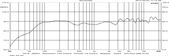

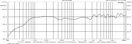

sismik11, that is very nicely built speaker
however, that fullrange rolls off pretty much below 100 Hz, and that is not even open baffle masurement, so perhaps lean bass is more than expected
some other fullrange may perform better? betsy?
it could be nice if you would have easily replaceable small front baffle, so you can swap speakers

I think you have a good point about the bass output of the drivers and I would like to try some other ones when the chance comes.
But I have to say that these drivers really sound nice. Much better than expected.

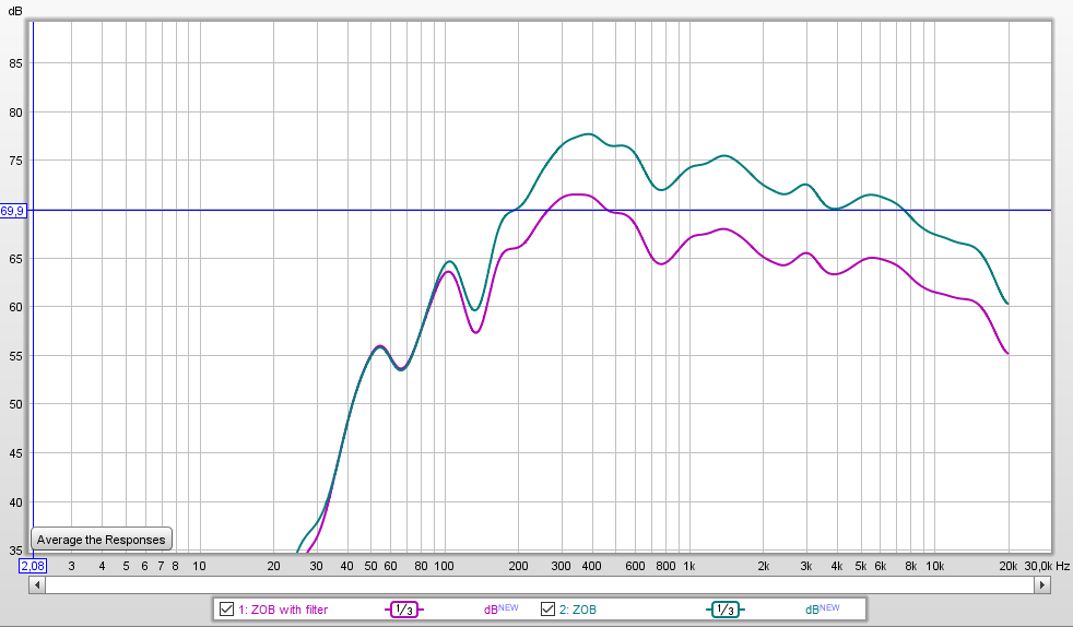

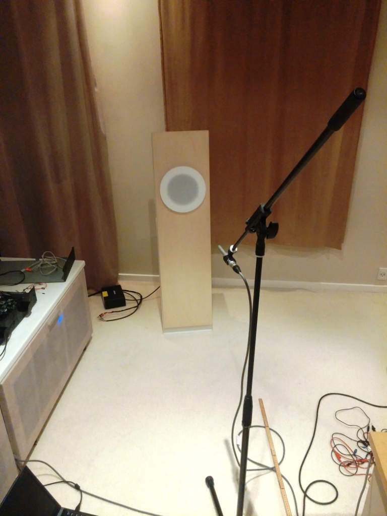

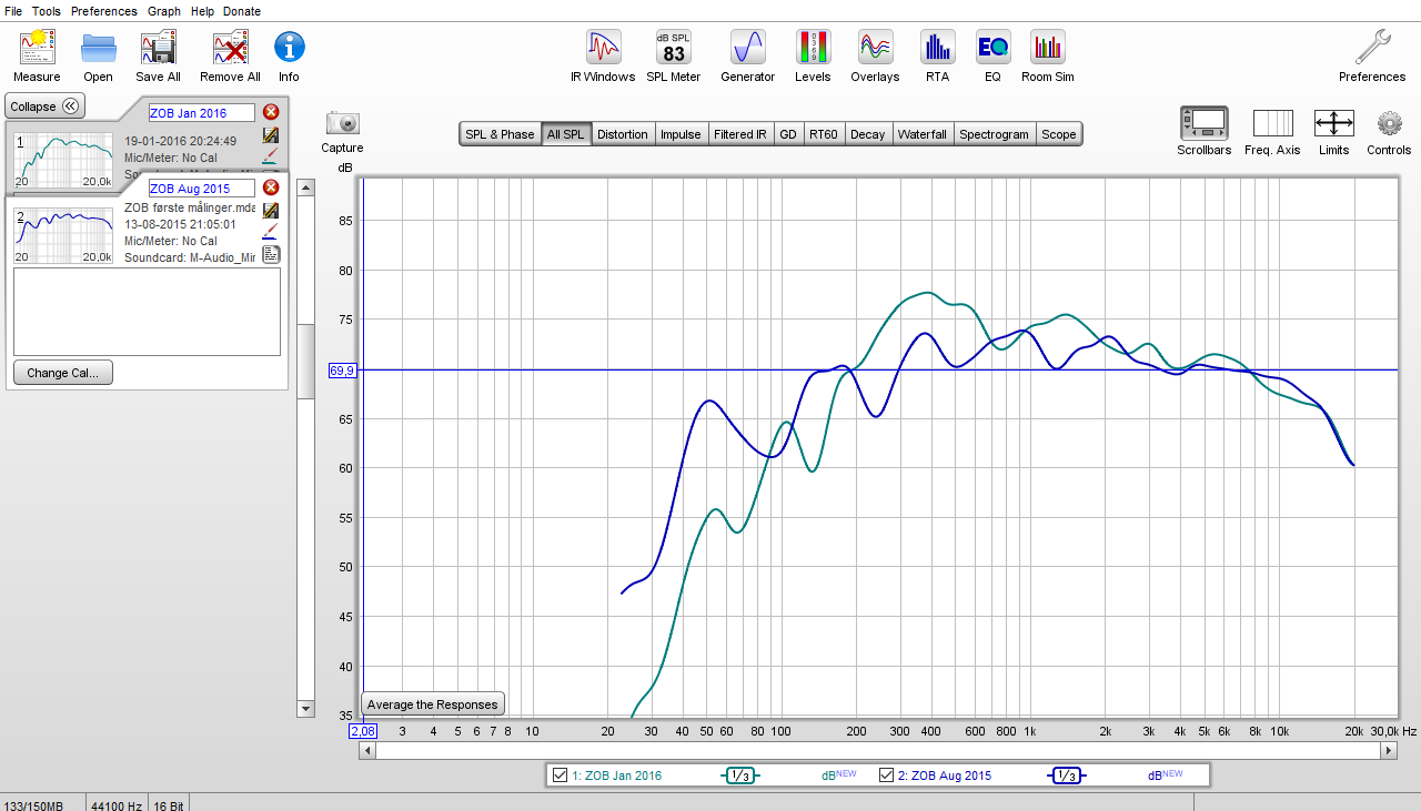

I couldn't find the old measurements I did, so I've done some new once. It is just a quick and dirty measurement. The microphone is 1m from the speaker (on axis). See attached pic. I used REW for the measurements and applied 1/3 smoothing.
As you can see the output drops rapidly under 200 Hz. The Baffle diffraction filter helps a great deal though.
I can see that the bump at 300 Hz I mentioned in my 1st post has disappeared. Interesting.
It is important to emphasizes that the speakers I have build, are NOT using the same drivers as the once Decware use. Therefore these measurements are not representative for Decware's speakers.

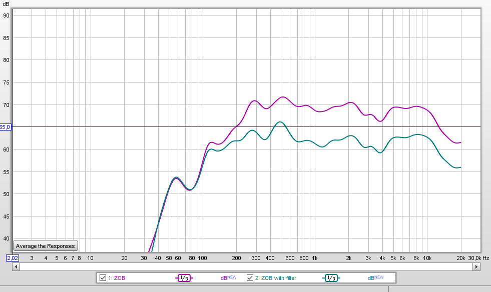

I agree with you. I am a bit puzzled as I don't remember it as being as "bad" as the measurements show.
I have tried to measure again, but this time at my listening position. Still no coupling :scratch:. I'll have to check if there is something wrong in my setup
The 300 Hz bump is back. I guess that it is room related.

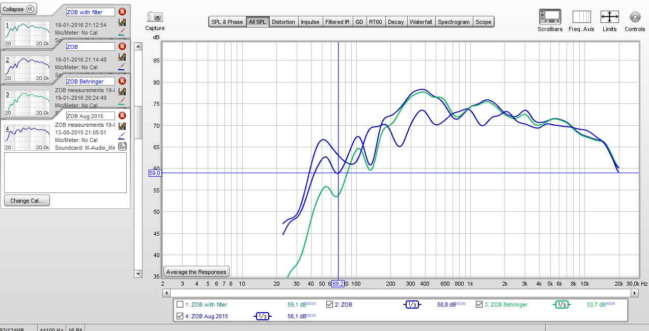

I found my old measurements. They were on a different PC.
I have posted the new and an old measurement together.
As remembered the old measurement was not as bad as I measure now.
I just don't understand why I have lost the coupling.😕

I found the error. It was my Behringer Ultracurve eq. I used for the quick setup. Now I have changed to my regular setup, and now things look and sound as I know it should. I have posted the new graphs.
The 1st graph has the new measurement, the wrong Behringer measurement and the old (Aug 2015) measurement.
The 2nd graph shows the speaker with and without the Baffle Diffraction filter. Now things look descent.
I'm going to erase the old posts containing the wrong graphs if possible.
