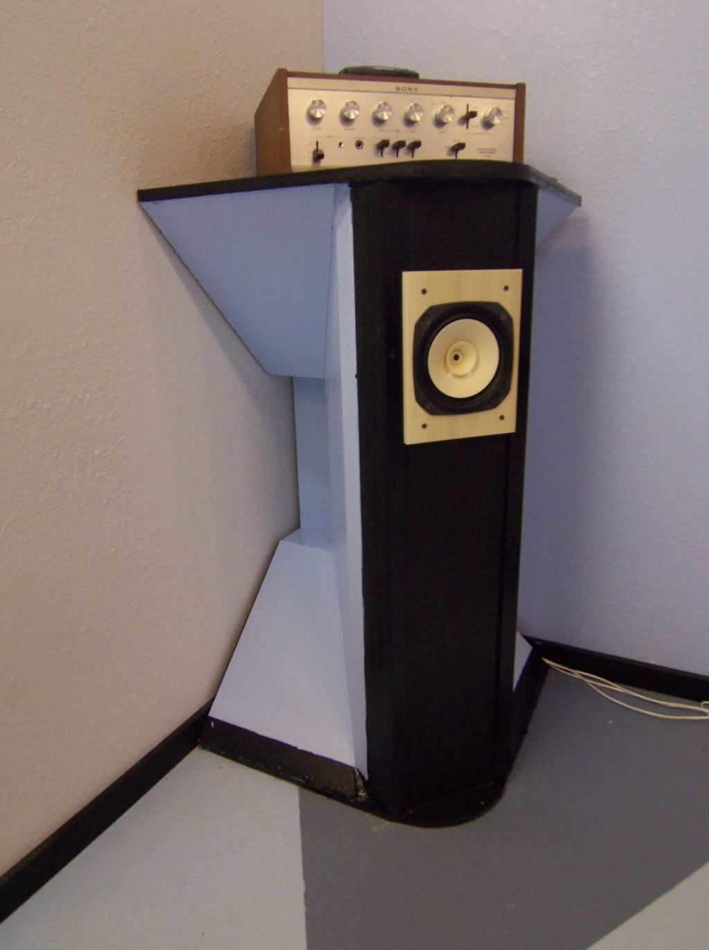

I built these speakers from Steve's template. They are using Fostex FE166En full range drivers.
The cabinets took about two weeks of part time work to complete. There is a number of steep compound angles to cut and everything needs to be fairly accurate to fit correctly. They were not hard to built, but they were very time consuming. About one half of the construction time was waiting of glue and paint to cure on internal parts.
My first thought on initial power-up was, "My, there certainly is a lot of music coming out of these little 6 inch speakers."

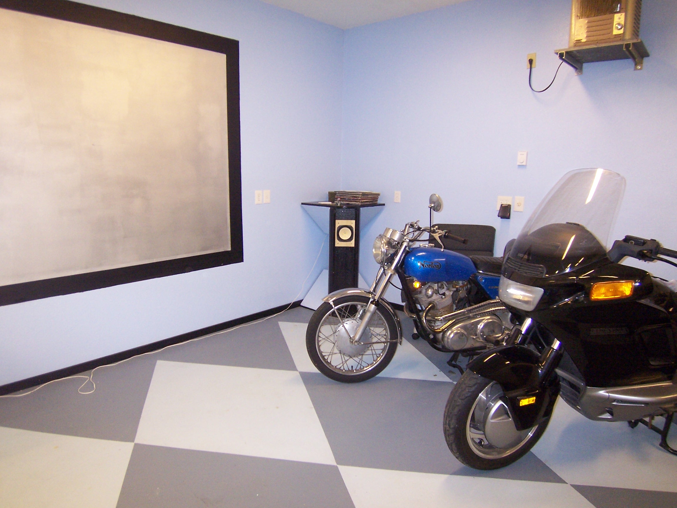

Also, these speakers are in my 500 sq. ft. motorcycle garage and the only acoustic treatment is moving the Norton a few feet one way or the other.

My audioholic friends, both young an old, are amazed with the bass that is coming out of a 6 inch speaker. It is more than the equal of the ported 15 inch and sealed 12 inch woofers that we ABC test compared. The bass is of the hi-fidelity type and not the booming sub-woofer type. If you need earthquakes and explosions for your home theater, you will still need subs.
Low frequency instruments such as bass fiddles, bass guitars, kettle drums and horns sound very acoustical and have a resonance that is incredibly realistic.
These speakers are very accurate and very efficient.
One watt is nightclub loud and 10 watts is rock concert pounding loud.
A drawback, perhaps, is that the corner locations combined with the deep base produces some very noticeable standing waves. With the tone generator set at 85hz, there is a 12 db difference between peak and void as the sound meter is moved around the room. The couch is now sitting in a peak, the bass is ever so good.
With 20 feet between speakers, the sound stage is enormous...
if you are sitting in a sweet spot. 10 feet back and centered is a great spot. 10 more feet back is even better. Move five feet in any direction and you will be in a bass free zone and all the singing will be coming from one speaker. Good seating location is critical.
Plan on rearranging the furniture.

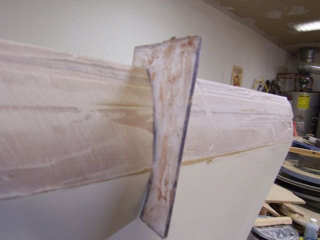

These speakers need a bit of Bondo, caulking and paint to finish nicely. It would be really tough to build them out of cabinet grade walnut with a china closet finish. The entire curved front is constructed out of small vertical strips of stock and belt sanded round. A skim coat of Bondo hides the seams.

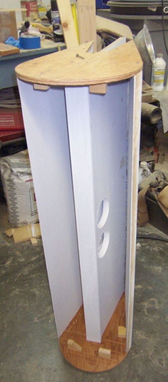

It really helps to make a top and bottom template to hold everything straight and plumb and square. A few degrees of tilt means that every other piece will be a hand fitted trial and error project. And there isn't much room for hands.
Again, these are not all that hard to make. All the fussy pieces are inside the cabinet and errors can usually be covered with a long handled brush full of caulking. They were much more interesting to build than another rectangular box.
The worst part is that there are a bunch of angled rips in sheets of MDF. Each one produces a quart of fine MDF flour that needs to be corralled.

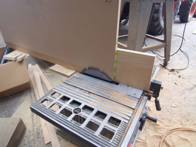

The deepest acute angle on a Dec Horn panel is about 2-1/4 inches. A skill saw should do that. I first plan was to use a skill saw to make the deep cuts, but I dug out my cheapy table saw instead and screwed a vertical board to the fence.
It took about 10 minutes to cut all the deep angles for both speakers. To do similar was a skill saw, build a right angle platform and clamp the vertical panel to it. Use a straightedge across the top to set the blade location and saw away. It will work perfectly.
