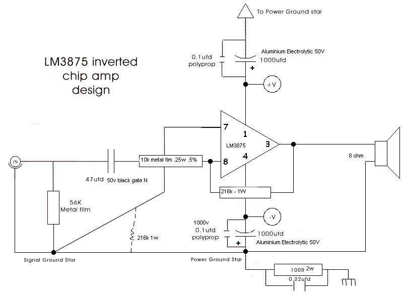

I have settled for building the BASIC ICG circuit from Decibel Dungeon.
I am now at the ordering parts stage
Ordered 6 LM3875 chips which should be here by next Tuesday.
And this is the problem I have right now, makeing sure I get the right parts.
Would someone please look over the circuit diagram and check or suggest components.
I need to be sure of;
which are critical components (which need to be best quality)
Minimum voltage rateing
Minimum wattage rateing
capasitor types (i.e. electrolitic / ceramic), preffered brands?
There is a component I'm not sure of
0.22ufd cap at bottom right, not sure which voltage /type to use
Is there a way to replace the 56k resistor with a suitable potentiometer?

Hi Nordic
I think the cap is this one:
http://www.maplin.co.uk/Module.aspx?ModuleNo=361&TabID=1&source=23&doy=13m9
so its probably rated at 240v- maybe someone else could double-check
The BG cap should be 4.7uf
atb

I saw when going through the GC site they reference it to BX72X... is the X part important, because I see Maplin only show the BX72K one...?
Why do you suggest 4.7ufd in stead of th 47ufd in the original diagram?

Hi Nordic,
I think they're typo's (mistakes) in his spreadsheet he lists the BG as a 4.7 and i think he's put X instead of K
http://myweb.tiscali.co.uk/nuukspot/decdun/gainclonesl.html
HTH
evo
( i would wait for someone else to confirm this though) 😉

On the other hand isn't it supposed to balance each other out?
i.e. the 47ufd cap + 10k resistor to pin 8 VS 56K resistor between input and ground.

OK found an article on the CyClone
http://www.platenspeler.com/diy/amps/uk_cyclone_1.html
Based on this the 4.7uf value is probably the correct one...
but the R3 = (R1*R2)/(R1+R2) rule trows me a bit, as in stead of the 9.5K the formula would suggest, the IGC uses a 216K load (the line that looks like this - - - - ) would the 9.5k resistor be better suited? 😕

What's that additional line from the input to the star ground (more or less parallel to the input grounding R?
No Zobel?
No separation of signal and power ground?
Mick
No Zobel?
Mick
Hi Mick are you talking about the black line to the RCA socket?
that connects to the negative pole, I suppose I could just do the resitor directly between the two poles as oposed to the the ground star...
Would it make a difirence haveing only 1 ground?
Aren't the seperate grounds connected anyway?

It is common practice to separate signal and power ground and as far as I know it is also recommended by National in one or the other data sheet. Have, for example, a look at the LM4780 data sheet and the reference board described in it. Also, have a look at decibel dungeon concering grounding practice, the separation is discussed there.
I understand the black line now. Yes, you could to the resistor directly between the poles of the RCA socket and that point would be your signal star then. Look at Decdun.....

Back to the power and signal stars... please help me visualise...
How does the seperate stars connect to the mains earth, is it like I have in this picture?
Also read about people using difirent guages of wire for this, what goes where?

As for the other question, I received an answer from Nick Whetstone at DD...
It seems he reverted to removing the resitor from pin 7 and replacing it with plain wire... think I might be on to something with the 9.5k resistor, which is what I will try.
The case is not going to be a metal construction so there will be no chasis grounding....
Yes, the feedback value on that basic circuit is 216K (which I got from 2 432K's in parallel). It's not too critical that value and 20K -27K is fine.
It was suggested that the resistor from pin 7 to ground could be the same
value as the feedback resistor to reduce DC offset to zero. This does work
but I don't think that it sounds as good. After much experimenting, I am
happy to have some DC offset (ie under 100mV) and just have a piece of wire
from pin 7 to ground because that sounds best to my ears.
