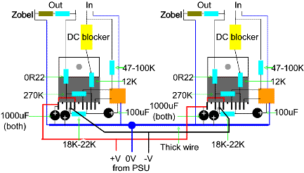

NuuK. I have put together an LM3886 as per your circuit (the only change being OR22, for which I used a 1R WW res as it was all I had.
I don't appear to have any output (yet seem to read -5v DC offset ?)

I believe he is saying his V+ rail is 32.5V and his V- rail is -15V for a total difference of 47.5V. Definitely something odd happening there.

Hello Puffin, i can see no V- connection to pin 4..?The neg side of that 1000uf cap connects to 4 as well, with the pos side to ground..
I wondered about that as well, but if the neg rail isn't connected, he should be getting the full rail voltage on the output!

Audio1st. The neg of the 1000uf is connected to pin 4. There is a resistor between pin 4 & 8 and the neg of the 100uf is connected to pin 8 as well.

Puffin, Is your V- the blue wire with yellow tape.? If so it should connect direct to pin 4.
Desolder from its present location, solder to pin 4 and add a wire from were it was to ground..
Audio1st. O.K I have done (connecting wire to pin 4) that and I now get a power on/off click through the speaker, but no signal in.

Well the PSU needs a bit of sorting out...but I have got it working ! Sounds quite good, looks like shite, but......hey first time.
Now need to tidy it up and make another one for stereo. Thanks for all your help.
