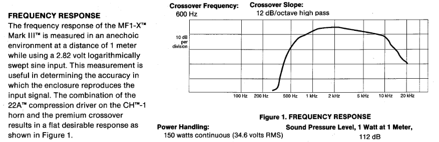

Still, after all of these years, I can't find a single driver that covers 600 to 14k better than an old aluminum Peavey 22A. The titanium version doesn't sound nearly as good (or measure as smooth either) I too find this hard to believe. I do need to keep this a 2 way. One must spend 400 to 1k per driver to find such a driver. Other than above tge 14.5 k I have no issues. I have been able DCX2496 myself all the crossover/eq that I need. Still like to do better high end reasonably. Have I missed a driver lately?

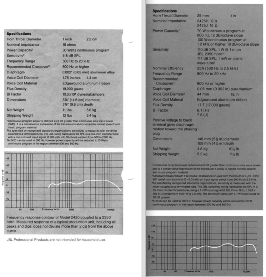

Titanium was adopted over aluminum for longevity (less metal fatigue resulting in broken surrounds) more than for smoothness. Titanium HF limits can be higher than aluminum, but with more response peaks.
An example, the aluminum JBL 2420 vs the titanium 2425:
The smoothing in the graphs hide detail, but the trend is visible.
All my aluminum 2420 diaphragm surrounds failed in PA use, after replacing with 2425 diaphragms, that problem went away. Frequency response difference was nothing compared to worrying when the failure was going to happen 😳 .
Most HF driver advancements have been in voice coil power handling, which is mostly irrelevant around 600Hz where displacement limits the output. Increasing the diaphragm to phase plug distance increases displacement, but imposes an acoustical bandpass which reduces HF output.
There may be some HF drivers using a polyester surround diaphragm with smoother response than your old Peavey 22A, but it may be hard to find a 2" diaphragm one inch exit driver with as good low end that has smoother, more extended HF extension.
At any rate, without comparing driver response on the same horn under the same conditions, it would be hard to verify how much improvement is possible between another driver and yours. After comparing a lot of modern drivers to old drivers, my educated guess is it would not amount to much difference.

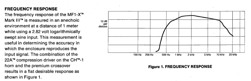

In the 1970s the 22 driver voice coil used round (from memory it looked like 1mm/18AWG) wire, it could handle 500Hz, but response was completely gone by 10Khz.I and peavey used it down to 500 hz with 12 sb xover on big mfx1 horns in the 70s in pa use! Yes once in a while we popped a driver but not often. Home hifi? You will never pop one.
When Peavey started using the flat wound voice coil "22A", tightened up the gap and reduced diaphragm to phase plug distance, the top end improved, but they raised the crossover to 600Hz.
The 22A "flat desirable response" still needed around +10dB at 15kHz to sound "crisp" 😉
