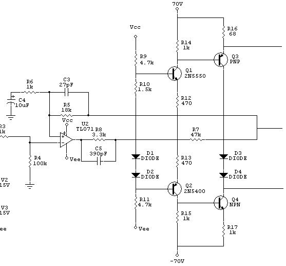

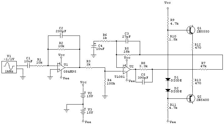

Update:
I'm still working on the input stage. It seems to all be wired correctly and there doesn't seem to be any shorts or bad components. However, I've modeled the exact circuit from the schematic (to the best of my ability, perhaps a component is wrong) and the model doesn't seem to simulate correctly either. No wonder the circuit doesn't work.
I've attached a picture of the input stage. Nothing dramatic here, just two stages of op amps. The input signal is fine up to the input of the second stage. I get a square wave output in simulation on the far side of R7. In the real circuit I get a DC offset of about 1/3rd Vee. I believe about -5V.
Is this diagram incorrect?
Pete
Pete

I'll try that. The original schematic that I was sent (very kindly by Carvin btw) is difficult to exactly what wires create a node and which wires cross each other. I'll play around in simulation for a bit to see if I can get it working, and I'll inspect the pcb to see if its supposed to touch but isn't.
Edit: It simulates correctly with an ideal op amp and gives a gain of about 20 (26dB). However, with a tl081 or tl071 etc it gives a square wave of 2V P-P with ringing. So perhaps the circuit is correct. What I'm basically really confused about is which nodes the connection between R7 and R8/C5 connects to.
Pete

Here's a shot with some extra transistors. I can't remember what that's called (my Sloan book is at my friend's house!).
R7 is the global feedback resistor for the entire amplifier right? (I know thats obvious, but I'm learning...) I want to learn as much as I can about this particular amplifier because I will be designing a quasi-complementary amplifier within the next month (err, starting to design). Ok, so the output of the op amp stage must connect to R10 / D1. You mentioned the junction between D1 and D2 but it doesn't look like it in the diagram (they're much further down than where the lines cross). Although I bet it would work either way.
Pete
