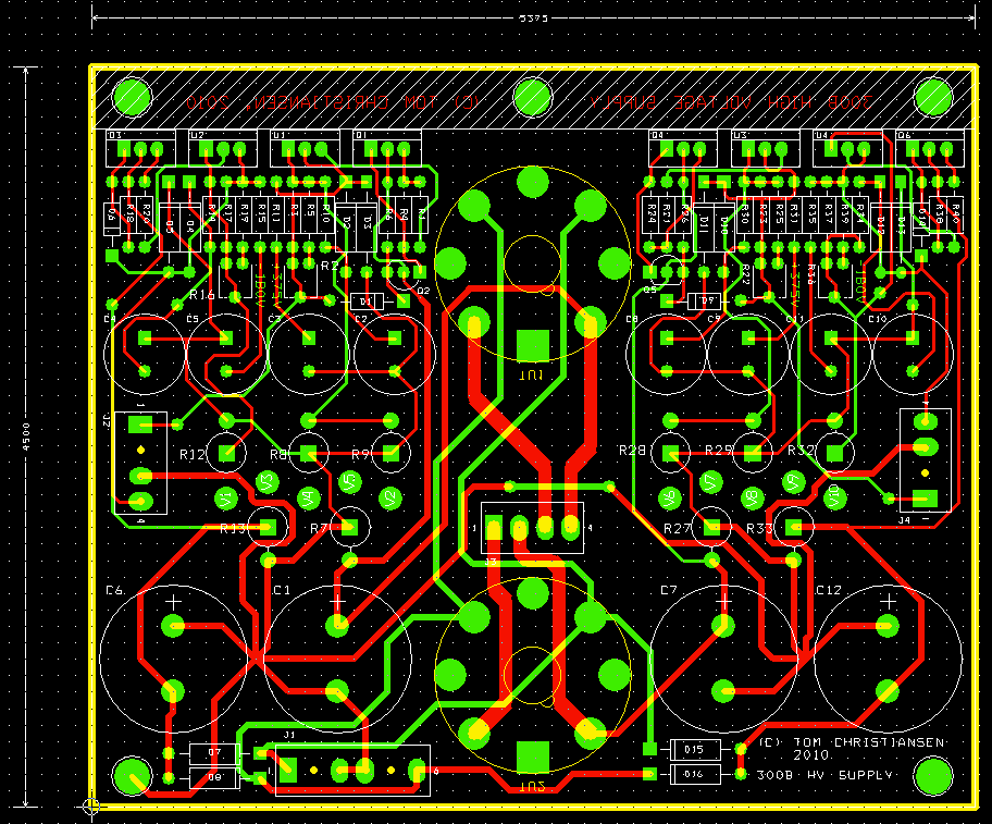

The bias supply is rectified with a pair of 1N4007 diodes. The main B+ supply is rectified by a Sovtek 5AR4. The long warm-up of the 5AR4 ensures that the bias supply has settled long before the B+ is applied. Both the B+ and bias supply are regulated (LM317/337-based). The B+ is set to 380 V; the bias supply to -180 V.
I wanted regulated DC supplies for the filaments to minimize hum and wasn't happy with the amount of power I was looking to burn in the linear filament regulators I had in mind. Hence, I chose to have the filament supplies regulated by a pair of switchmode converters. The switchmode regulators I use are 90~92 % efficient, hence, only waste about a watt...

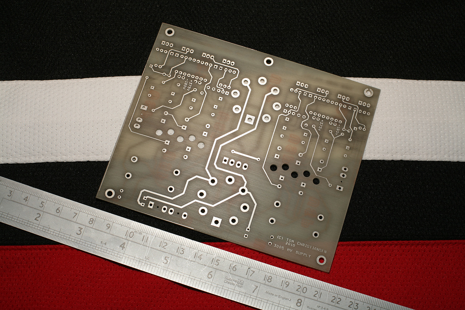

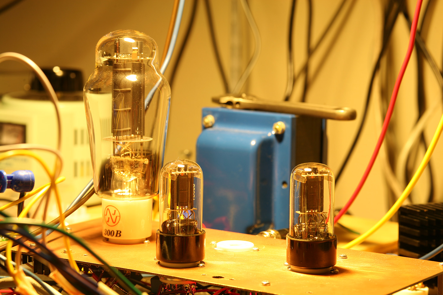

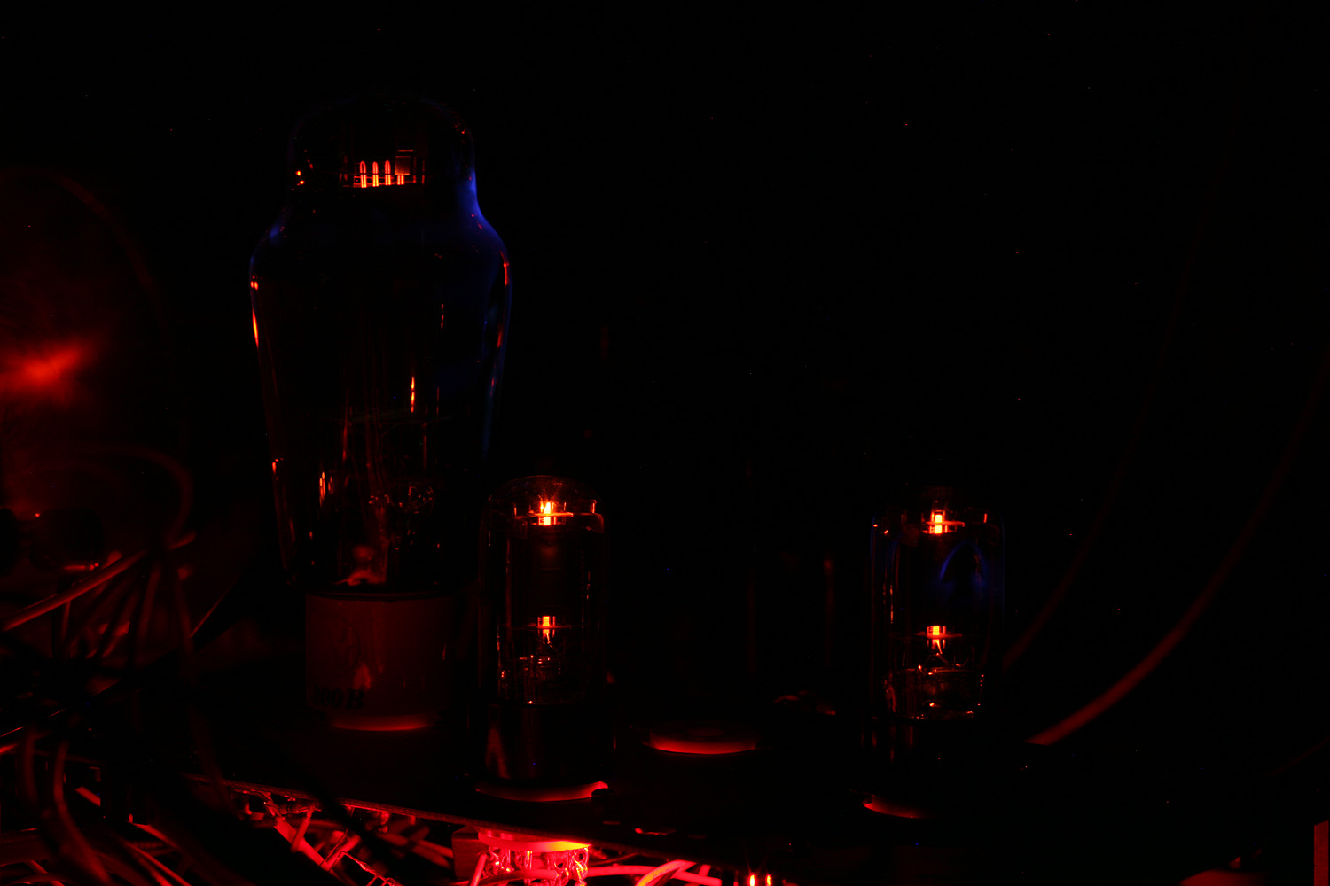

Schematics and some pictures below. The supply PCB was done with toner transfer. I intend to make the amp board the same way.
