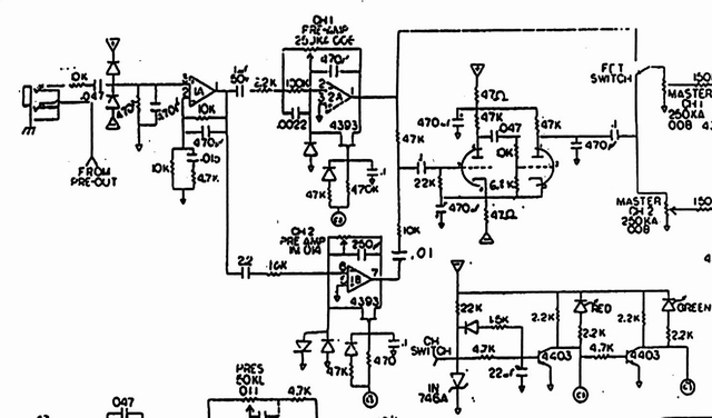

I recently acquired a position repairing amplifiers for a music shop in Massachusetts on a sub-contract basis. I was given a Dean Markley RM-80-DR to troubleshoot a matter of weakened volume on the top channel.
I have looked everywhere for this schematic. I even asked the manufacturer.
Does anyone have it that would be willing to email it to me or better yet post it?
Also, has anyone else experienced this issue? If so, how did you solve it?
Maybe this amp's circuit is the same as another similar model that I could find?
Please help...thanks, Twombstone

The pic attached has been posted on here in relation to a previous query. It's only a fragment, but something to start looking at.

Clean the controls.
Then check the J-FETs that are used for channel switching.
Next likely would be cold solder joints. Be careful, the pads will lift off of this board if too much heat is applied.
If you've downloaded that schematic link that was posted on ME forum, you will see that most parts of the amp are common, including the tube.
